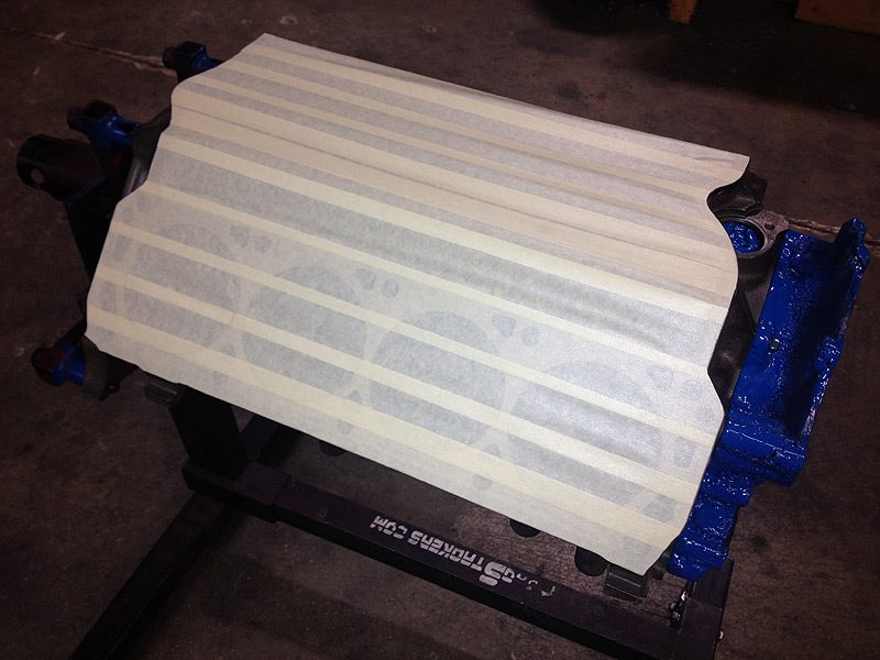

I need some tips on painting the block. I've looked all over YouTube most of the vids are not SBF specific. I just want the block painted (Not the heads). I painted my oil tank black. I'd like to paint the block Ford Blue. I'm just trying to figure out how to best cover all the holes etc...

I use an old timing cover and pan.
Tape?
