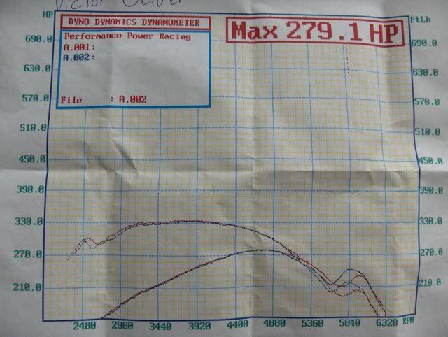

279rwhp
Dyno'd in South FL weather
Rebuilt 40 heads with crane 1.7's and good valvetrain
stock cam
BBK-SSI intake manifold
BBK 70mm TB
stock modded MAF with 19#'s
CAI
BBK LT's into O/R X with Magnaflow race mufflers and dumps
Aluminum flywheel and DS
3.73's
timing at 12

my base is @ 14*..not sure what the tune has in it though
heres my dyno graph..
this was with the stock fuel pump,power steering, and weak valve springs
