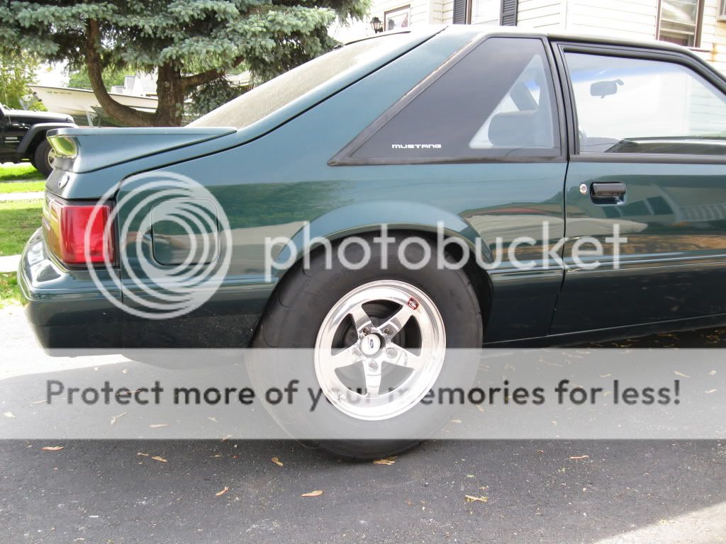

15x9.25 6.5bs with 275/60R15.

Thanks Looks Killer!!!
So a few questions..
what brake setup out back there?
hows the clearance on the inside of the wheel/tire in relation to the inner fender?
any spacers?

No spacers and I have drums in the back. The clearance between the inner fender and tire was close even after I hammered the inner fenders in but they didn't rub. I think I had about 1inch of clearance between the tire and inner fender.

Thanx for the reply,What springs and setup out back.?
if u happen to have any more pics post them up..even some full car shots..nice lookin car.
edit..what pad height here?

the springs are eibach prolines. I don't have anymore pics and I never bought the front wheels so I don't have a pic of the whole car.

Perfect Fit!!!!!
