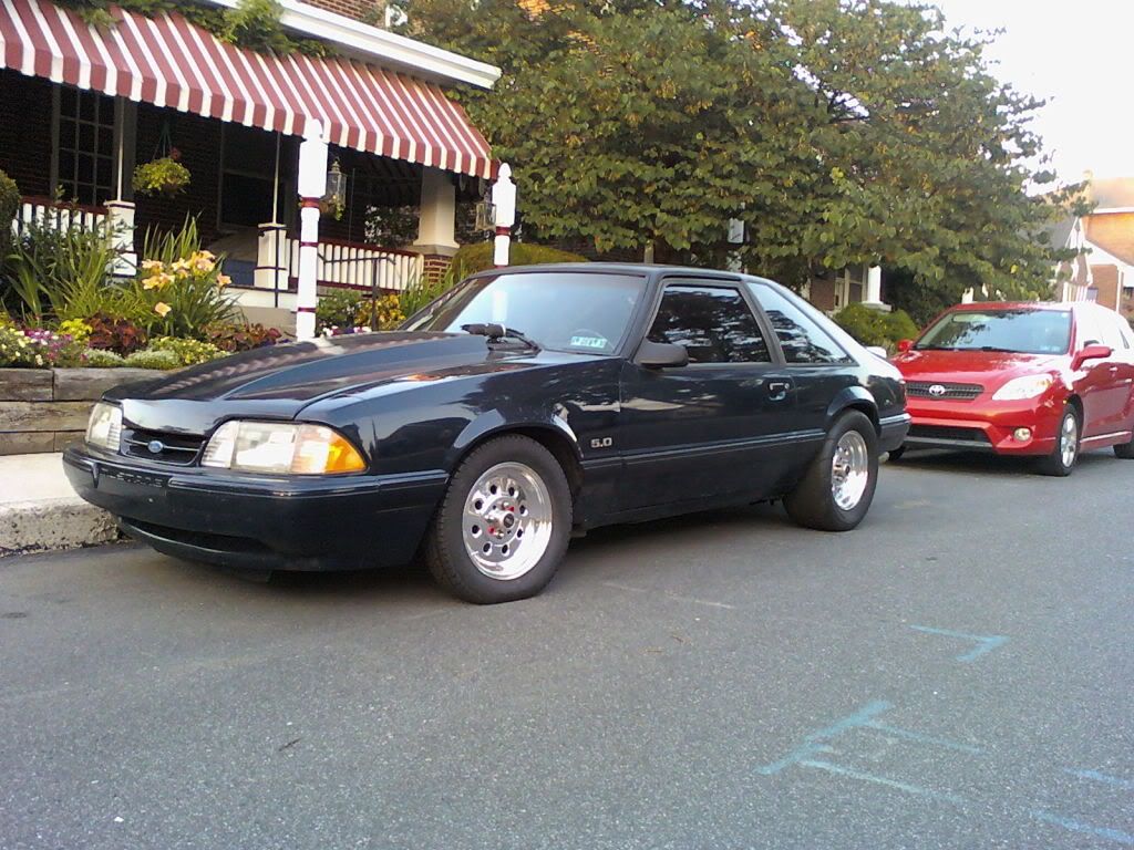

Originally Posted by ISLAND93LX View Post
165/80/15 Nankang(VW tire)
Not to get off topic but what size are those rear tires?? I like how they look on those wheels, Thanks.
Don
15x9.25 with 6" BS on a 295/50/15
