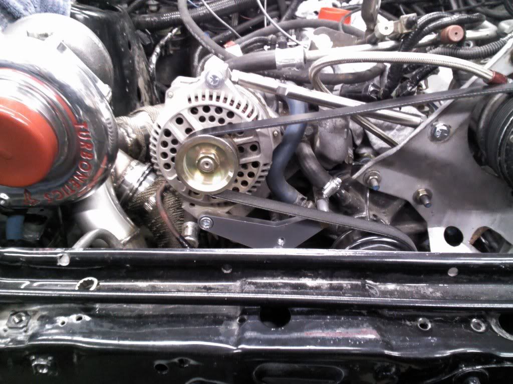

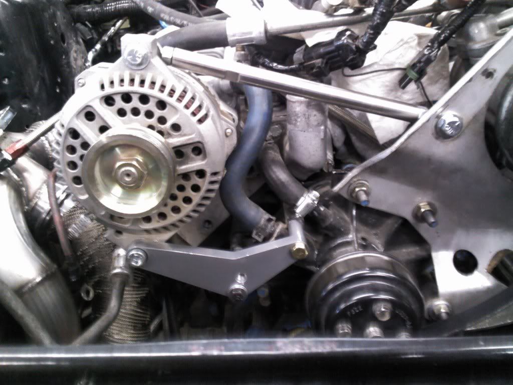

What alt braket are you guys using to move the alt in to clear a pass side turbo. Looks like 1" would do. I am also keeping ac and ps with the factory braket. this is on a 302 based in a 89 Mustang.
What do you use for a tensioner? Or does that rod from the AC Bracket adjust in and out? I am installing a 76mm passenger side and have the 130 amp with clearance problems also. To be clear, thats the March 1465? I too am keeping PS and AC with no smog pump.
does anyone know of a setup like these,that will work on a sn95? or is it a matter of cutting down the spacers to get the alt pulley to line up with the other accessories?
just thought i would ask,since on this subject,thanks
