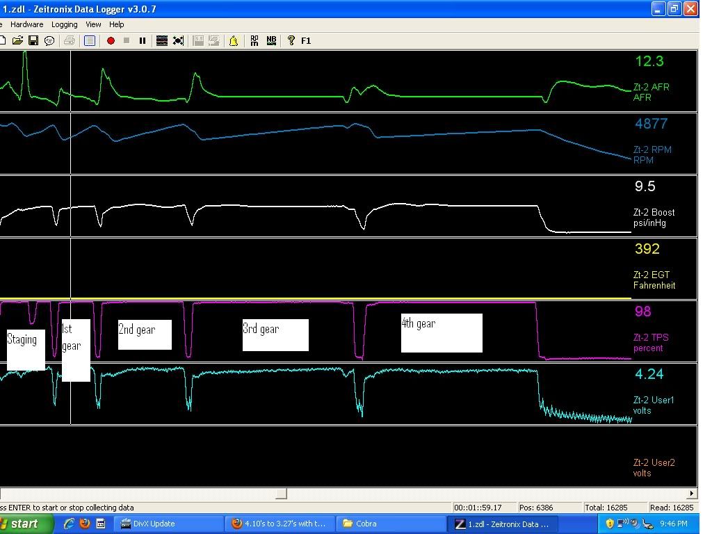

This is a datalog on my stockblock 96 Cobra, T-45, 28"' slicks and 4.10's. 2-step wasn't working, and in fact, the notes I added are off a little, the "staging" and "1st gear" are actually both just 1st gear, I was spinning so I got out of it enough to hook back up. Looks like to me that I am seeing pretty much full boost almost immediately.
My point is, if I am seeing full boost and not running out of gear at the 1320' stripe, how would another gear be beneficial?

It wont.
Going to a taller gear in your case will only slow you down. if you have no problems having boost off the line your golden as long as you have enough gear which you said you do.
The higher gear swap can help on the street, since you can rarely get a real "launch" on the street. So you have to roll into the throttle at lower revs and you notice any lag you may have.
On my own car i run a 3.27 gear, i run a stock block and i dont plan on pushing my combo too fast, after running the 3.27s for a while i wouldnt mind going to a 3.55 or possibly even a 3.73, since i plan on a auto swap and 1st gear is usually taller than a manual trans.
Like i said, a 3.27 on my car is good for around 150mph, i wont be anywhere near close to running than in the quarter with my setup. and i definatly wont be going that fast on the street especially with skinny weld wheels up front with 90/10s. so i'd have a range of speed i wont hardly use so i can benefit from gearing it down without many ill affects.

Any updates? Combo is in sig. I am really considering making the swap to 3.27 or 3.31.
It would help if you guys that do the actual swap specify if you're running an auto or 5 speed.
I am running a Dynamic C4/converter. Unfortunately the only pass i made with my current setup blew both head gaskets a bit before the 1/8 mile traps. I "coasted to a 7.2 @ 104 / 11.8 @ 90. 60' was an easy launch 2.0.
Now waiting on bigger inj's and possibly gear swap.
3.31 or 3.27 are so close that I dont think you will notice a difference. But you do need to make the switch with running that C4.
Does your C4 have a trans brake? If so, then use that with a 2 step to build some boost off the line and youll be golden.
