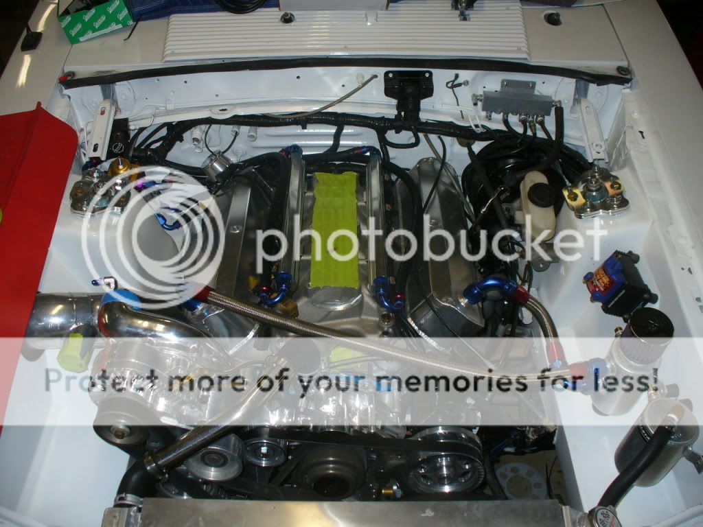

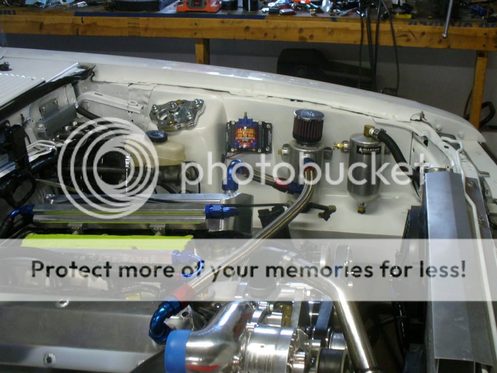

Catch can is the best way. One -12 AN bung on each VC to the can...

Originally Posted by blwn89hatch View Post
What catch can is that? Thats the exact setup i want to go to.
It's a Moroso catch can. Part # 85465. It has one -12AN inlet.
I bought an extra -12 male bung from Summit when I ordered it and welded it onto the tank. There aren't any tanks out there that come with two -12AN bungs.

Unscrew one of the fittings from the VC, stick a funnel in the bung hole (lol) and pour it in. Takes no longer than normal to fill.

ok so heres my question now, im going to be doing a similar set-up as FiveLiterFox did on his ride. I currently have a breather on my driverside VC and a pcv valve in my passenger side VC thats tied into a oil seperator, Being that i have 2 holes in my valve covers i would need to get a new set or find a way to plug those two holes correct?
Heres a crappy pic
blwn89hatch is offline

I have the oil sperator tied intot he pcv valve which sits in the passenger side vc behind the elbow. The seperator is behind the passenger strut tower hidden lol.

If your doing the system like FiveLiterFox then I would recommend using bulkhead fittings in your valve covers so you don't have to get new ones and then just attach your an fittings to them. Welding is kinda out as it will ruin the finish for sure. Just make sure to use some loctite on the nut for the bulkhead fitting and all will be good.
I don't think I would trust loctite alone. Strike the threads once the nut is on to lock it or even better tack weld the nut or drill a hole through the nut and bulk head to cotter pin it so it cannot rotate. Too much risk if that nut comes loose.
