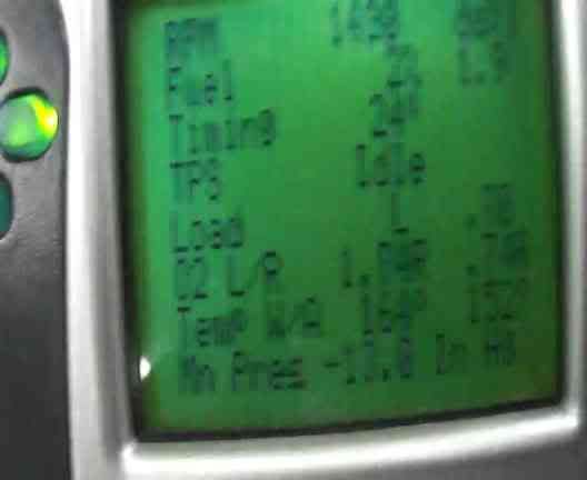

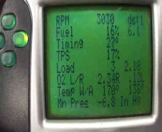

My 80's were definitely that high (click pic to start video and watch fuel %):
