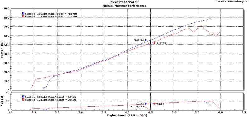

Here is my 786rwhp (MAC Mufflers) run vs a couple of Magnaflow mufflers. Notice the huge HP difference (area underneath the curve and our new peak of 5300rpms).
Magnaflow run numbers: Runs 121 and 122 on 9/14/2011
MAC Flowpaths: Run 109 on 7/14/2011
MAC Flowpaths: Run 128 on 9/17/2011

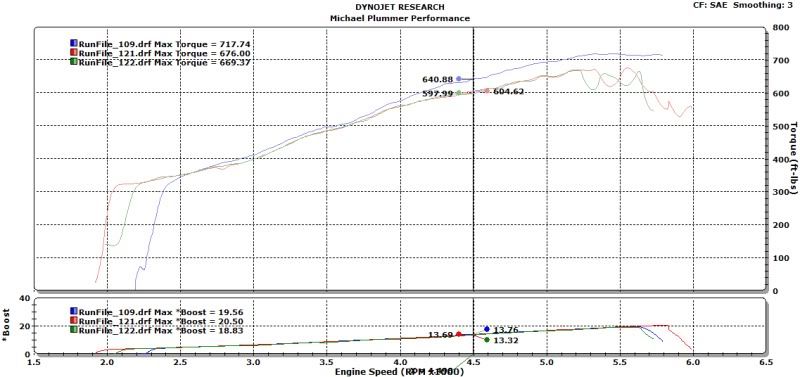

Here is a RWTQ curve: Notice the huge differences in RWTQ
Now I spent all day at the dyno on 9/14/2011 trying my best to retune for the Magnaflow mufflers but they were down on power, its just that simple. Now on 9/16/2011, I had my old MAC Flowpths re-installed and headed back to the dyno the following day. See results below:
Important facts from my testing:
1) When I first installed the 3" exhaust system it commanded alot more fuel than the 2.5" setup because it was moving alot more air.
2) Switching to the 3" Magnaflow mufflers we were to rich and had to remove alot of fuel. Meaning it wasn't moving as much air and the decrease it RWHP and RWTQ show that.
3) Switching back to the MAC Flowpath mufflers commanded alot more fuel. Meaning it was moving alot more air vs thge Magnaflow and the increase in RWHP and RWTQ show that.
4) MAC Flowpath is NOT chambered muffler like Flowmaster. MAC Jr. said the Flowpaths are designed around flow and they outflow all the street muffler competition except for Borla XR-1. Granted Jr said not by that much.
5) Why the HP & TQ loss. MAC said those so called straight thru design mufflers like Magnaflow, Ultraflow, Race Magnum that have a huge body or cavity, causes a vortex. A vortex (plural: vortices) is a spinning, often turbulent, flow of fluid or air, inside the muffler and this causes a restricition. MAC also stated that the smaller the cavity or body the less vortex will be created hence a bullet style muffler isn't affected as much.

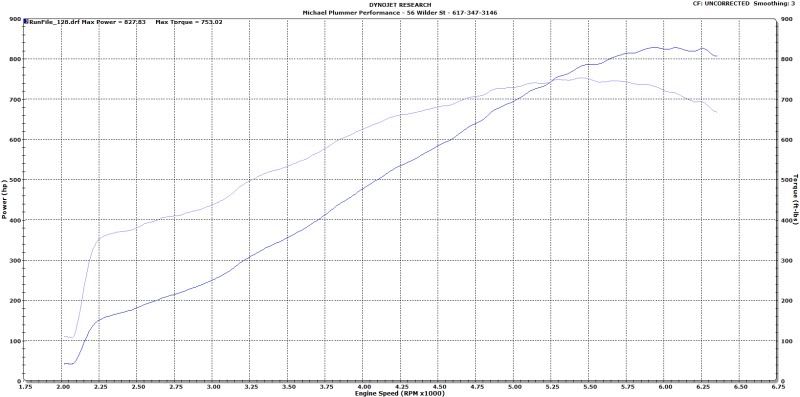

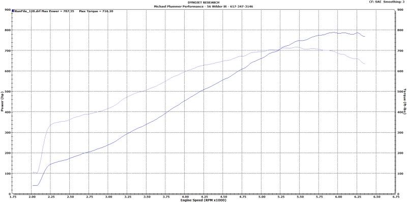

For all you guys that use SAE, STD or Uncorrected here are the dyno graphs.
SAE: This is the correction factor I use
787.35rwhp, 716.20rwtq SAE
STD: A correction factor used by many but not by Dynojet
812.12rwhp, 738.73rwtq STD
Uncorrected: A correction factor used for that day at that time
827.83rwhp, 753.02rwtq Uncorrected

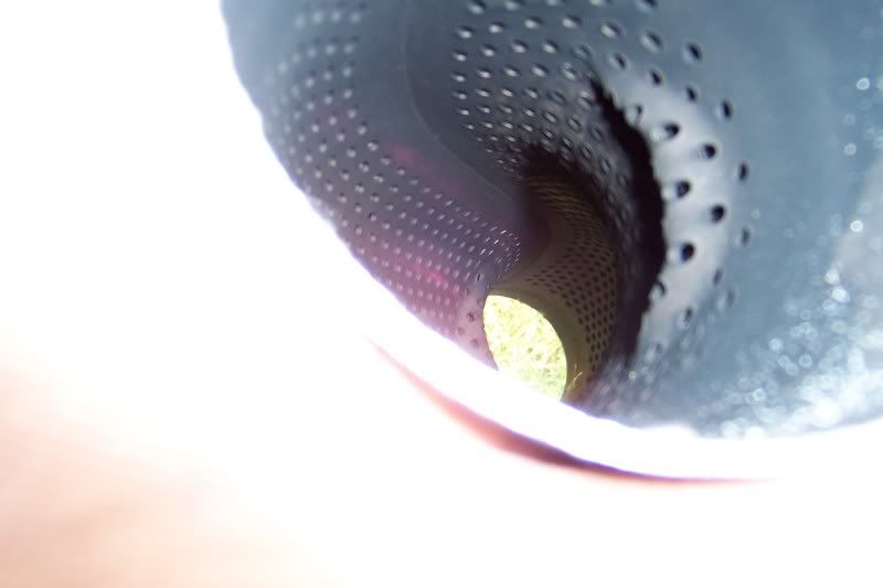

After speaking with you early on in your testing I went ahead and picked up some 3" Mac Flowpaths. While they don't look as pretty they clearly do the job. Although Mac does offer them in SS as well.
Sneak peak inside both once again:
I bet if you put these two mufflers in front of 100 gearheads and asked which one flows better, all 100 would say the Magnaflows(I know I would).
Goes to show good engineering outsmarts what seems obvious and logical to the casual observer...but it took some fair, unbiased testing to conclude just the opposite. Thanks again Michael!!

Q) Do you think the prochamber had anything to do with the results?
A) Which results? The 3" ProChamber was used with both mufflers with no other changes. The MAC mufflers made more power and torque over the Magnaflow mufflers.
We made 13 runs, trying different things to get the Magnaflow mufflers to make more HP but the runs I posted were the best of the bunch. With those mufflers on (Magnaflow) they wanted alot less fuel. Basically means, its not moving as much air.
I'm just curious because the Pro-Chamber was designed to be ran with the MAC mufflers...have you used a different mid pipe and tried the test between two different mufflers?
I would be really interested to see the results.
If I can get to the dyno before the snow flys I could do the test on my car as I have a dr.gas xpipe on my car.

Q) I'm just curious because the Pro-Chamber was designed to be ran with the MAC mufflers...have you used a different mid pipe and tried the test between two different mufflers?
A) Great question but you must have me confused with a Mustang mag or an exhaust vendor. I don't have the time or money to do that kind of testing, sorry man.
I did a test a long time ago between my H-pipe and a Bassani X-pipe and the H-pipe won. MAC said it would because it was designed to work together and that a exhaust system designed together will work better than one pieced together. So there may be some truth to that but I'm not spending anymore money testing mufflers or mid-pipes.
After seeing MAC products consistently at the top or near the top of header, midpipe and muffler shootouts. There is one thing MAC does well and thats make power.

I wasn't expecting you to go out and buy a different mid pipe. I was just curious if you had any prior testing with the different mid pipe.
I would actually like to see what a clean test without misfires did compared to the MAC's.
I know the MAC's required more fuel so therefor, there was more air moving through them, but it would still be interesting to see how much power was separating the two different mufflers.

Q) I wasn't expecting you to go out and buy a different mid pipe. I was just curious if you had any prior testing with the different mid pipe.
A) Sorry, I didn't mean it to sound that way in the other thread but you do have a valid arguement. But I'm not sure you're going to see that test unless you do it yourself. I'd like to see it too.
Q) I would actually like to see what a clean test without misfires did compared to the MAC's.
A) Honestly, upto 5300rpms the curve was smooth and the car ran fine. I don't think the Magnaflows were going to make up any ground on the MAC mufflers. Looking at the graph, the higher the rpm's the bigger the difference in HP and TQ between the mufflers.
Q) I know the MAC's required more fuel so therefor, there was more air moving through them, but it would still be interesting to see how much power was separating the two different mufflers.
A) Agreed but for me, I saw enough from my crude testing, to switch back to the MAC's.
You bring up some valid points but I'm not sure you'll find the answers you're looking for.

One thing I think Michael failed to mention was that he spoke with all the major exhaust players about his car searching for their recommendations. Based on their responses he widdled it down to the two. He then willingly spent close to $275 to purchase/ship/install/tune a set of mufflers that he wasn't going to use, then posted the results which could possibly hurt his chances of selling them. Not many people are going to do this on their own dime, so good luck there.
He initially installed the Maggies and snuck in to see Dez for a quick pull and saw a 40+hp drop and a/f go rich. Then later went back when more time allowed to tweak the tune in hopes of finding the lost power. That's when the miss at 5,300-5,400rpm was occuring. The pull was clean until then so comparing the graphs is valid up until that point. 31hp @ 4,500 and 48hp @ 5,400...do you think the gap was going to decrease after that?? The torque curves have an even larger gap! The Mac rep told Michael with confidence "our mufflers will out flow every muffler out there, except the XR1's...but not by much!". Which tells you THEY tested them as well.
A magazine will do their own comparisons and people will throw money at the winner based on the results without asking for 3 other mags to do the same test. Yet people have called foul for years over biased test results that cater to their paying sponsors. Michael is a reputable vendor of this site and a respected member of the mustang community. He has nothing to gain personally or professionally from posting the results. In fact he takes a risk at pissing of a manufacturer and tons of skepticism. That's why I said "thank you", in the thread and on the phone!
I spoke to my tuner about it today and he said he's not surprised. For example, he has found chambered mufflers(ie, Flowmaster) just don't make the power on modular motors, but when the owner switches to Mac the car comes alive. His words, not mine.
You're entitled to your opinion which is cool, but while you're waiting for more data me and others will reap the benefits of Michael's findings...at a mininum we'll be no worse off!
