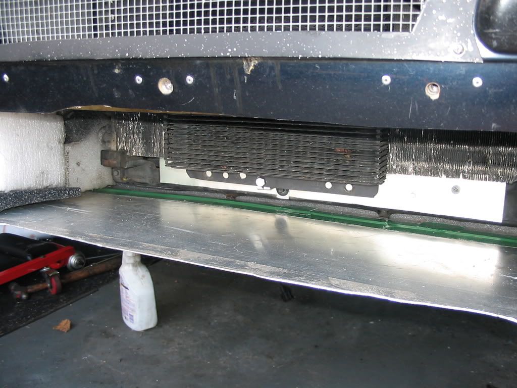

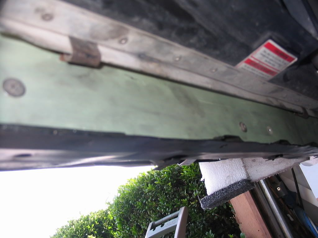

Drudris i was going to attach a bottom /belly pan to my front end too how did you attach yours to the fibersglass and the car? Thanks Jay
http://jaysch302.hollosite.com/splitter.jpg
http://jaysch302.hollosite.com/splitter2.jpg

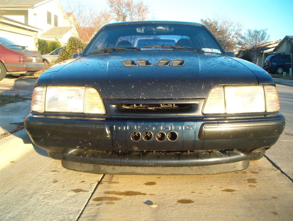

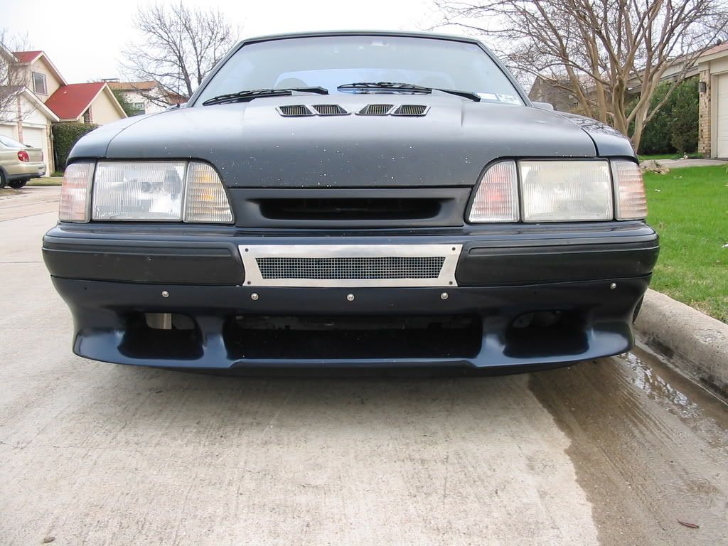

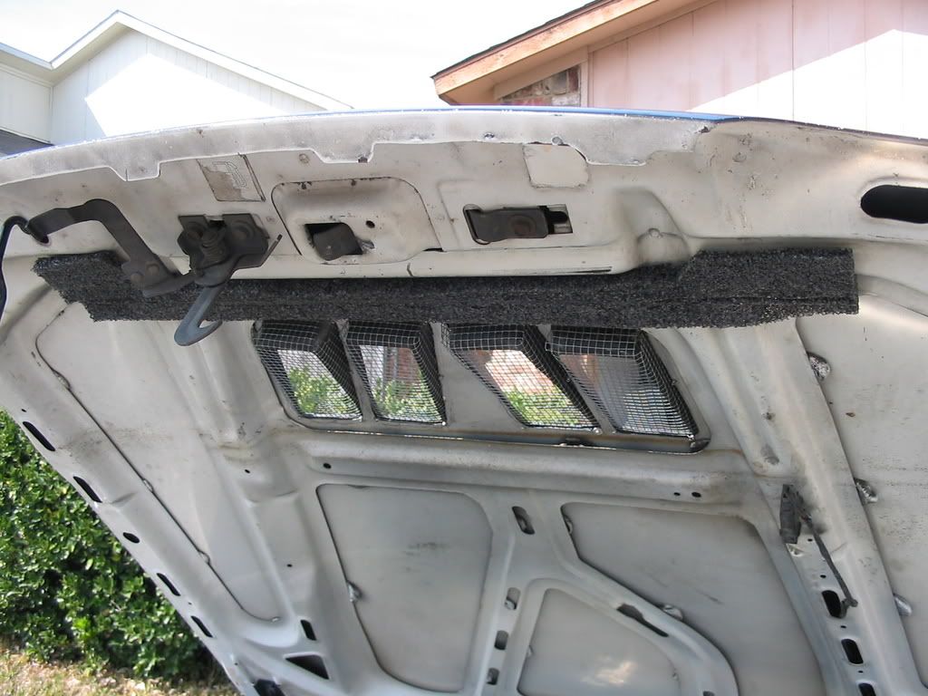

I made some changes to my LX. With hood vents, ranger air dam, cobra insert, boxed radiator and holes in the bumper I was seeing 220-230 deg water and 290 oil temps at the end of a 20 min session in the summer (I still have functioning A/C). I have added a Saleen air dam and opened up the hole in the bumper. I will see what happenes at the end of the month when I go to TWS.
Old set up.
New set up.

Sorry for the late reply. I am now running an AL rad I bought from Blue Oval. My Ron Davis started to leak again. When I pulled the RD rad out and tapped it flat on the ground a HUGE pile of rubber came out. Looking at it from the front it did not look bad but there was a lot hidden. Replacing it fixed a lot of my running hot issues.
Originally Posted by loudnslow98gt View Post
where did u get those hood scoops?
They are '67 mustang side vents.

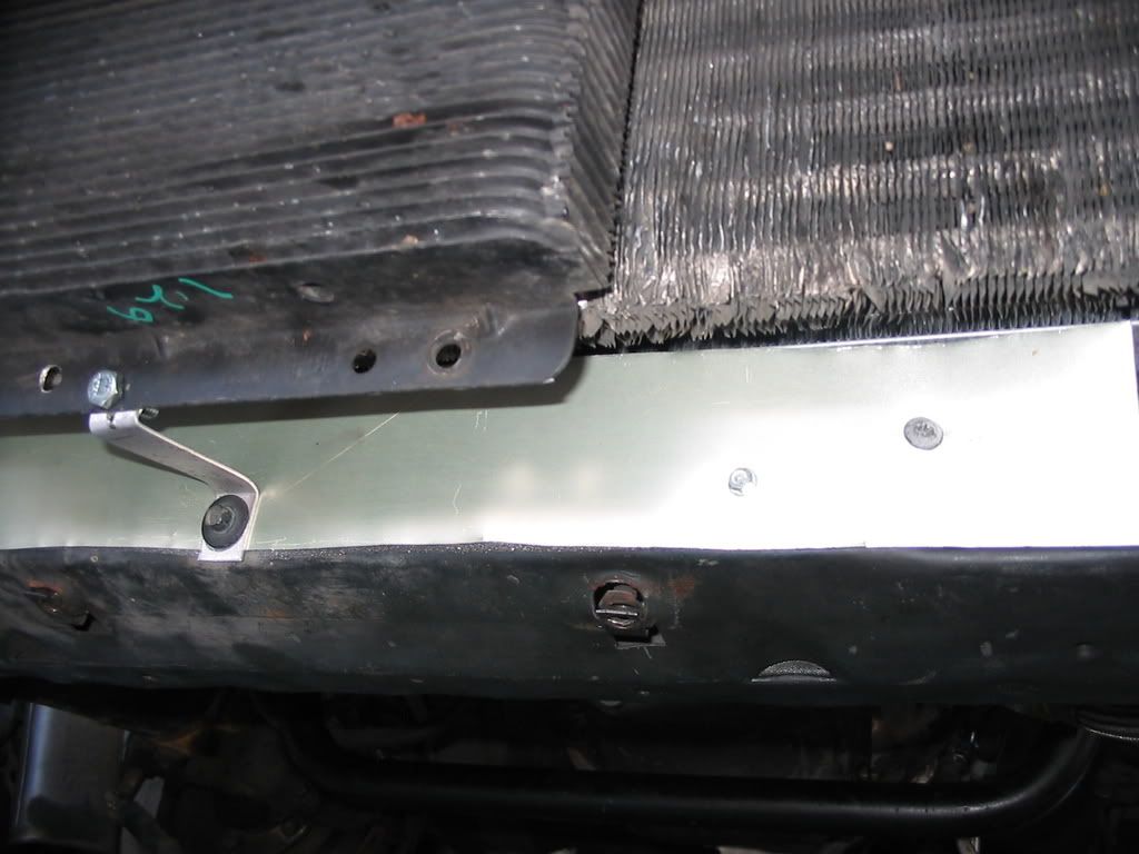

I also boxed in the area around the radiator. I sealed from the lower rad support to the lower air dam
And sealed the holes in the lower rad support.
And used foam to seal the area leading to the inner fenders.
The water and oil temp dropped both dropped about 30 F. One more thing, I replaces my original 87-93 a/c condenser with a thinner one from a 83-86. They are about 1/2 inch thinner.

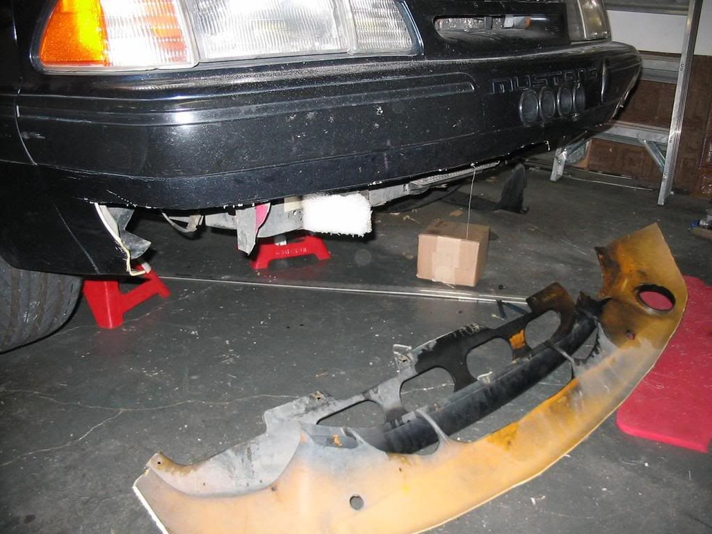

Well, I got bored and goofed off in the garage for a bit today. I recently bought a 2001 Explorer 4x4 XLS and kinda got bit by the off road/trail toy but. I've lifted it a little bit and noticed I had the air dam laying in the corner of the garage.
Long story short, some trial fitting, some cut off wheel action and some screws....
I wanted something still streetable that wouldn't be a speed bump sweeper, and I think this'll work. If not, it occupied some time in the garage using some tools. Kept me busy for a few.

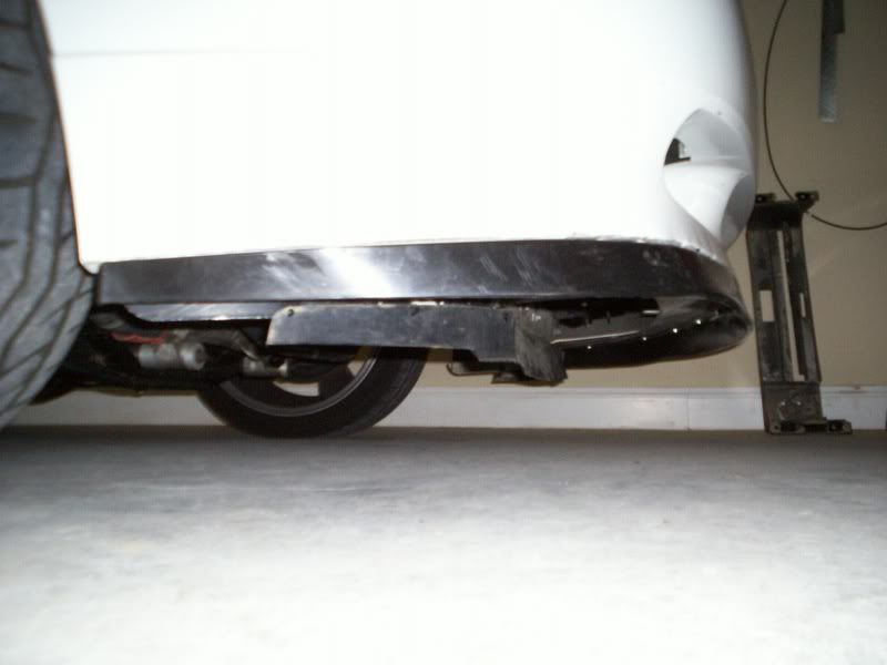

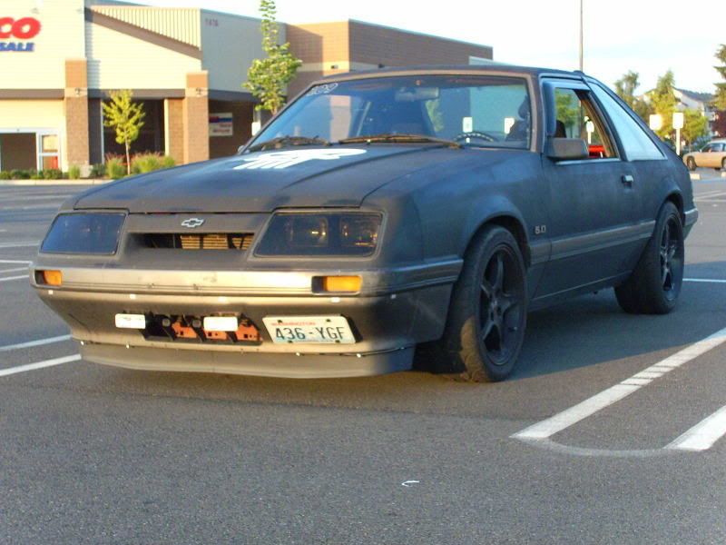

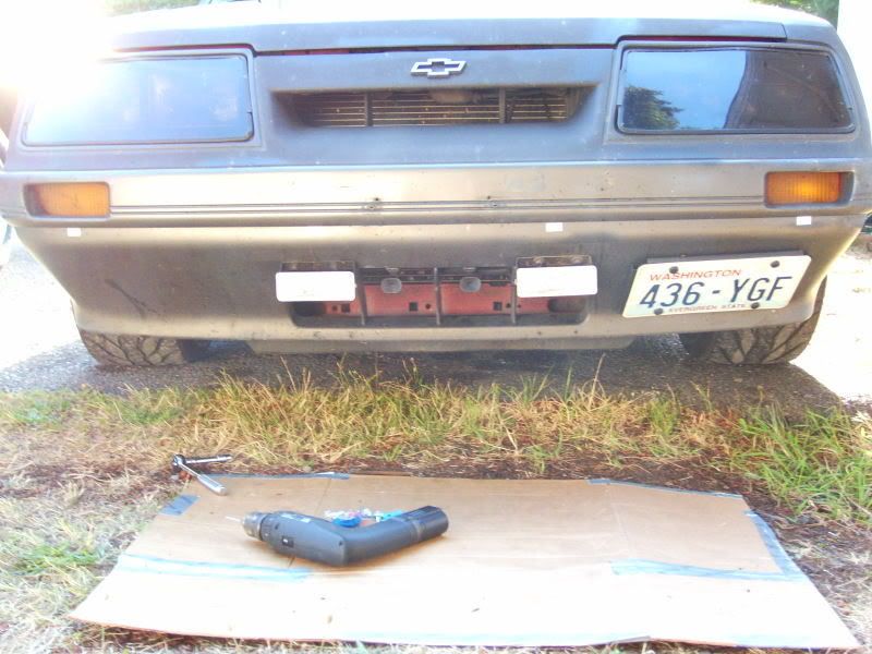

I'll add a few pics to this post if someone is looking to do this. I guess you dont have to use big silver bolts & fat washers like I did, but I like that kinda industrial / mechanical / function-before-form look.
Yes that is a Bowtie. And yes I have replaced it since the pics were taken.
Originally Posted by Nitrous SSC View Post
Did this mod. Helped out a TON!!!!!
Funny you say that.
I never realized just how much difference the airdam made on my '86 Fox until I took it off for a day to get my toe-in reset after replacing the tierod ends.

Thx man. It just kinda turned out that way by accident. After I made my own vortex generators and used pop rivets to attach the window sills from a '91 Stang, the car started to take a function-over-form appearance. I got tired of buffing out the paint that did not have a clear coat. So I rattle-canned the whole car with a black spackle textured paint. So it feels like the top of an old black BBQ. The paint will peel the skin right off your knuckles if u brush up against it too hard.
It looks even more sinister when I'm creeping through parking lots.
