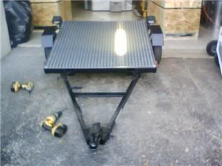

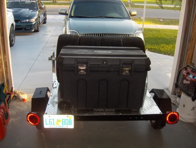

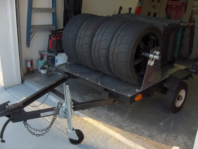

Mine was an 8'X4' from Harbor Freight. It was too big for what I wanted to do so I cut it in half and relocated the axle and now it's a 4'X4'. Painted it black and added a sheet of diamond plate. Then I made my own tire rack using thick pieces of diamond plate for the sides and added a storage box from Home Depot. Works very well. I've used it many times. I've takin it as far as Daytona which is 4 hours away from me.
On a side note: About a year after I built it I found out Harbor Freight sells 4'X4' ones. Didn't matter really since I bought mine used for real cheap. Cheaper then buying the new 4'X4' anyways.
