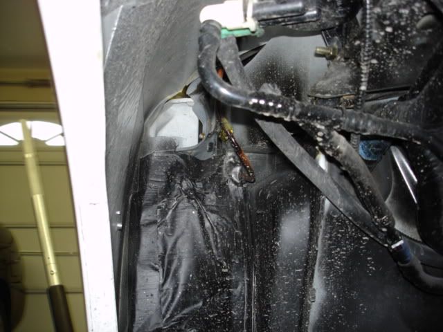

Well, I took the 15$ plunge for a big ol' roll of this stuff. I'm no expert, but this stuff is pretty darn sticky/tacky. I cleaned the underside of the fender with some purple power and dried it up real good then started slappin' pieces of that stuff on there.
It's not heavy at all, which I thought it would be. I used a roller and ran it over the strips and went around the edges really good. I only did the pass. side as that is the only side the liner is out. I'll test it and see how it does.

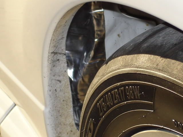

It took most of it's damage early in its life from wide R-compounds and not enough spring. It had been trimmed/cut/massaged and pulled over the years(mostly by the actual tire, not me ).
We had a course a few months ago where my co-driver kept pulling it out somehow on this big 180* turn. I have no clue how...maybe he was cutting it sharper than me or something. I was appx. 3 seconds faster so I know that it wasn't the "right" driving style that was the problem.

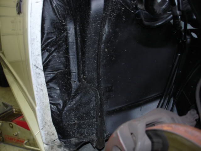

I've painted it all black and plan to do the other side after I get my tires flipped on the rim this week. Seems to be holding up fine to 130+ speeds.

Just to review, this stuff is still holding up. I went ahead and did the drivers side. I used the 'rest of the roll I had to line the roof of my Jeep when I was doing a headliner.

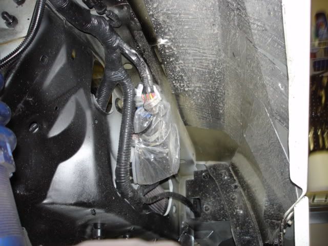

Isn't there some kind of control unit above the drivers side fender liner on our 99-04 cars? I started to pull mine once and saw a control unit looking piece so I shoved the liner back in place.

I can't remember. I do know there is a box with a jackload of wires in the pass. fender. I think it's the CCRM someting'n or other? As you can see by my pic, I just tagged an' bagged it. Seems to be working.

The cruise control unit is under the driver side fender. The CCRM is under the pass fender. Losing the CCRM is bad. It's a relay for all the major components in the car i. e. radiator fan, fuel pump...
