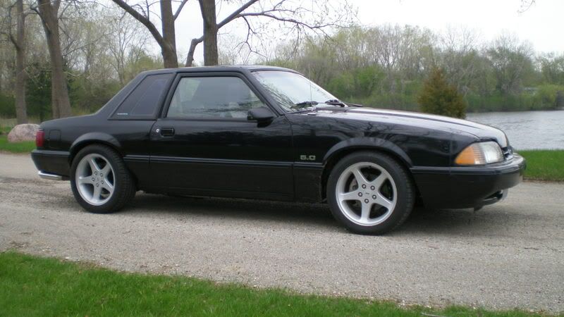

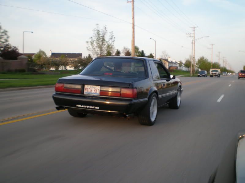

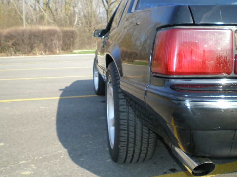

My coupe has the exact set-up you are talking about. I had to roll the fenders inorder to fit 245/45-17 tires in the back. The car is lowered w/ Kenny Brown lowering springs. Below are some pics. Let me know if you need any more info.
-Jim
Older pic, car sits about 1/2" lower in back.
-Jim
Very Nice!

Is this last pic of the coupe on trailer with or without rotors in place?
