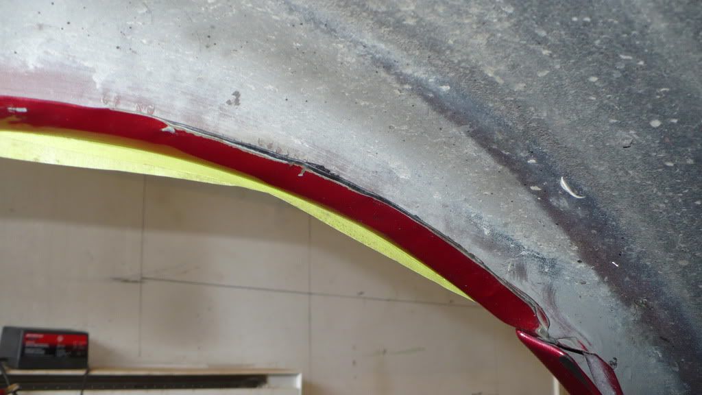

We will need to re-roll the fenders to clear the tires once it's on air (it already rubs occasionally)

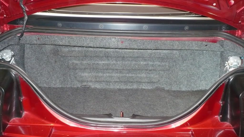

Limited trunk space due to the space the convertible top takes up

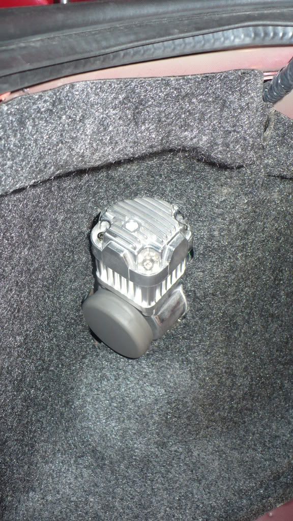

Dual Chromed Viair 400C compressors:

Picking up where we left off, a couple more pics of the dual chromed Viair 400C compressors:

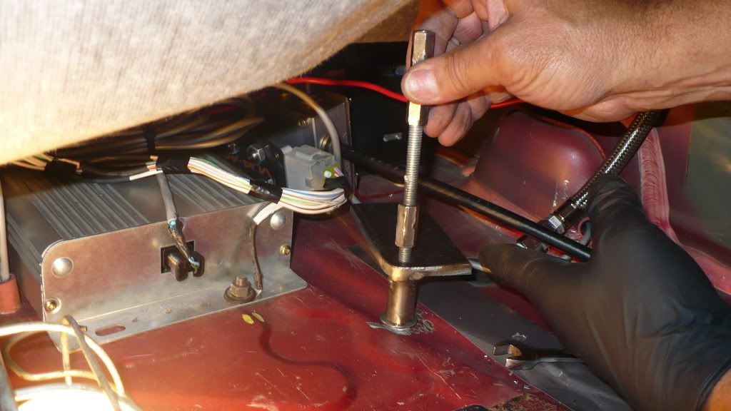

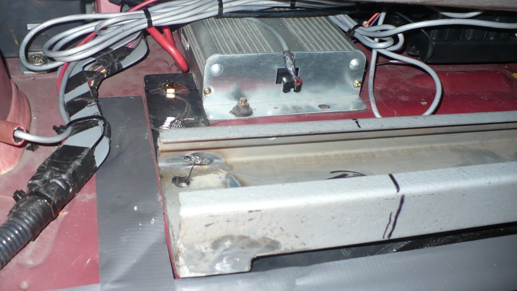

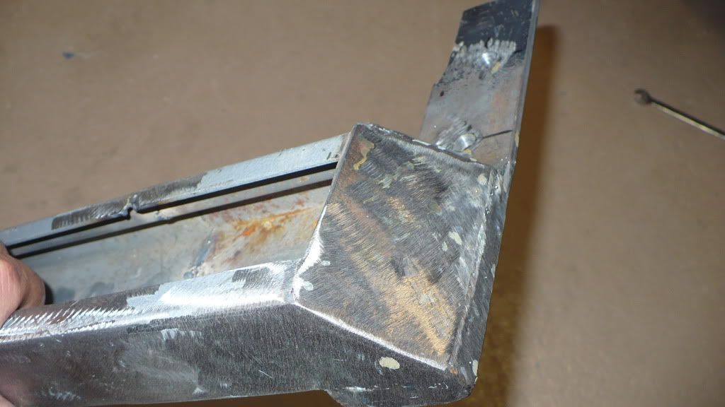

We (meaning Michel) spent about 45 minutes using his fabrication skills to build a bracket to mount the VU4 manifold, and in the end we changed our minds. We then modified the same bracket for the new layout we had chosen, seen in the last pic. We're still in the mockup stages for the most part, so some final adjustments will be made to improve looks and/or functionality.
From there, we could find a place to mount the ECU. We chose to mount it directly behind the top motor, using a couple of custom made brackets. We used a couple of self-tapping screws on the two bottom tabs of the ECU to attach it to our brackets. The length of the VU4-to-ECU wiring harness is pretty restrictive, so we will extend it tomorrow to allow for the mounting locations we chose.
Here is the driver side rear bag essentially completely installed. The shock absorber has been removed to acces the area we will be using to install the ride height sensors.
Meanwhile, Michel was again impressing me with his fabrication skills by using a cardboard Coca-Cola carton to make a template for the lower bracket of the ride height sensor.
The bracket seems like overkill to me, but Michel is happy to do this kind of work, and I think it will look and work great once it's done. Here is a shot of the rear passenger side suspension fully compressed. Once the car is on the ground, it probably will never get this low, so we will be making some more minor adjustments to pushrod length and sensor positioning. The template is also not the final version.

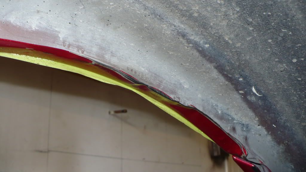

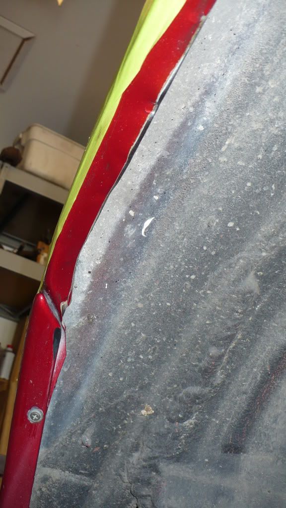

Here is a bonus shot of the inner fender on the left rear. You can see that the metal has beel folded upwards from the tire rubbing on it. I didn't even know this had happened until today. I thought I was just rubbing on the fender lip, but even that is not what I was expecting. We will resolve these problems before the car goes back on the road.

We also had to think of a solution for attaching the sensors, because they are being mounted on the rear framerail. It's like a 2"x3" (roughly) hollow steel section, so our options are either to drill out both sides to gain access for a nut on the back side, or use a Nutsert. We decided to try the Nutsert option, and Michel was tasked with trying to find some locally today. I haven't talked to him, so I don't know if he found some. For those that don't know what a Nutsert is, here is a pic and a link:
Fastenal Nutsert
I emailed Mike at Accuair with a few questions we had about the ride height sensors. We needed to know what happens if we go beyond the oft-repeated 2.75" maximum travel for the sensors. With our current setup, which is the only option we have anyways, we have roughly 3" of travel at the sensor. The sensor allows for almost 4" of travel between the physical stops, but Mike says there's some kind of dead spot at either end of the range that the sensor won't be able to read properly. I guess we'll have to see what happens when the car gets out on the road.

Michel's fabricated compressor brackets were all painted and ready to go into the car, so we got them installed.

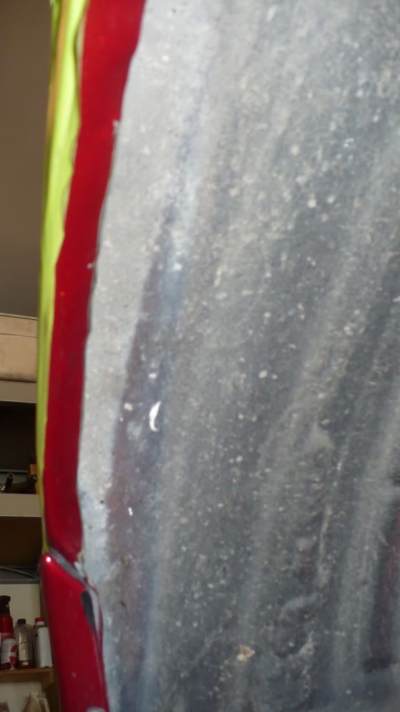

We noticed that my right front tire is worn unevenly down to the cords on the inner edge while we were under the car. We'll have to investigate the cause of that. A new tire (or two) and possibly a ball joint wasn't on my to-do list (or in my budget), but safety first.

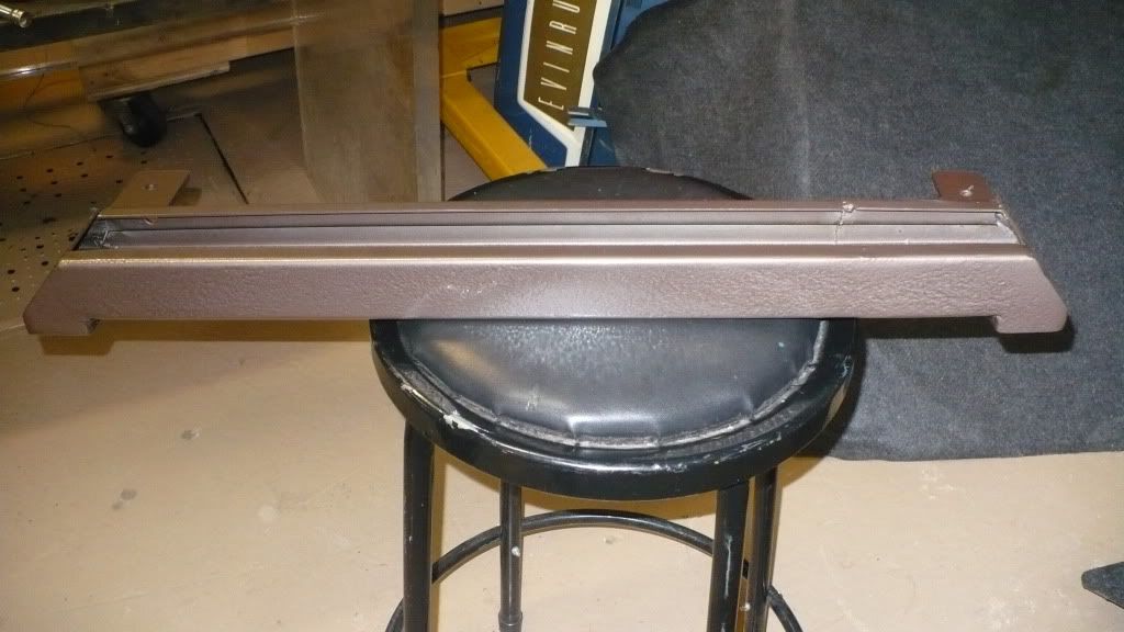

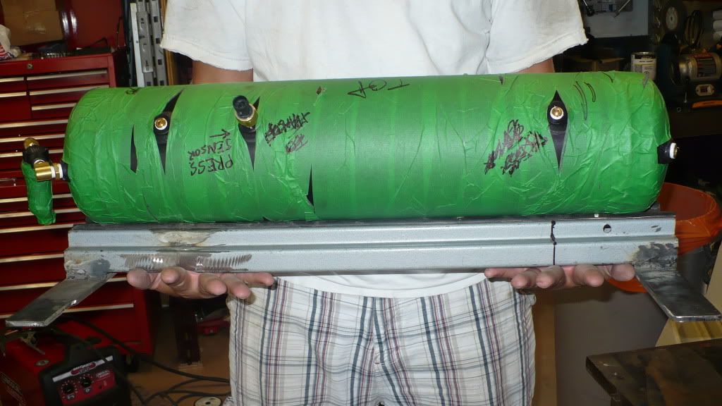

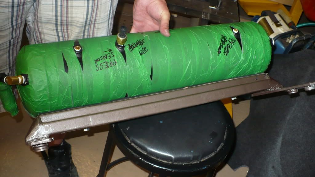

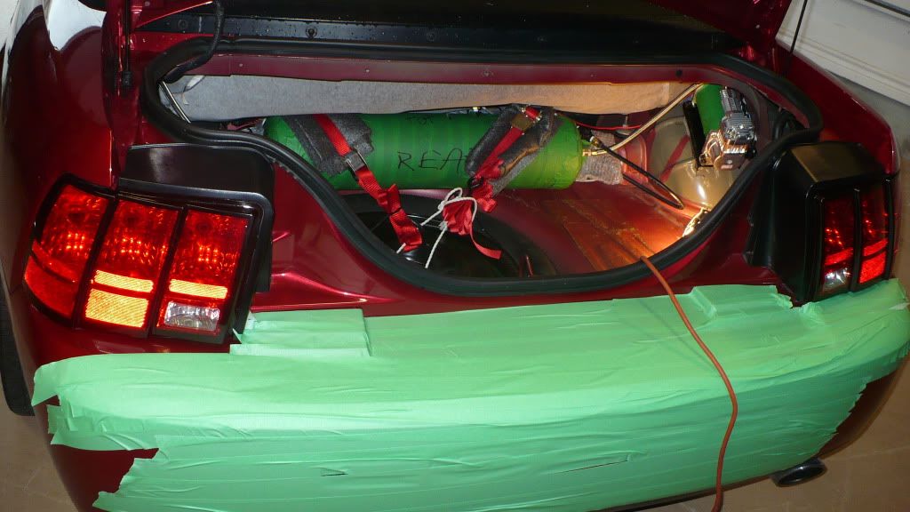

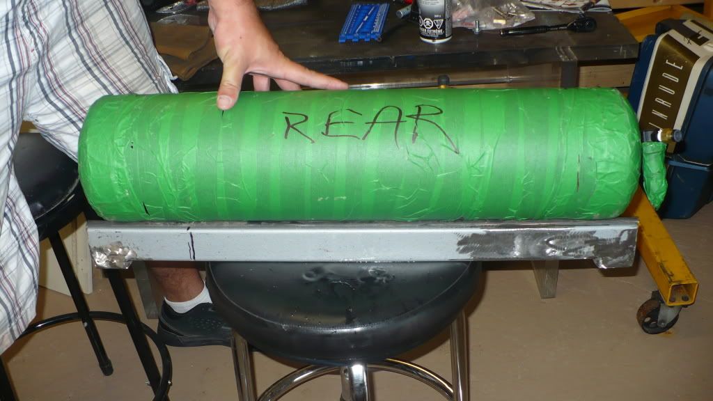

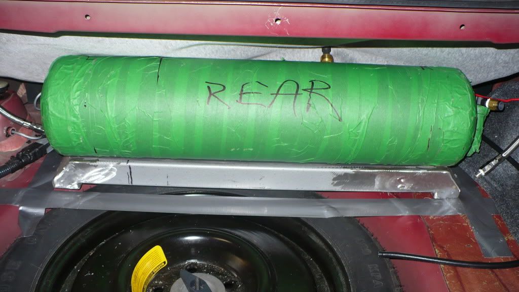

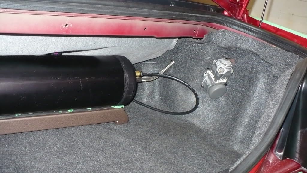

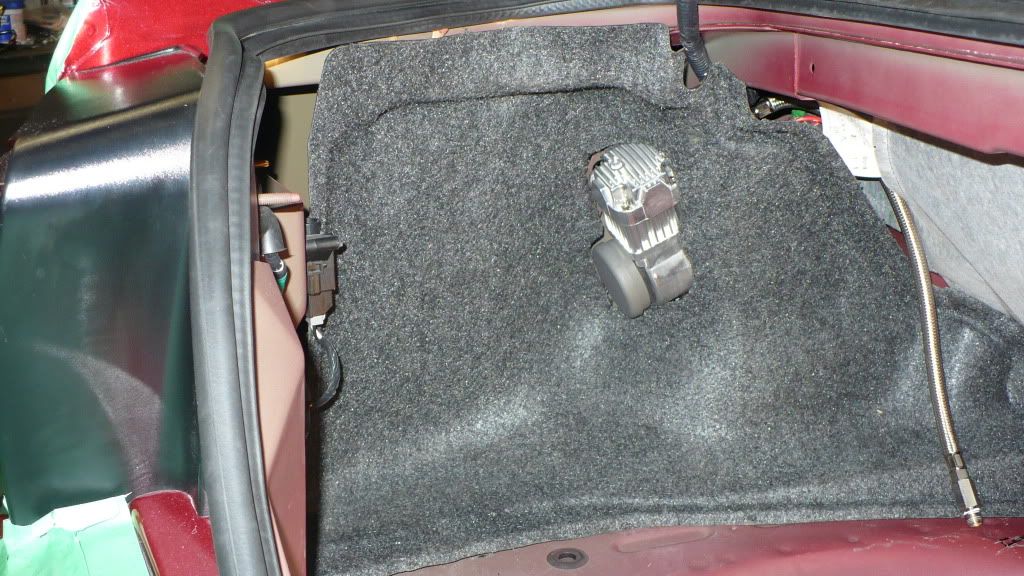

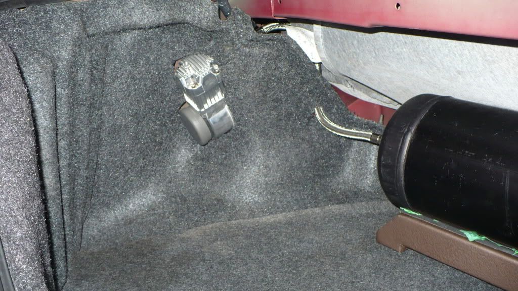

Michel started off Friday's work by designing and fabricating a tank mounting bracket. This was necessary because the tank mounts over the spare tire well, and one of the two bolts was directly over the tire. Even though the system is functional, the bracket is still evolving. We have not yet determined how to attach it to the floor in front of the spare tire well.
Meanwhile, I was finishing up the power wire for the compressors at the front of the car. We had fished it through the inner fender on the driver side so that it doesn't clutter up the underhood area. Not like a wire takes up a ton of space, but space is already at a premium with a 4-cam supercharged V8 under the hood. In case you're wondering, the other little box with the car on it is one of those rust inhibitor doodads. Don't ask me if it works. I guess we'll find out in 30 years.
Once we got the wiring done and the tank temporarily installed, the rear suspension was fully functional. We were finally able to remove the car from the garage to turn it around and clean up the floor while it was out. It was also a great chance to take a couple photos and a video.

We worked exclusively on the trunk today, and in case you don't remember (or haven't looked), here's where we left off.
Michel took the bull by the horns and started working on the tank bracket. Here is the first iteration of it, showing the non-visible side then the visible side, then a quick test fit in the car.
Here's Michel being all nonchalant with the grinder, and throwing down some welds.
In the meantime, I got cracking on fitting the trunk side panels back in place, cutting holes in them to clear the heads of the compressors. It's a long and tedious process, starting with a black sharpie circle on the backside. Then, little by little, cutting away a small piece, then test fitting, checking where to cut next, removing, flipping the panel around, trying not to forget where to cut, cutting, and reinstalling, and repeating until satisfied.
We had come up with an aesthetic upgrade for the tank bracket that Michel worked on in the meantime. We decided to angle the sides in towards the top, making a cleaner appearance. Then, one more test fit in the car. The long tabs on the bracket are necessary because the left side of the bracket is above the spare tire, where it can't be attached to anything. So they go forward, and bolt into the floorpan using the same inserts we had previously used for the ride height sensors. The last pic is the insert tool that Michel had fabricated back when we were doing the sensors. It was getting pretty beat up, but a little grease got us through it.
Once the side panels were done, we were able to test-fit the floor carpet. We figured the simplest way to keep it functional was to cut out the areas where the tank brackets bolted to the floor. This way, the carpet is completely removeable, and the spare tire can still be accessed. Putting the carpet back in is simple too, because we decided to put some spacers under the tabs of the tank bracket. This had the added benefit of making the whole tank bracket look like it's floating above the carpet once it's all put together! Pretty cool!
Michel hit the bracket with some hammered-finish paint that was kicking around on a shelf. I'm not sure exactly what I'd like to do in the way of painting the tank and bracket yet, so this will do for now. In the second pic you can see the stacked washers that I mentioned above. Betwheen the tank and the bracket there's an old rubber propane hose that was slit lengthwise and fitted over the bracket. Really simple, but looks pretty good, and protects the tank and maybe even damps some vibrations.
So we got so close, but we called it quits before we could tackle the front trunk panel. It's a tight fit, and we were both too tired to be doing delicate work. So this is where we stopped. You can also see that we drilled holes in the side panels to pass the braided compressor lines through. The left panel took a couple of tries to get the hole in the right spot.
Next time, we'll finish the trunk panel, and find a better solution for the air line that goes from the tank to the manifold. We discovered today that the water trap wasn't doing its job because the water was all in the tank. But in the meantime, I'm happy that the trunk is useable again.

I finally got some time to sort out things that were on my to-do list for the air suspension.
The first order of business for the day was to swap out the 9 or 10 year old stock battery for an Optima Red Top. Thirty minutes later, that was taken care of.
Next up, I needed to sort out the tire-rubbing issue. As I have surely mentioned several times in this thread, the tires rub in the fenders near where they meet the bumper. This had been going on since I swapped on the 11-inch wide CCW Classics in October of 2009. It was never serious enough to worry about, but it was chewing up the tire where the tread rolls over to the sidewall.
On top of the usual rubbing, I encountered a problem one cold morning this spring when the car wouldn't air up because the water in the suspension system had frozen up. When I tried to move the car, the passenger side tire bent up the lip of the fender a bit. No visible damage, but it resulted in the tire rubbing even more than usual, and the lip of the fender cutting into the tire every time I'd air up or down. You can see below the section I'm referring to. The first two pics are "before," the last two are "after":
The driver side rubbed too, but nowhere near as much, so I fixed that side too. No pics necessary. I didn't use any fancy fender roller this time, I just went at it semi-gently with a plastic mallet. I followed up with some black paint to help protect the exposed metal. In retrospect, I should have gone with some shade of red to make it less obvious. Whatever.
Now the fenders don't grab the tire sidewalls any more when airing up or down and there's no more rubbing when going down the road! I can even drive now on preset 1 without rubbing. I haven't tried driving with it fully dumped, but I think that will be possible as well, with only very minor rubbing in the rear. Awesome!
And finally, I took care of finishing up the trunk to a more satisfactory level. Here again I didn't use any fancy tools or products. I just thought it through (for the last 10 months!) and followed the plan in my head. Here are a couple pics of what the trunk looked like before I got to work on it today:
I figured I would be able to reuse the stock trunk panel that is missing in the pictures above. I got to work cutting and test fitting it until I was satisfied. Now the only things visible are the compressors on the sides of the trunk. Here is the end result (the plugs across the top of the panel are missing, but I have them somewhere. That's a 10-second job):
I think for a total of investment of zero dollars (aside from the price of the battery), I did a helluva good job today! I'm especially relieved to finally get these items checked off my list. Finding time to work on the car without my own garage is more complicated than it seems. Now that it's done, I'll be able to enjoy the car even more!

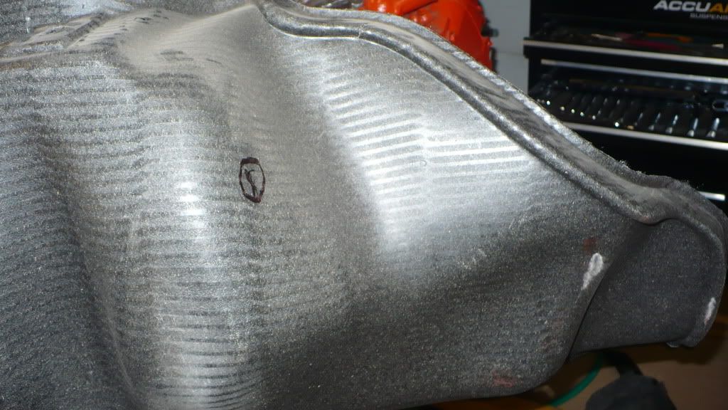

And finally, most relevant to this thread, I removed the air tank to drain the water from it. There was probably between one and two cups of water in there, so I'm glad I did it. In the spring and fall, the nights get below freezing around here and I didn't want my car to be incapacitated again like it was once this spring.
Needless to say, removing the tank to drain the water is not very practical, so Michel and I brainstormed a bit to come up with a plan for a water drain from the tank. The tricky part is accessibility, and the fact that I want the water to drain outside the car and not inside the trunk. We came up with a rough plan but I'll have to go to the local air compressor supply store to see just what options I have on hand. I'm hoping to get this done before I go back to work on Wednesday this week.
