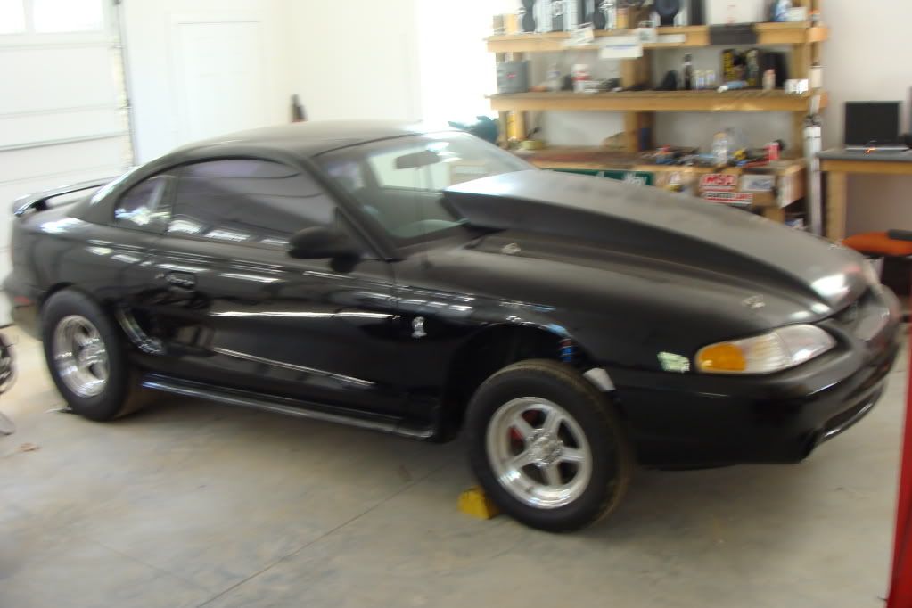

I have a 95 gt that ive been working on for about a year, getting close to being done
ive done the following so far
suspension
UPR K member , caster camber plates, and bump steer, with 90\10 struts
UPR upper and lower with anti rollbar,
strange 35 spline axles with spool
coilovers on all 4 corners
motor
r block 368
poted vic jrs
and a ported vic 5.0 intake, ceramic coated
eagle rotating assembly
classic fast system
and a pair of 72mm turbonetics bb turbos
ppower glide with brake, and Ultimate converter
now its time to start wiring everything up,

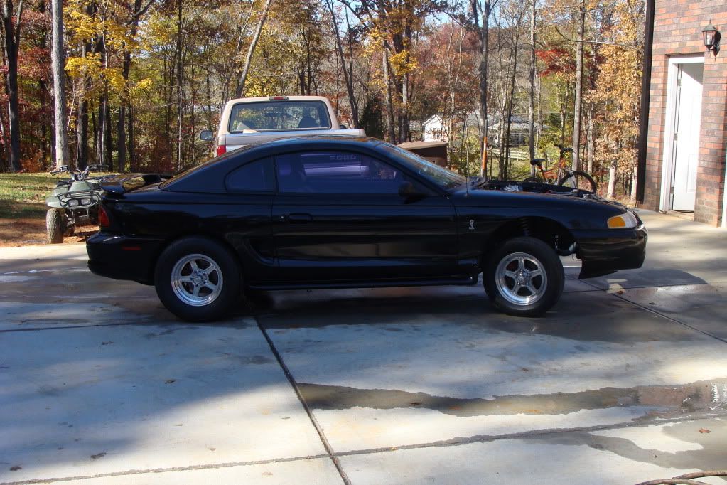

it is the bracket that came with the march kit...the top hood pins are mounted on a bracket that was for zues fasteners , not progress, i sold the fast set up and intake and bought a csu blow thru carb and super victor intake,it sux working on a shoe string budget....i had hoped to be done by now, maybe a month or so

well sold some stuff .....bought some stuff ....now im going blow thru , i got a carb from csu and ive had to remake a few pieces
ive made some more progress over the weekend , and i will have some pics up soon
