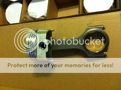

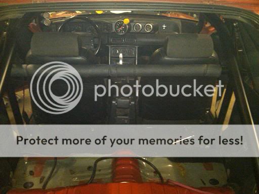

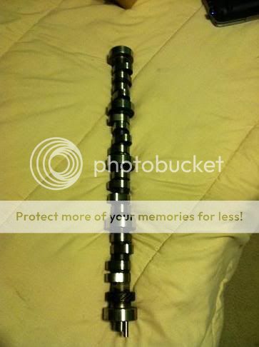

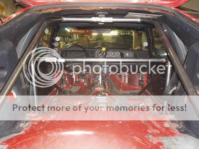

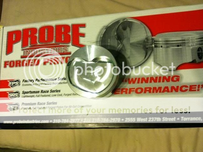

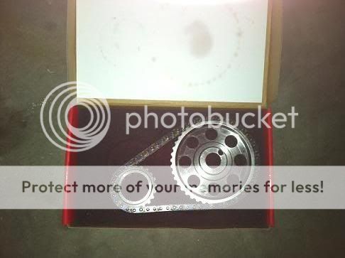

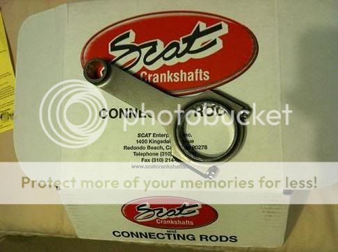

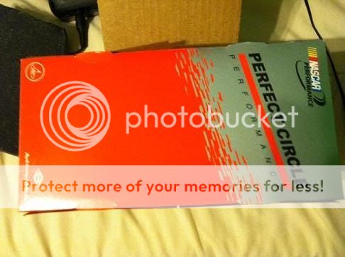

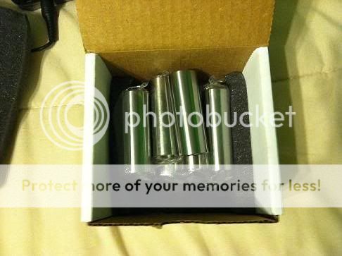

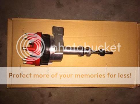

before mustang week this year im going to swap in a 357w. Goal is to run 9's with the 17's and drag radials. currently i have a ponydown 70mm kit that i am going to swap over. Im going to modify the kit to fit the 357w and just upgrade the exhaust to 3.5". going to run my same 70mm turbo till it wont do anymore. also im going to swap over my heads. got a bunch of parts to thorw in this so here are the specs.
1993gt 2997lb weight w/driver
94 351w roller block
probe srs inverted dome pistons
scat H beam rods with ARP 2000 bolts
tool steel wrist pins
file-fit moly rings
ford racing x303 cam
billet distributor
vic. jr. heads
pro products typhoon
pa c4
ucc turbo converter (thanks conbread)
3:27 gear
qa1 K member kit
upr rear upper/lowers
6pt cage
80lb inj
twin walboro gss340 pumps
tuned on Megasquirt 2 PNP
ponydwon hotside modified for the 357
3.5" exhaust
70mm turbo

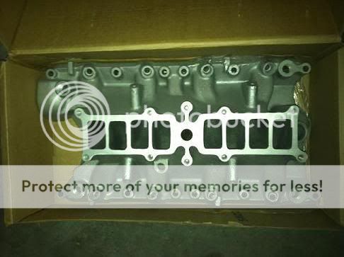

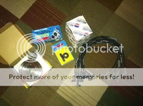

there is alot im missing but for the most part its there. here are some of the pics. finished the cage about a month ago so here are the pics as of then. just got the rest of the parts today.

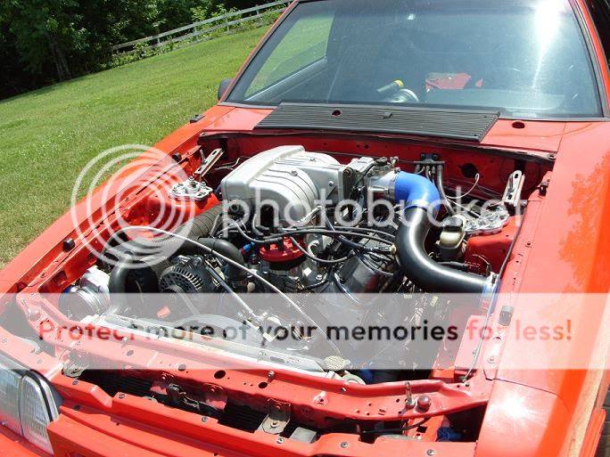

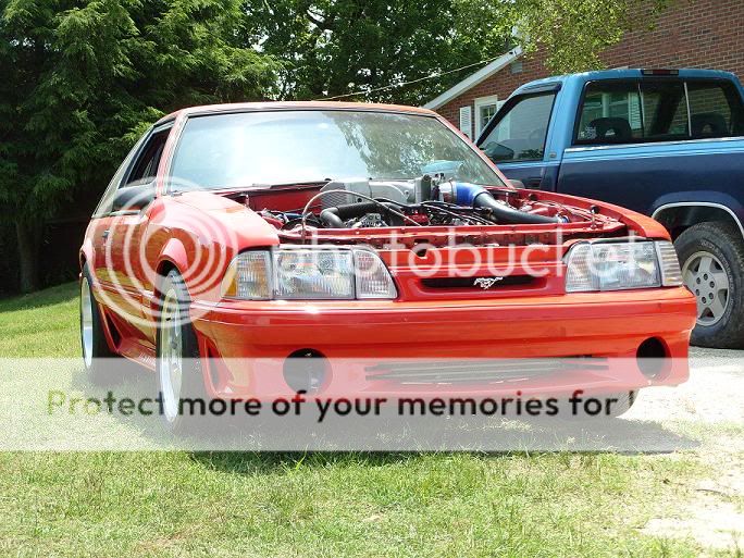

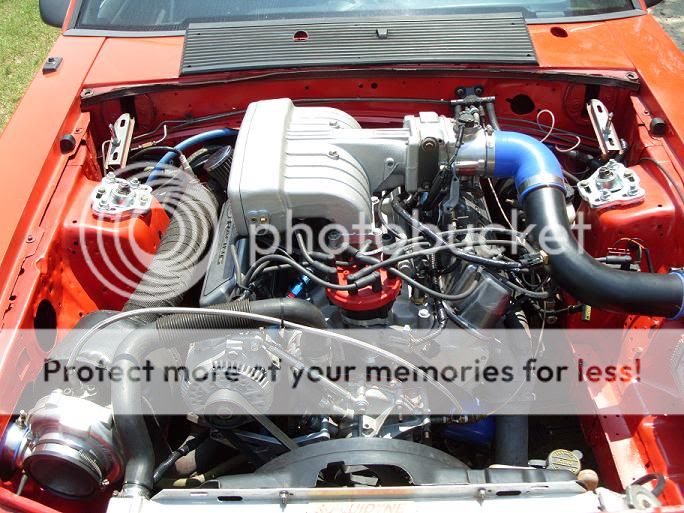

this is my old setup on the 302.

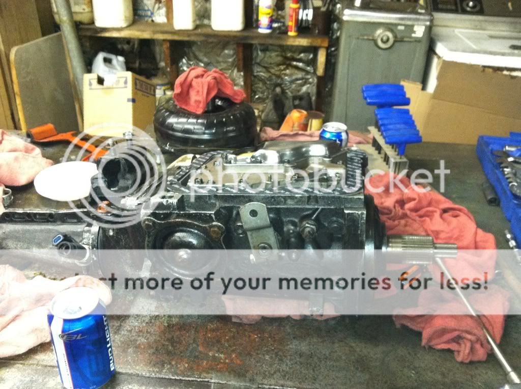

the old 302 out
turbo kit on the 351 before heading to the machine shop.

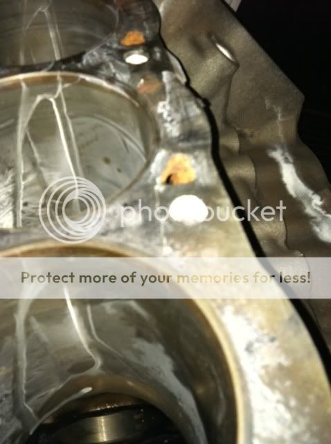

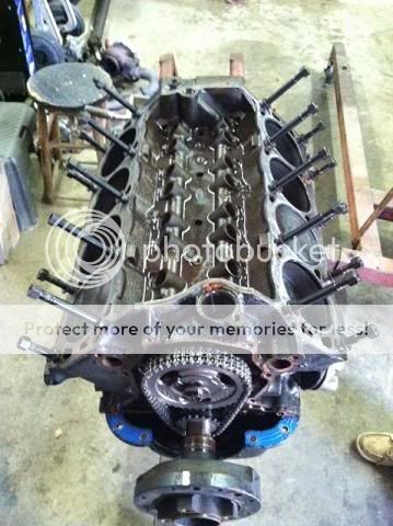

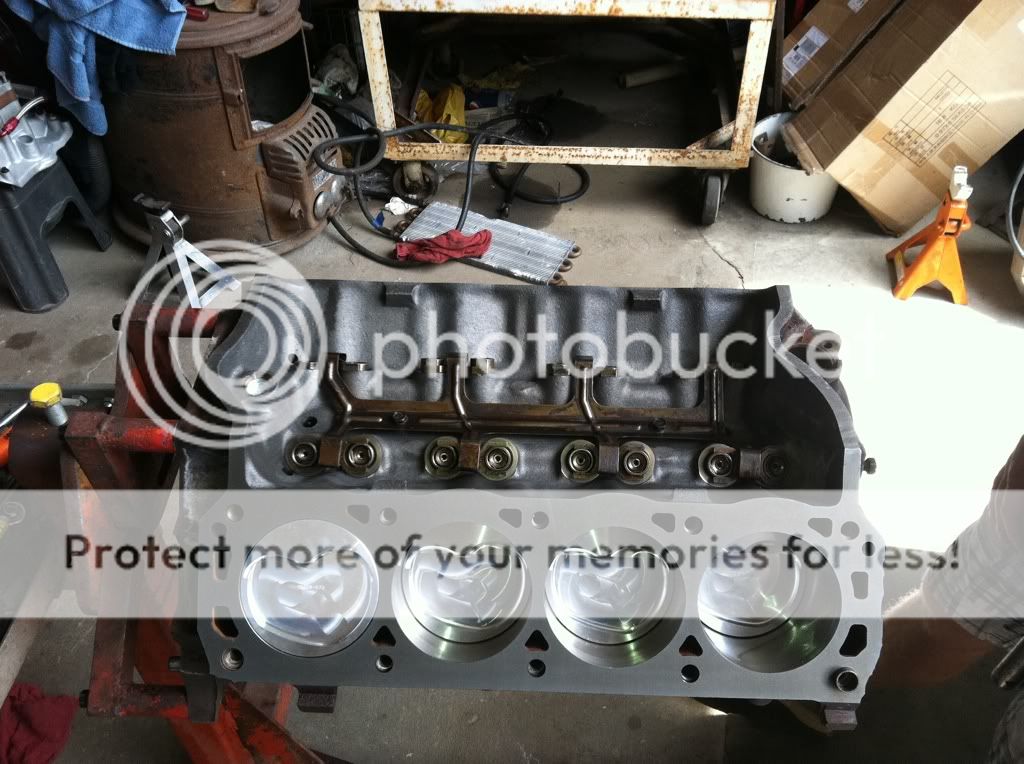

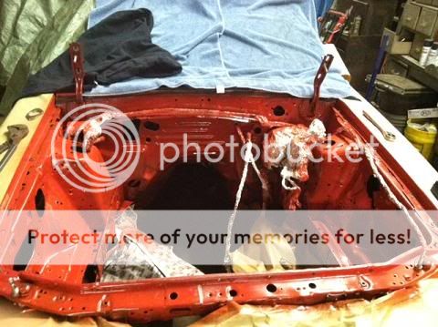

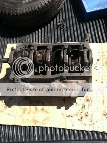

to get everyone up to date: the first 351w roller block i droped off had a crack in it.
here is the second 351w roller that I have. dropped it off monday and pray this one is good.

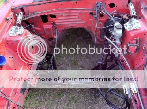

here is how the engine bay looks. getting ready to paint it the same color as the car. not going to fill all the little holes. ran the harness behind the dash also to clean the bay up.

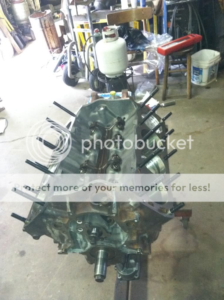

we have ENGINE. got my shortblock back saturday. got all the gaskets and im putting this together. hope to have it in the car sometime this week. also the c4 is put back together with alto racing clutches, and new steel input shaft.

you didnt stud the motor? are those bolts
turbonotchcoupe is offline
Reply With Quote
Old 05-09-2011, 09:17 PM   #27
turbocar's Avatar
Join Date: Aug 2009
Location: high point n.c
Posts: 480
arp head studs and arp main cap bolts. just main bolts no studs

Old 07-08-2011, 07:01 PM   #32
turbocar's Avatar
Join Date: Aug 2009
Posts: 480
Originally Posted by fivepointeightnate View Post
What fan / radiator are you going to use? Curious because my manual fan isn't quite cutting it on 98 degree days without AC.
I don't know about the stock crank, My engine guy went over my 95' F4TE lightning block before I added the turbo and said he wouldn't suggest more than 500hp on it.
im runing a fluidyne 3 core and a taurus fan. dont know why he told you that about the crank? The engine guy that assembled mine has many 351's with stock cranks and s400's that are in the 5.70 range in the 1/8 mile.
__________________
1993 GT 357W T76
turbocar is offline
Reply With Quote
Old 07-08-2011, 07:03 PM   #33
turbocar's Avatar
Join Date: Aug 2009
Posts: 480
here are some updated pictures.
__________________
1993 GT 357W T76
turbocar is offline
Reply With Quote

Nice project. Car has a great stance and your engine bay paint is a big improvement.

Wheels look great!
