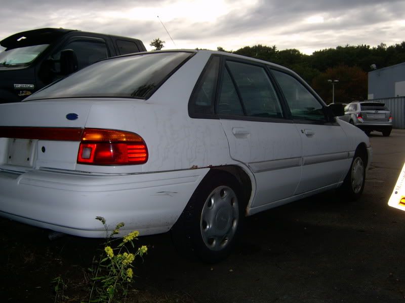

I know, it sounds funny. I just bought a 95 Escort and it appears to have a good amount of mildew on the sides of the car.
The 'scort is white.
Should I use something like orange clean, or is something else better?
When i did commercial detailing we used some yellow/greenish stuff on white paint.
it burned any cuts on your hand, but it worked incredible! All I did was spray it on, wait a few minutes, then hose it off. the white paint always looked new (obviously all the wax and what-not was removed too).
Anyone have any ideas?
Couldn't pass up on the car. It's a 95 'scort 4 door sedan with 91k on the clock, only paid $200. My insurance agent told me the NADA is $2200. Not sure if i can believe that though.
You can kinda see what I'm talking about in the above pics. You can see it around the fuel door, up the c-pillar and on the doors as well.
So, what works best? :shrug: LOL

Get some spray bleach and an old mit or sponge.

Better thing is spray it down with Wesleys Bleach White Tire Cleaner, let it soak for 10 mins.... Then have a bucket ready with 1 cup of Simple Green and 2 gallons water.... Wash like normal then rinse clean.

PURPLE POWER- Dilute in bucket with water. Did an excellent shop cleaning up a filthy white 89 GT I picked up as a roller/parts car awhile back and had been sitting for a few years under a tarp in a guys yard with same type of mildew,dirt,grime etc.
purple power then normal car wash soap then a coat of polish/wax and it looked like a whole new car.
simple green should do the trick as well.

Yup.... A neighbor had a fleet of white Escorts for his business. In ten years none of them had been washed. He asked me to get them clean. I did that and it worked great. He told me they had forgot they were white. LOL

I'd go with purple power its more potent that simple green even when its not diluted. Plus simple green reminds me of cleaning bathrooms in A-school. If it smells clean it must be clean.

X2 on the Purple Power. It's the shiznit. Purple Power+Claybar+wax=new.
