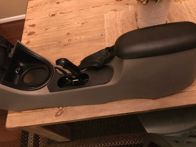

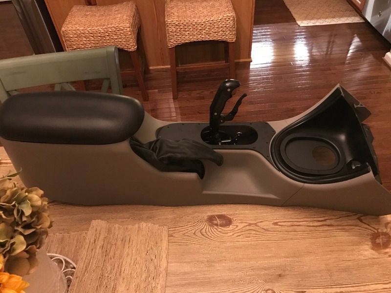

Got center console all set up, found a nice black lid and got a new e-brake boot for the new console so should have this shifter mounted and new console all setup shortly. Only thing missing is boost controller

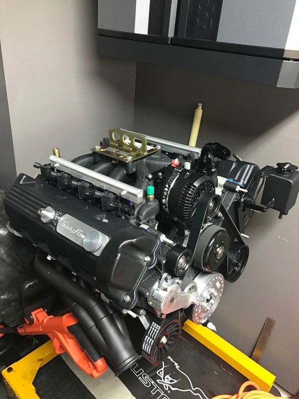

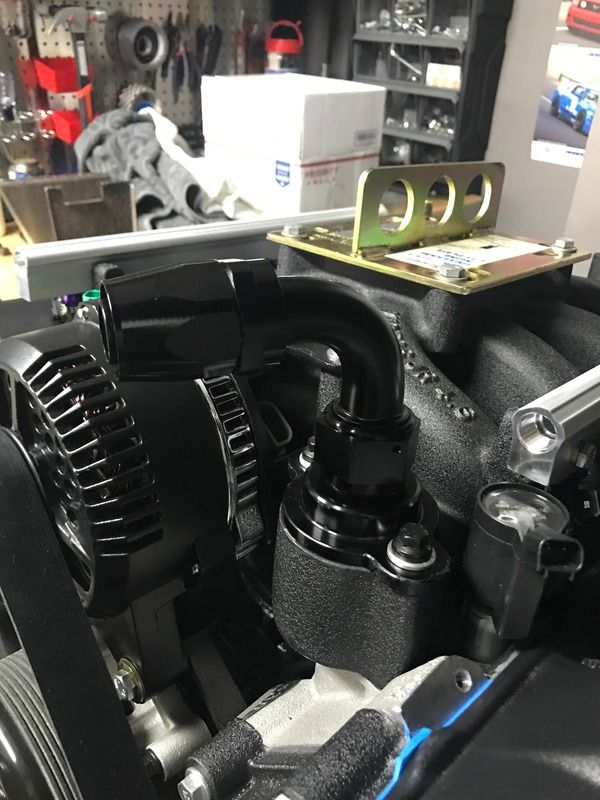

So I am in the process of also changing from the typical water neck/rubber hose coolant passage to the radiator, and changing it to A/N, black braided line. Question is, I bought this Moroso filler neck, which has 16an male thread:
http://www.jegs.com/i/Moroso/710/634...FUKBswodKAoD7Q
I was planning on just getting a 90 degree 16an to 16an hose end, and than running hose like you would typically do. I just measured my stock rubber hose, and I'm getting an I.D of 1.5". I just did some conversions online for 16an hose, and I'm getting that that only has an I.D. of .875". Would that be a problem to be going that much smaller from stock?

For me I think going that much smaller "could" be an issue and I wouldn't want to chance it for the amount of $$ you'll be putting into it.
Also, make sure you use the fittings and hose from the same MFR. To help lower costs I didn't and it bit me b/c the -20 hose wouldn't fit the -20 fittings due to the different MFR's specs.

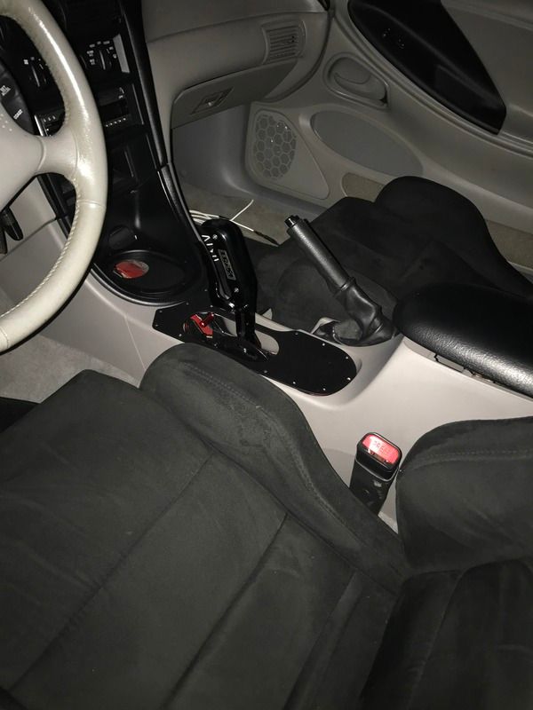

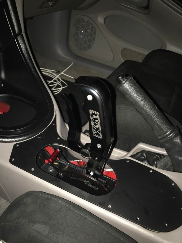

Pretty much got entire center console all setup today. Shifter is mounted and ready to rock. Next have a few harnesses I want to work on trying to tuck to get the car ready for Scott Rod panels. Once the panels are in motor is ready to be dropped in:

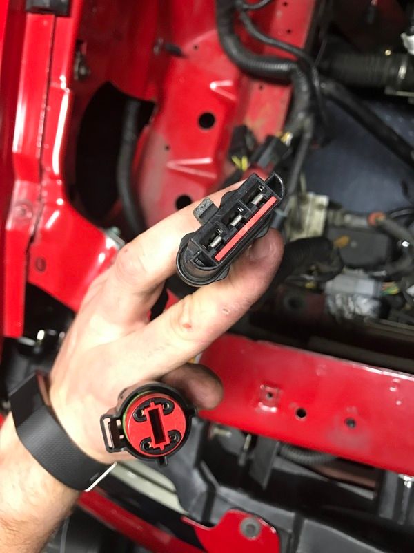

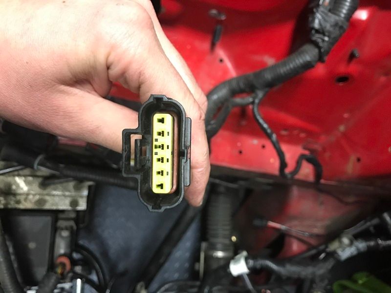

okay guys looking for a little help. Starting to tuck as much wiring as I can before I get these Scott rod panels welded in. On the passenger side main harness, there are 3 plugs I can't remember or figure out where these things go. Anybody have any clue?

Got it all figured out if this will ever help someone in future.
Very top plug goes to fan
middle round red circular plug goes to a/c compressor
bottom yellow is MAF

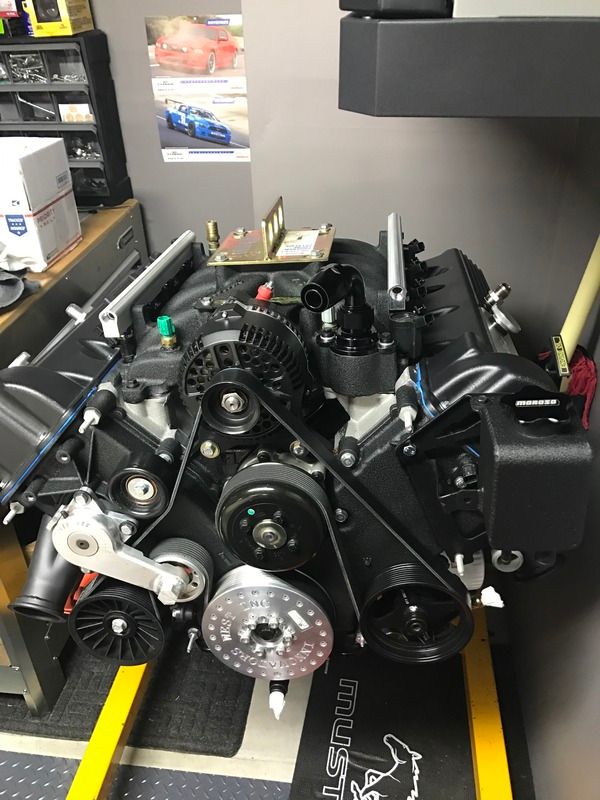

So here is the finished product. Can't really think of anything else to do on the motor. Goal is to bring the car to shop for scott rod panels sometime mid-end of april, hopefully get it back by may, and shooting to have engine in car by June.
The new a/n fitting setup so I can have some more flexibility with this upper hose around the turbo:

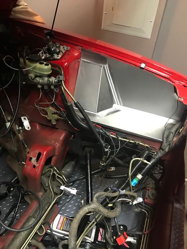

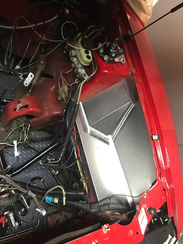

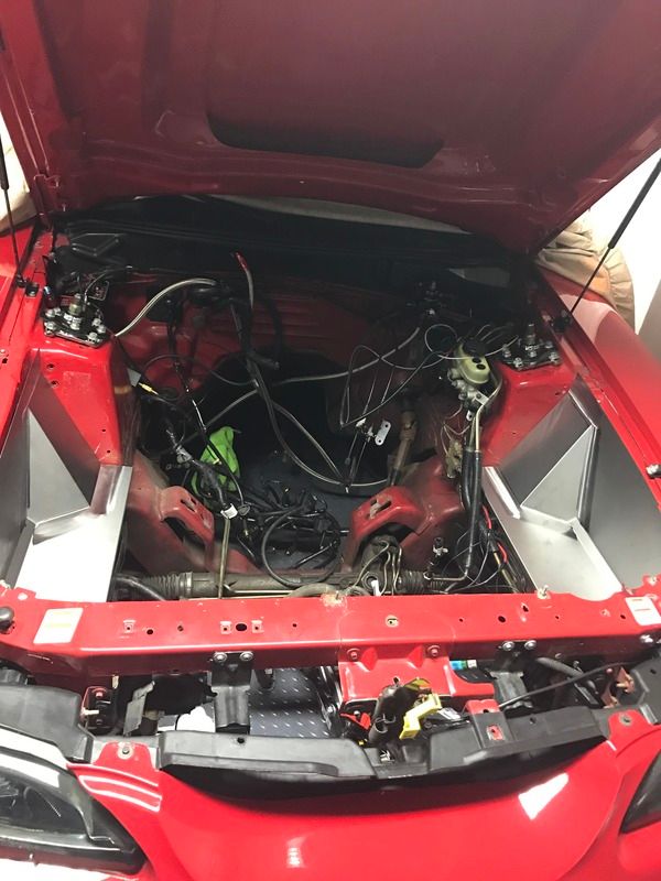

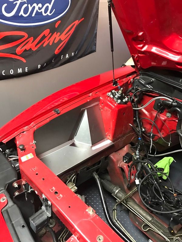

Got a good bit done today getting the car ready for scott rod panels. Got all the passenger side wiring and harness tucked. Wasn't terribly difficult, just time consuming removing all the tape/loom and running it as necessary. To give an idea of a before & after:
And the part I've been dreading for a while. Next will be driver side:

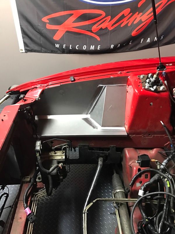

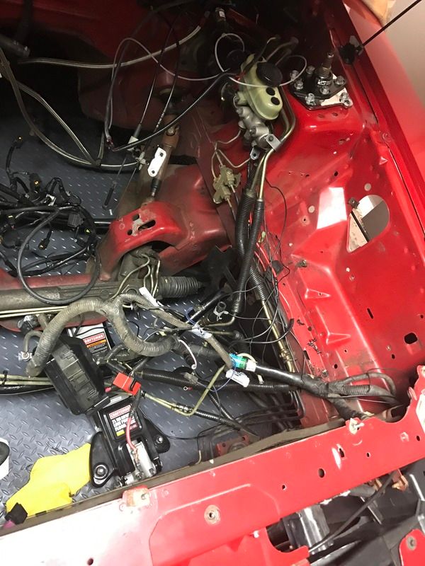

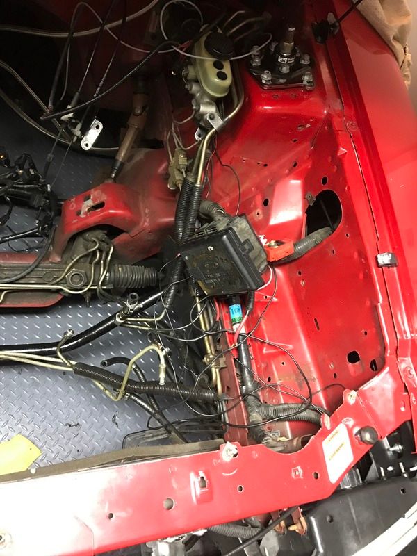

Got a good bit done on the driver side. Removed all the battery wiring since I'm doing a relocation as well. Doesn't seem all that crazy, just very time consuming. Does the harness that goes to the underside of the fuse box have a connector or are they all individual wires?

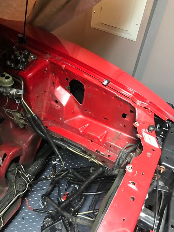

Ended up disconnecting the fuse panel from all the connectors from the inner fender and pulling it inward. Didn't have to cut or do anything to the inner fender or fuse panel itself. There were actually quite a few connectors that had to come off on the inside, i think it was 4-5, some were a pain...but got them all undone and was able to just pull the fuse panel from the inside out of the opening. Obviously, now I'll need to run the harness under the rail and tuck it up under the inner fender and I still have some gauge wiring and fuel pump wiring I'll need to re-run, but its getting there:

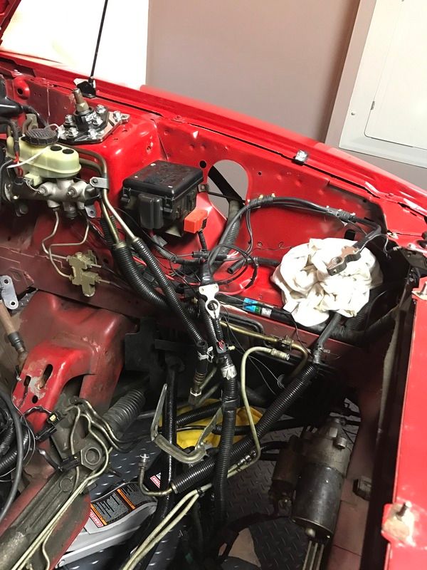

Getting close. Just have to make a bracket to mount the fuse box to the inner rail and reconnect the harness pieces to the inner fender and it's all set to go. Probably a few more hours and everything should be about done:
