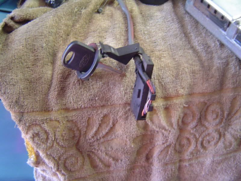

So, I got a new (to me) ECU, PATS, Ignition Transponder and Key all from the same vehicle.
AND there is no change; it still fires up for a second, then dies. I hooked up a light to the 'theft indicator' wire from the PATS controller, and it doesn't blink at all. (not during KOEO, or cranking or any other time) I would have thought it would blink at SOMETIME, like a system check at least.
Any ideas? Does this picture look like it should work, the way I have the key situated in the transponder ring?

My 96 WILL allow the car to start with a non-PATS key, the THEFT light then blinks and the car dies (1-2 sec.) the THEFT light continues to blink.
Initially inserting the key and turning to the ON position, the THEFT light comes on with all other lights, (CEL, BAT etc.) then goes out until turned in the start position, then what described above takes place.
8111870 is offline

1+ 8111870
That was exactly what I was looking for. I probably have a bad PATS module I'm guessing, since I only get it to start once in a blue moon, and no blinking lights EVER.
