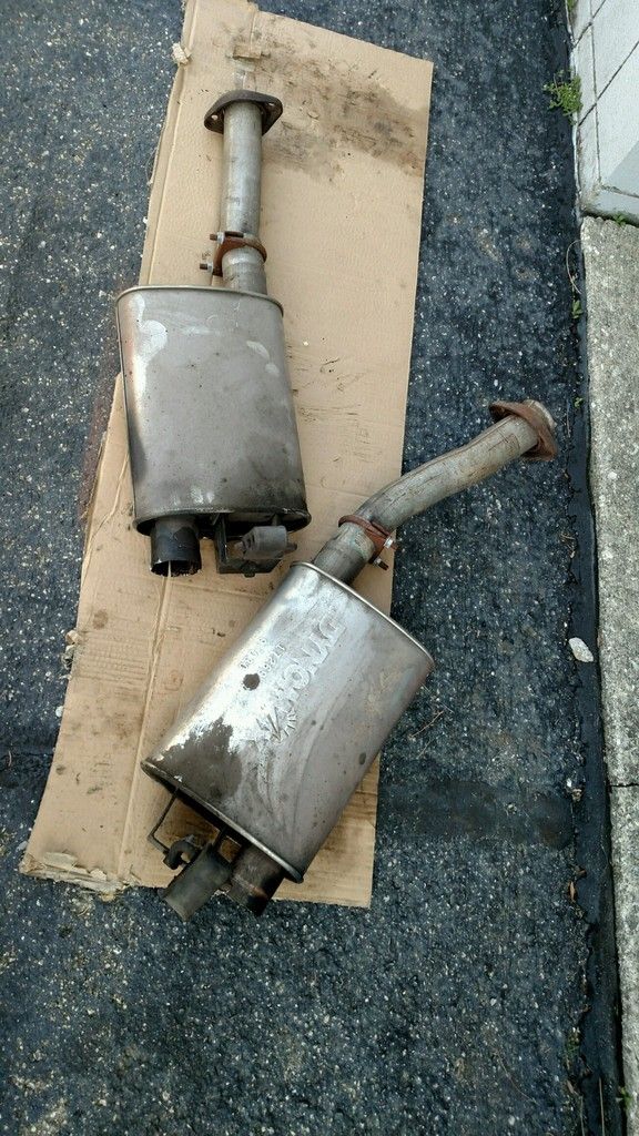

Yup, I wanna do my pipes in V-Bands, but I assembled them with old school U Clamps. Any ideas on how to get the Tailpipes out of the Mufflers without destroying either one?

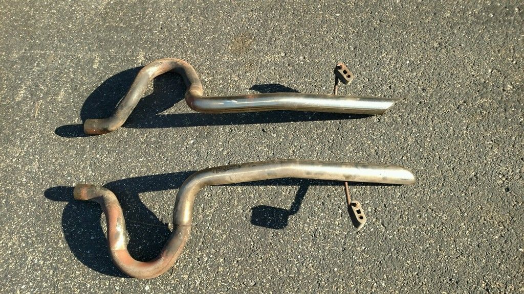

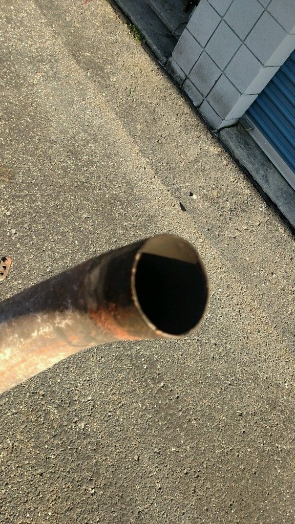

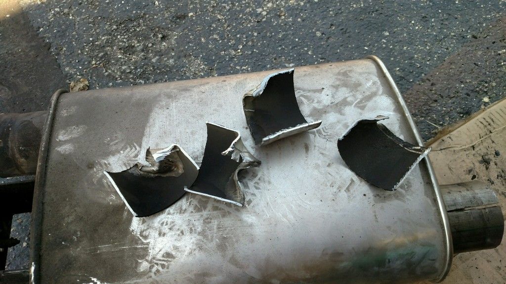

Got it done!

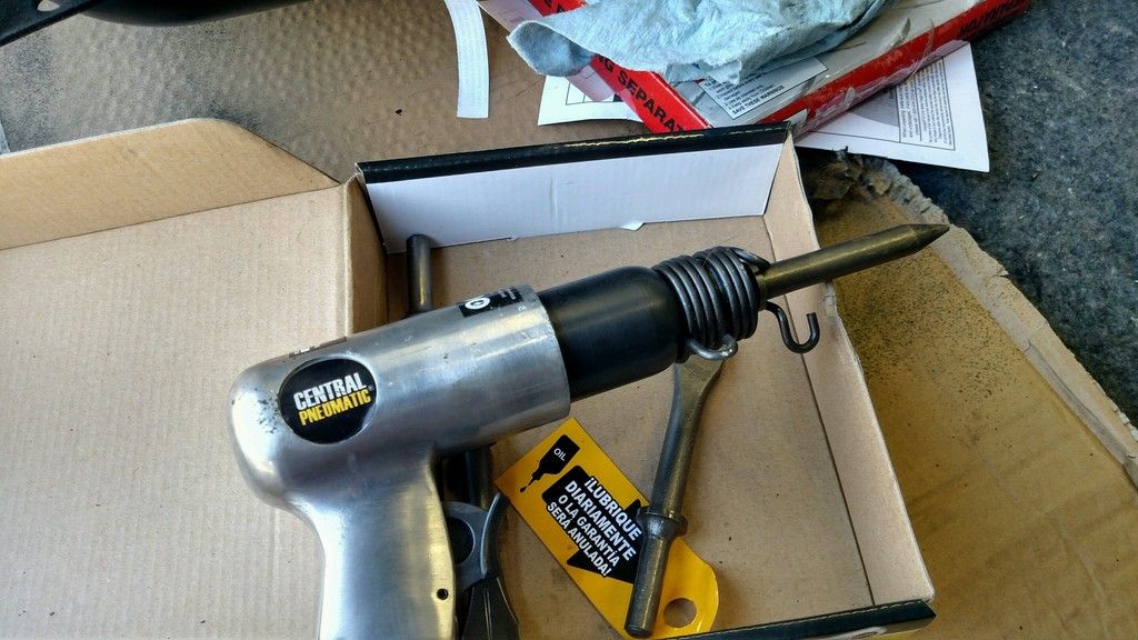

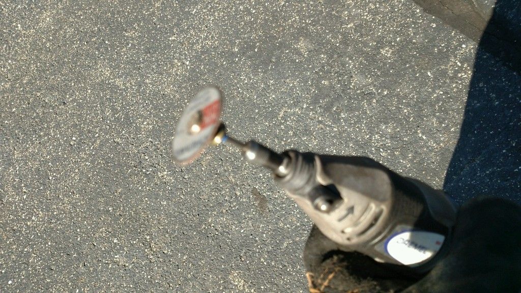

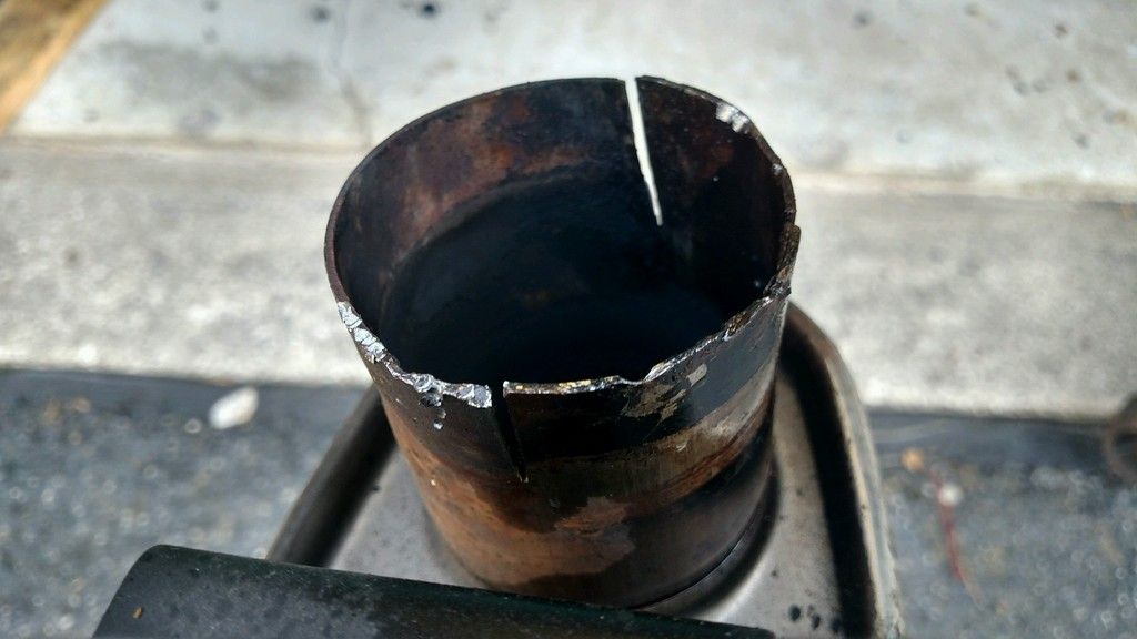

I found some cool little cutoff wheels that fit my Dremel. They worked like a champ! I made a few slits on the Muflers and then used an Air Hammer with a Spike to open things up. It was actually really easy. I then got my real Die Grinder and chopped the Flowtubes. I tried to cave in the remaining metal inside, but it wasn't working out like I thought, so I just made 2 cuts on each Muffler, and pulled out the inner halves. Shoulda' done that in the first place..
Everything is in good shape. I'll touch up and weld where needed when I get these V-Bands on there. This Catback system is battle tested! It's been on for 17 years. It will clean up nice. I'll polish the SS and hit the rest with some Eastwood rust encapsulator and topcoat. Everything will be like new. Always good to save a few bucks. This Twin Turbo build is officially underway.

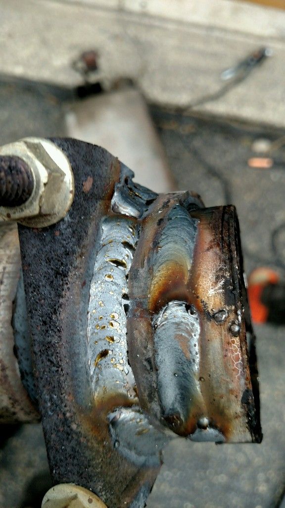

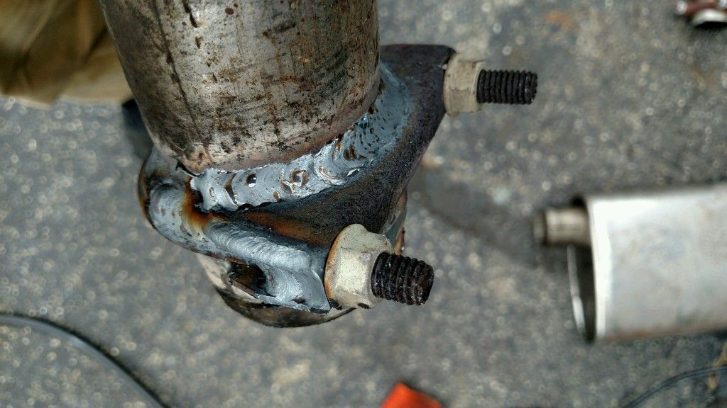

I picked up an 120V Eastwood Welder. I did some testing on the Flow Tubes that I hacked off.. This is on the Max heat setting and I didn't clean the metal at all, so it looks like it will get the job done. I Can't wait to finally get some Subframe Connectors on this thing.
