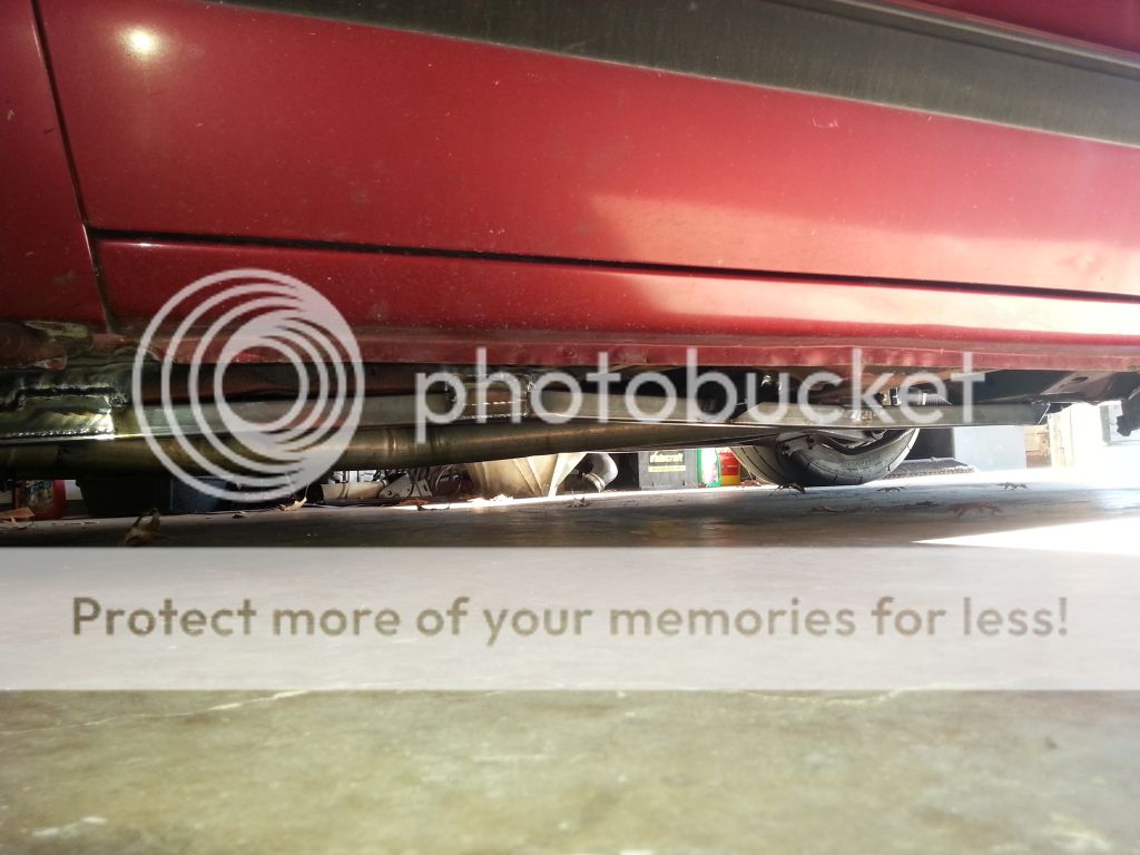

Originally Posted by kim View Post
Not to crush your hopes and dreams, but I wager for $40.00 your install is no-where near the install as recommended by MM. I just browsed the install process as recommended on there sight, and I agree, IF the chasis isn't bent so bad as to require a bunch of tweaking to the sub-frame connectors, 3 hours is about an expected time of service, between carpet lifting for the floor slot, to the trimming of the existing panels, to the proper tack then final weld recommendations.
I think we might be talking about something different. I didn't have to lift any carpet, and I didn't trim anything either....
OP, is this what you have?
Doesn't look like to much is holding the connectors to the rear subframe,kinda defeats the purpose if your trying to tie the front and rear subframes together.I would look into running a longer bead at the rear and a support plate below the bend of the connectors.
And it may be broken already, I don't know. Last time at the track I made 3 low 1.5x 60' passes and took the car home and parked it. I haven't been under it since so I can't say for sure if it's held. I don't think it needs welded all the way down the front or at the seat bracket, but I do agree with continuing it further down the lower torque box.
