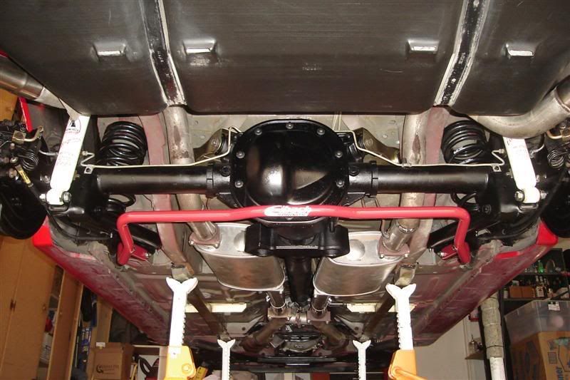

DynoMax SuperTurbos and standard aluminized tubing on mine for the last 5 years. (Pic is a couple years old, but the pipes/mufflers still look the same.)
Car is a fair-weather driver, stored winters in Ohio.

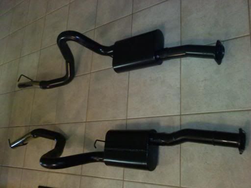

IF you don't want to spend a lot of money. I have had very good luck with VHT high temp paint. I am kinda cheap and times and will paint exhaust part with the "ceramic" exhaust paint and it holds up very will. You have to make sure you clean it up good and follow the direction.

exhaust rust
I painted mine with black rustoleum. 3 yrs later, it's still there looking good. from collectors back. no blistering or peeling. 3" duals, dynomax's, turndowns. most systems rust from the inside. silver paint lasts longer(aluminum powwder) painted a boat trailer 8 yrs ago, still there.
