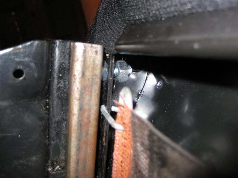

Those are the exact seats I have in my t-top car. All it took was to bolt a piece of flat bar across the seat track at the front and one at the rear; drill some holes and bolt the seats to the flat bars. Pretty simple.

I dunno, to me they are pretty hard, I wouldn't wanna drive more than an hour or so honestly. Seriously, you don't need aftermarket brackets, just a couple pieces of 3/4" wide 3/16" thick flat bar to lay across the stock ones. Works fine.

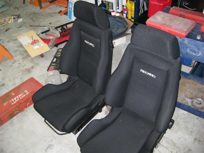

Installed some Recaros in my 93
Anyway, picked these up about a month or two ago.

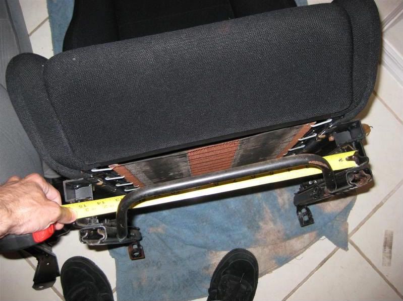

These are aftermarket seats and the guy had them in a volvo for the past 8 years or so. For $400, I couldn't say no. I did some measurements, and the brackets were WAY to wide for a fox.

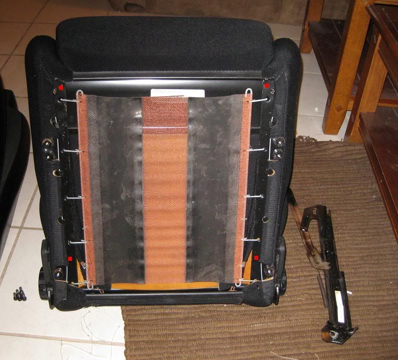

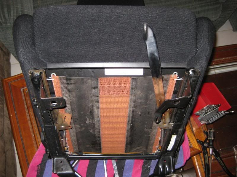

I could have bought the correct mounting brackets for about $150. **** THAT! I then stripped off the recaros brackets, and did some measurements.
The red dots are distance apart the factory fox body seat brackets mounting points would be. I got a set of seat brackets from a friend who had a spare set of seats paying around, as I didn't want to mess with the cobra's brackets.

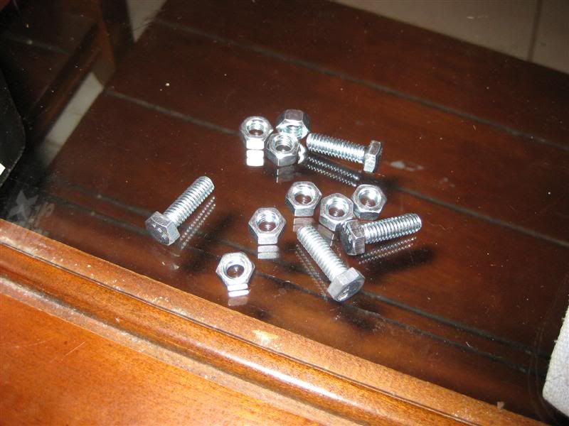

$150 or simply $3 at Lowes?
The nut in between is because the bracket needed to be spaced out a little from the actual seat.

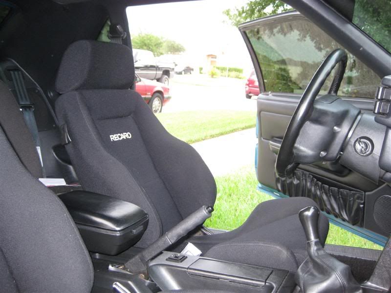

Feels great so far. They sit lower than the factory seat, so it may take a little getting use to though.

I realized taking the seats out woulda been a pain with my harnesses and seat bar and all that, so I got a couple pix installed. The viewing angle is from the floor looking up underneath the front of the seat.
The first pic is looking toward the inner side of the seat, against the trans tunnel. You can see the flat bar I laid across, it's tacked in place but it's also bolted to the stock rails (can't see that though).
Second pic is looking toward the outer part of the seat, the side toward the door.
Last pic is outside the seat track, you can see the round allen-head bolt holding the seat to the flat bar on the outside of the stock track. Pretty simple and stout enough for a 10 second car.
