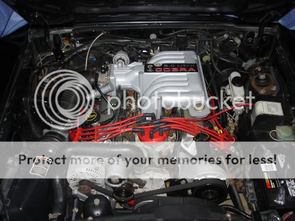

Mustang5L5's Avatar
Join Date: May 2000
Location: BOSTON, MA
Posts: 7,327
Originally Posted by Djstorm100 View Post
so if you use the sn95 rears and 01 fronts a cobra brake booster will work? or do you need to stay with the sn95? I've read the cobra brake booster is the same as the sn95 just fits directly in. Autozone carries cobras brake boosters for 120 bucks.
1993 cobra, 94-95 all and 99-04 v6 are all the same booster.
Only difference is the 1993 cobra uses the sae pitch and stud pattern of the fox booster.
The 94-95 and 99-04 booster use metric thread and one stud is in a different spot.
96-98 v6 boosters have a straight pedal arm and should not be used.
Honestly, the install difference between sn95 and 1993 cobra booster is notmthat different. You have to slot the holes anyway...but the sn95 bolstered just need a new hole drilled. Make sure you have the metric nuts first. The stock fox booster and 1993 cobra booster use sae threads.
I got my sn95 booster in by slotting the holes, and cutting the studs down about 1/2". Didn't need to touch fender at all. I did take the intake off, but the valve cover, and wiper motor stayed. I just moved the wiring out of the way.
Looks right at home
Mike
--1988 Mustang LX 5.0--
--2014 Ford Taurus Limited--
Mustang5L5 is offline
