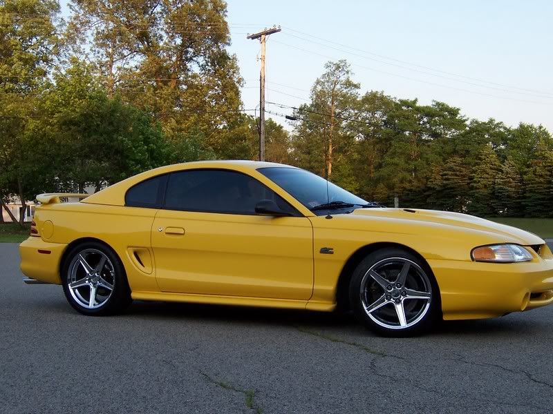

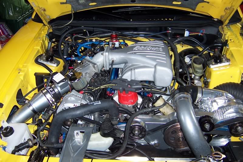

So i am a proud "Clone" of "Fobra" owner, so I am not a poser as you can tell from from user name LOL. My car already had alot of the Cobra stuff on it when I got, so I added some things to finish the look. My car actually already had the Cobra steering wheel when I bought which like stated before, most do not. When people tell me nice Cobra, and I get that alot, I am quick to correct them and say that its a GT. I don't have a real Cobra but yes I agree, I hate when people say they have a Cobra and its really not.
Another thing that I believe is just for the 94-95 Cobra's is that they are only available in red, black, or white, so if you see one that is a factory color and is not one of these colors, then it is also a fake. Mine is actually a clone of a '98 as that was the only year for yellow for our body style Cobra and mine also has the 96-98 bumper and taillights. Of coarse the 5.0 is a dead give away that mine is not a '98 LOL.
Here are a couple pics!
