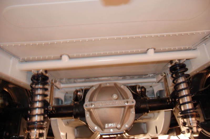

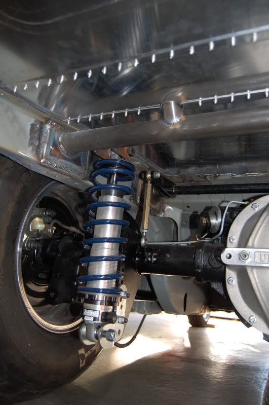

That's a very clean cage install. If you don't mind, roughly what did it cost to get that fabbed up?
Another thing I'm wondering is how guys are tying into the torque boxes? I can see this greatly increasing the TB strength, but to hit the uppers, there's no way you'd be able to re-install the back seat.

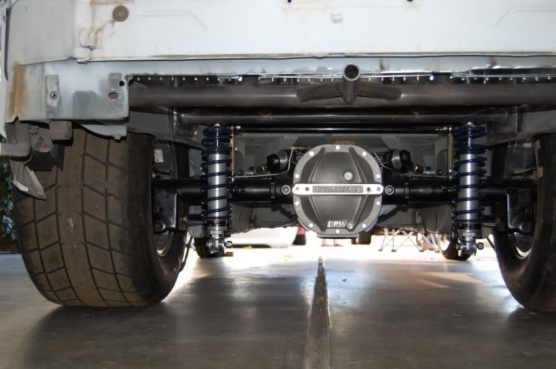

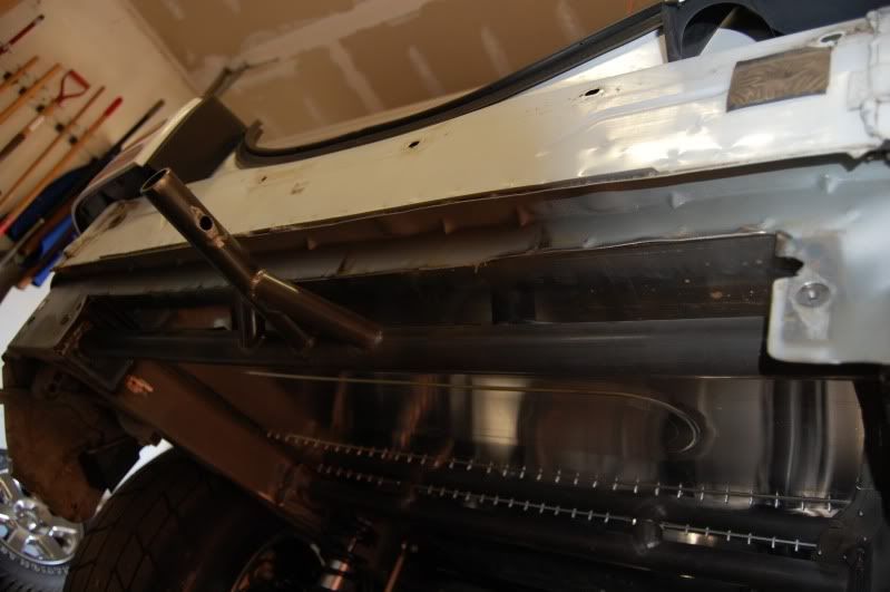

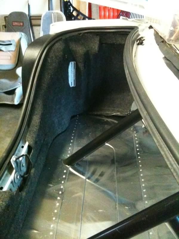

Old 04-02-2012, 04:12 PM   #14
MIKE92NOTCH's Avatar
Join Date: Jun 2008
Location: Deridder, LA
Posts: 735

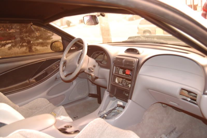

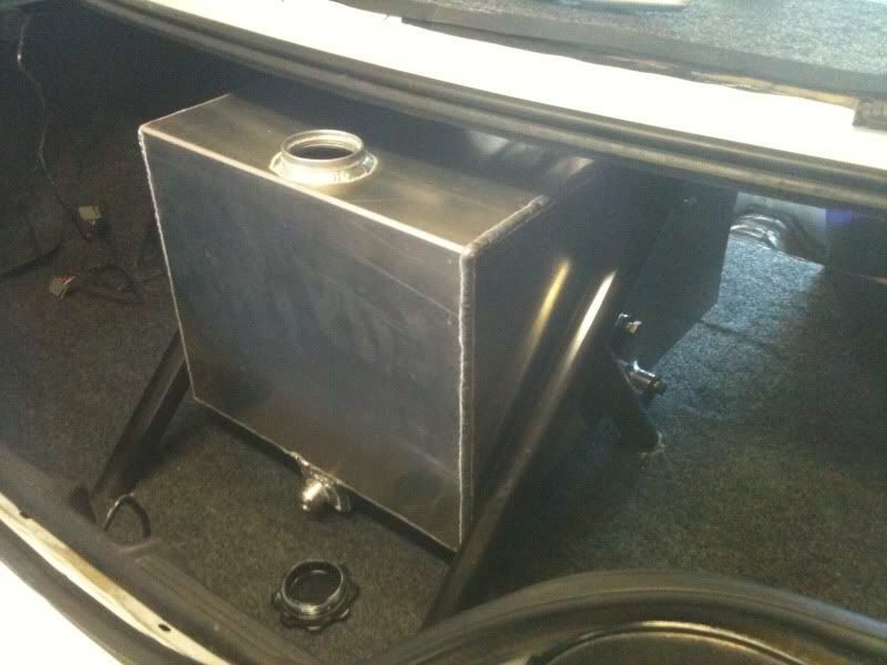

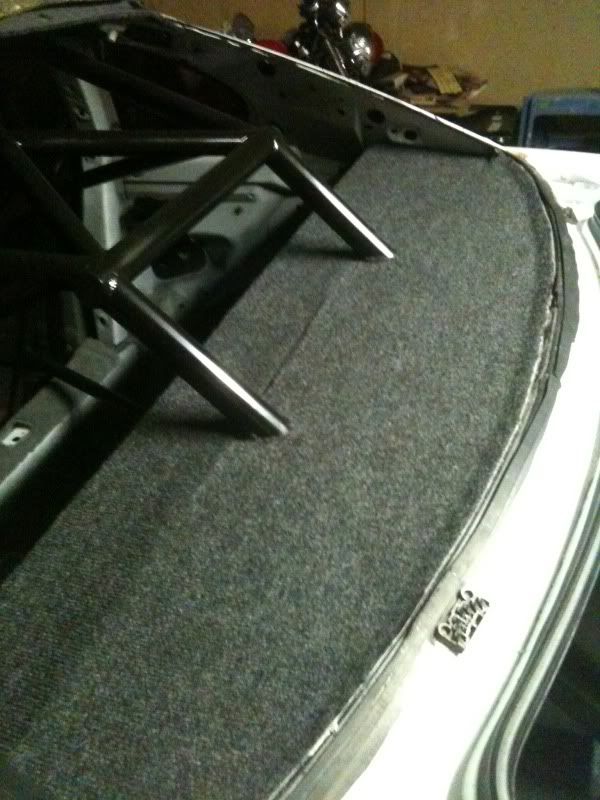

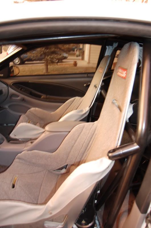

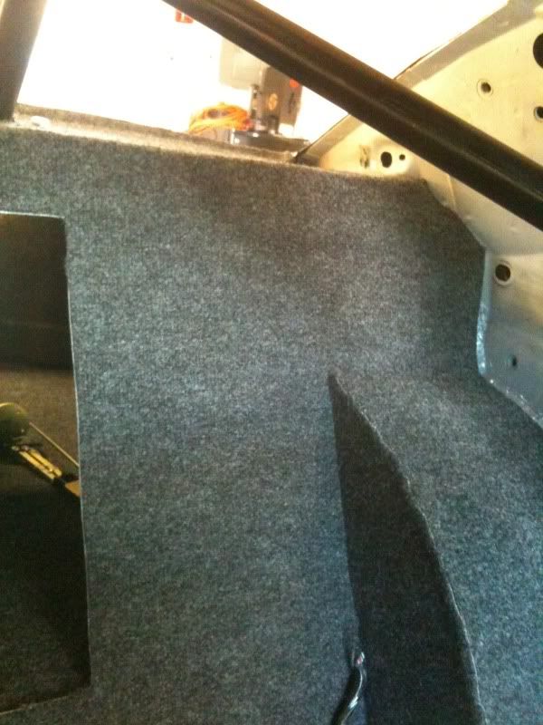

i'm not sure on the cage price. i'd have to look through the receipts. if i remember right, it was around 1300 for a chromoly cage with swingouts. but i had the following done and i supplied the mini tub parts. i think it was around 2600 for everything. can't remember if i paid for the axles, or were in that overall price
10pt moly cage
swing out door bars
thru floor subframes
window net
custom 15 gal fuel cell
mini tubs cut and installed
coil over mount installed
all tin work to finish out the back
tq box reinforcement bars, and a few other extras
parachute mount
install anti roll bar
shorten rear end
weld on 9in ends
strange 33 spline axles
weld and brace axle tubes
and custom kirkey seat mounts

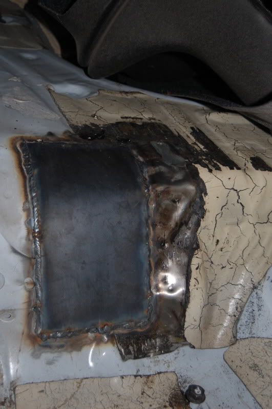

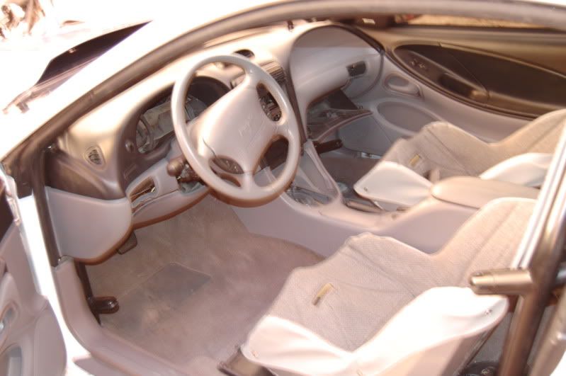

and you could put the back seat in the car with the tq box reinforcement bars.
this pic shows the plate mounted to the area of the tq box. then a standard reinforcement plate was mounted on the underside, drilled through and bolted down. also welded the seams on the bottom side
this pic shows the lower bar that ties into the main hoop to support that plate which braces against the tq box. the lowers were simply boxed in and welded up. you would just have to cut and form the foam underneath to channel over this bar.
not trying to show my car off. but here's more pics to show you what i got for the install. just find a reputable shop and talk with them about your goals, needs, and wants. i'm extremely happy with how mine came out. just be patient. it takes time, haha
i did the finish work myself. he cut a lot of the aluminum big for me, then i trimmed and put it in place after some other work was done. but here's the other pics to show the fuel cell and how clean it ends up afterwards

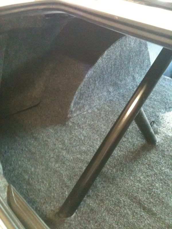

I have mine going to upper tq boxes with seats installed. U have to work a little to get the lower seat in but it works!! Can't sit ur buddies back there anymore but. Lol

Thats dirt cheap for all that work! I was quoted $24-$2800 just for a chrome moly 10 point with one swing out here in FL
Luckily I saved a TON of time and money by trading my roller and cash for a roller that is mini-tubbed and 25.2

i know i got a great deal. the chassis guy was a friend of a friend. so he helped me out. but i also stripped the car down to nothing before i brought it to him. so that saved money as well. he just did his work and i put it back together.
took the glass out
every bit of the interior minus the dash
fuel lines out
all exhaust
motor, trans
it was just a rolling shell when i dropped it off

Yes I'm definitely concerned about the torque boxes. I have the reinforcement plates installed. Just bolted in, not welded yet. What's the best way to strengthen the area?
I'm thinking weld all 4 plates to the floor pans, run bars from the main hoop to upper boxes, weld the seams of the boxes from under the car. What else?
And I have a brand new set of MM full-length sub frames. Are these decent enough? Not thru the floor but they're plenty strong.
These are what I have:
http://www.maximummotorsports.com/st...roducts_id=585

5LF,if you plan on keeping the car for a while why take a short cut and get
something that will more valuable to you. I had a custom cage installed with
duel swing outs,certified to 8.50 When I had the area behind the front seats
done the seats will go farther back for more leg room. Something you may not
get with a cage kit.Also some seats interfere with some cage kits.
Uploaded with ImageShack.us
