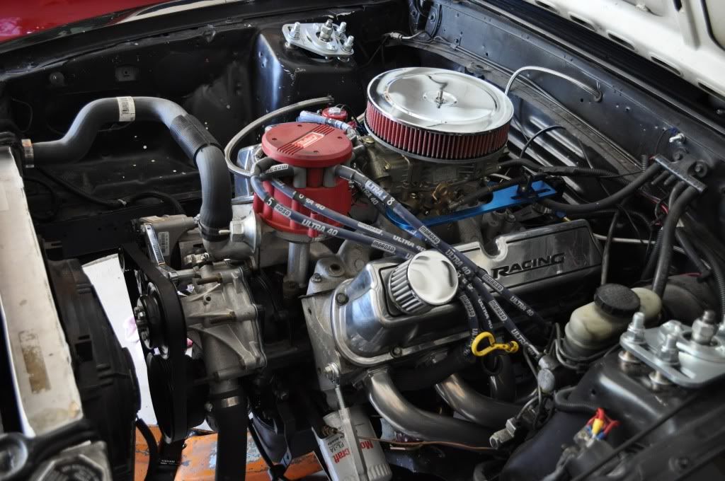

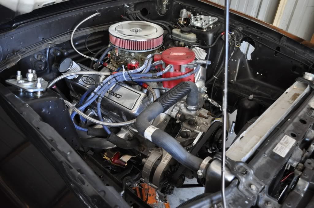

I am looking for ways to get more travel out of my Strange 10 ways. I am using a 12" 170# spring and I have posted a pic of it "unloaded." I am going to change them because I think they are too heavy. 130# 12in springs are too soft so I guess that leaves me with 150s. Do you guys think 12" or 14"?. I know the 12" settles quicker, but does a longer spring help transfer weight better?

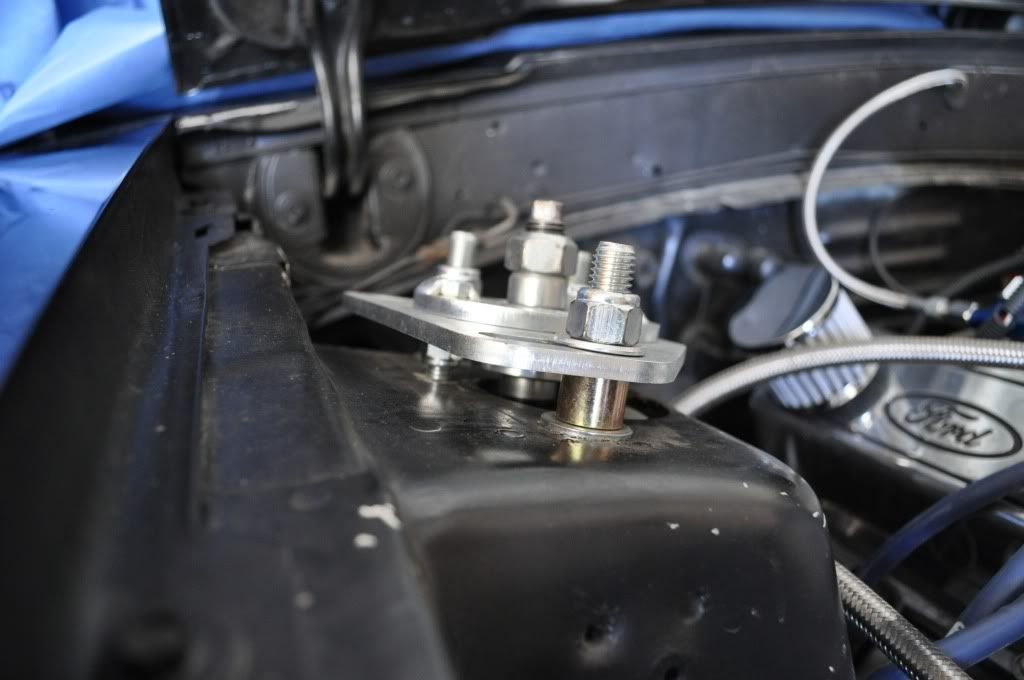

Also, do my CC plates look like they are pulling too much of the strut into the engine bay? Anything else I can do for more travel? I am thinking of cutting the bushings down. Bad idea? Open to suggestions
FWIW I am also using Team Z relocated uppers, double adj lowers, 4.56 gear, 255/60 MT DR, and a footbraked C4.

What brand CC plates are those? Installing the bearing plate between the shock tower top and the main plate will gain a little. The spacer bushings look a little thick as well. The factory front control arm bushings are inherently "binding" which will slow down the rate of travel. I like my 12" 150's.
On another note, ditch that little air cleaner for the biggest one that will fit. Just my .02$.
Lol that IS the biggest that will fit under my stock hood. I just take it off at the track.
The CC plates are QA1's. I flipped the bearing plate, but I didn't think to put it under the main plate. Looks like it might hit the shock tower though. I'll look at it. Thanks for the idea

Id try a 12/150, also I would cut the spacers on the caster and camber plates, they look very long!

Springs have nothing to do with travel. Ride height and the strut mounting are all that control that.
Go with what Dave recomends. CC plates deff need some mods to work better

I have started modding the plates. I removed the welded in bolts (nice) in the hub, and installed it from the other direction so the hub can be put under the plate without hitting the tower. I also cut the spacers down on a lathe. 12" 150# springs are on order. I don't know why they made these like this; I installed them as per directions, and I had less than 3" of travel. I think that combined with the dump truck springs were killing me. Hopefully it works out. Thanks everyone!!

Forgot to add, it looks like the CC plate mods gained me 1 1/8" of travel if anyone is looking to do it.
