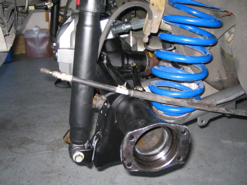

I have bracing being done on my rear this week. I will post some pictures afterwards. Doing something similar to the UPR kit on the back, and some bracing on the bottom. I still have 31 spline axles w/ 9 inch large bearing ends and an Eaton in a car that I'm working downward from 9.5x area. Racing in true street I'm dodging the spool.
