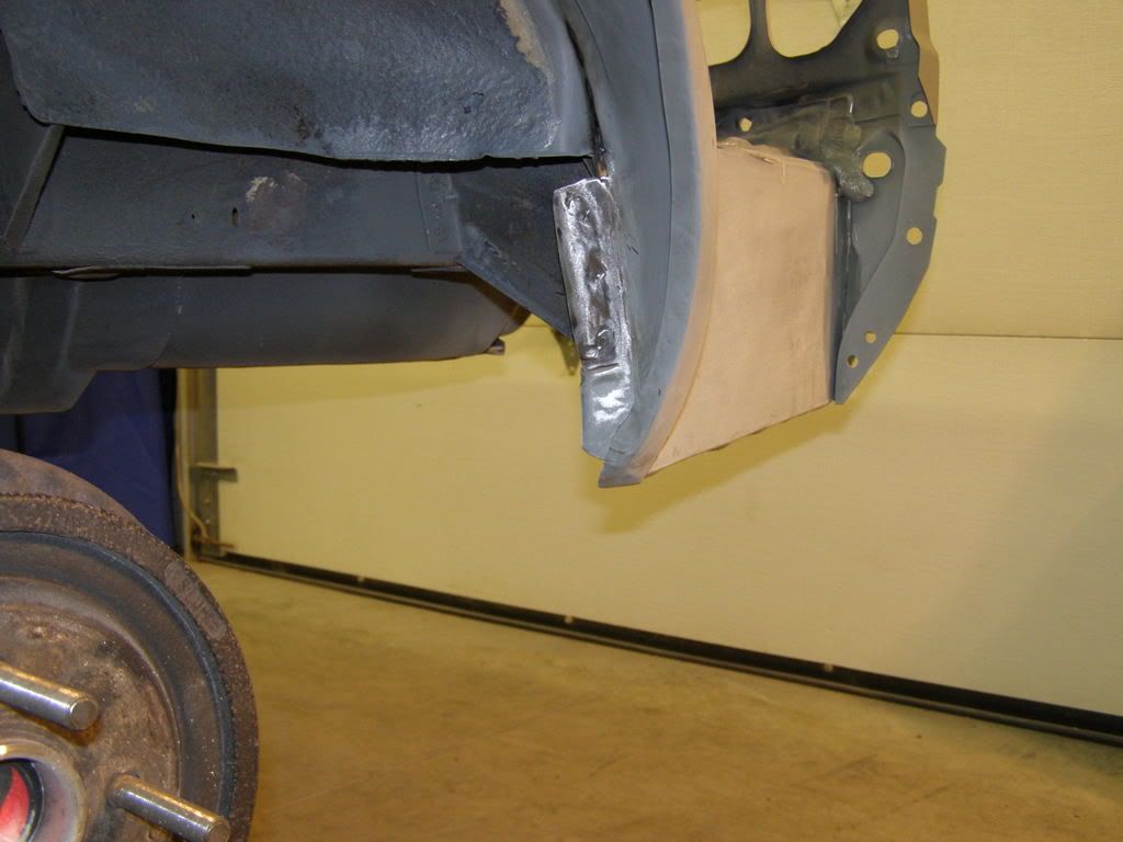

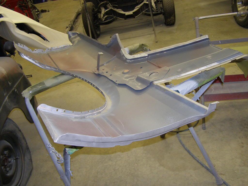

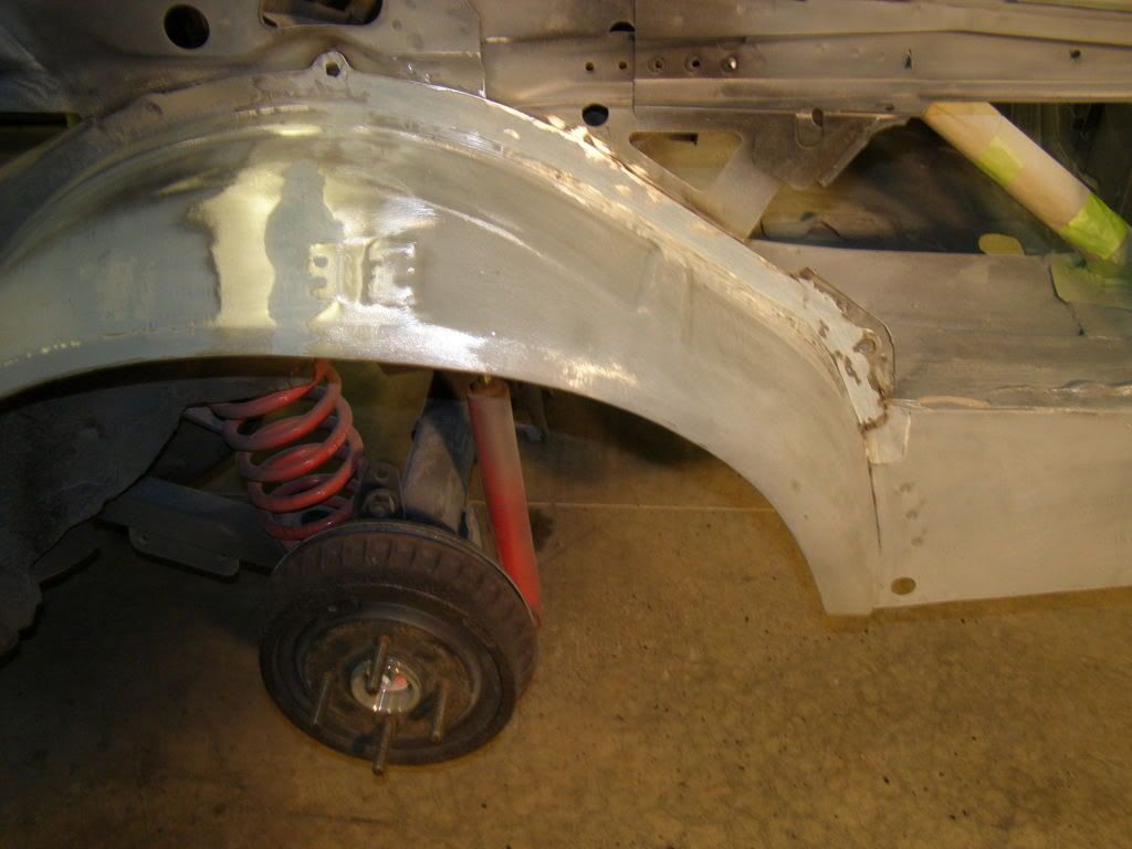

Sorry guys...been busy getting UPS to get there AZZ in gear and give me a refund for the damaged quarter, and now I am fighting Jay n Sons Mustangs Inc and DHL to get there slow asses in gear and get the cowl panel HERE!! Its been two weeks now....I know the weather is bad, but MY GOD they are in NY and I am in Ohio!! Anyhow....I just think its funny how much this car keeps testing me. But as you can see, I am not stoping short of making a BADAZZ ride!!! Enjoy these....I wish I would have started a different car from the beginning, but I had no idea it was this bad till it was to late to turn back. So let this be a lesson to others....buy the nicest, cleanest, rust free car you can in the beginning!!
Half an outer wheelhouse was cut off the new quarter I got from Georgia and rewelded on my car! Grinding the rolled weld seam of the inner and outer wheelhouse is NOT FUN!!
Inner view
Inner structure view after duraglassing the welds (just to be safe)
After I shot PPG DP90LF epoxy primer (was going to use dp40lf, but black just looked better) and POR15 doesnt stick to well to nice clean metal!
The new quarter after being skinned out (PITA) and it is in the process of getting the egdes and so on sandbalsted and ready for epoxy primer
Basically....its been a century so far, but being young and poor....this caliber of a project is taking longer, and because I am probably to picky...and a little inexperienced at knowing what I can get away with. But I would rather be safe than sorry. And having to borrow tools, shops, welders, materials, and so on is getting old too!!!
