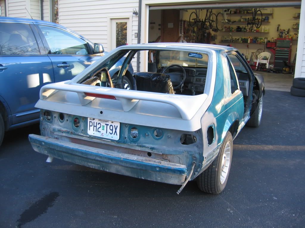

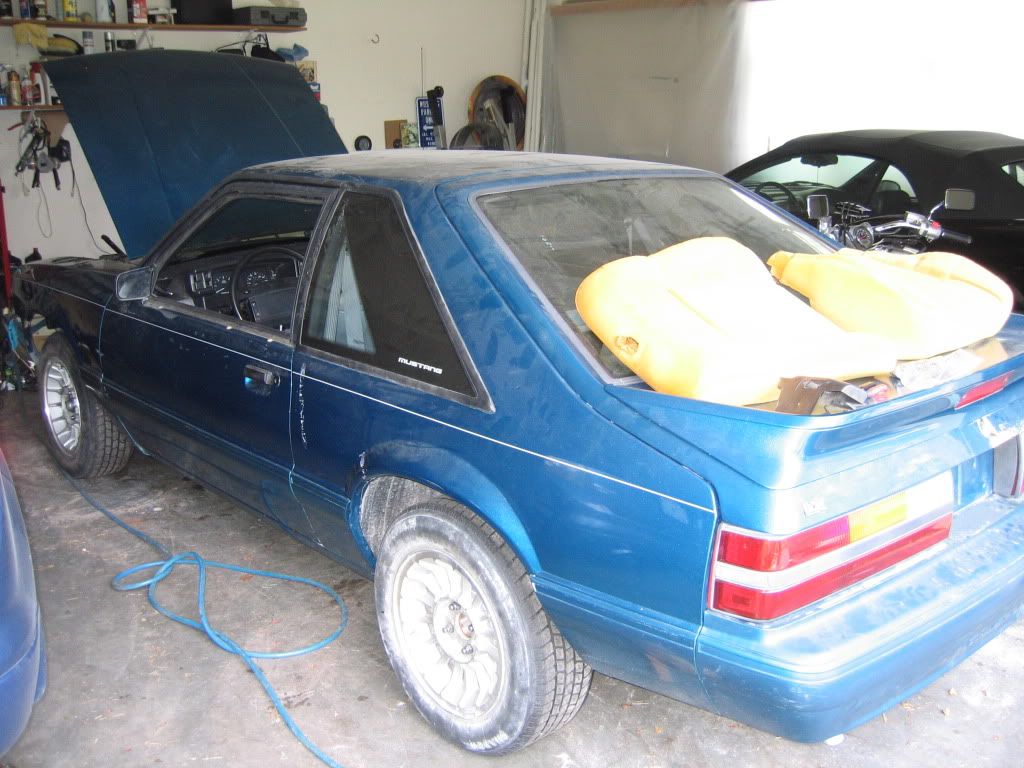

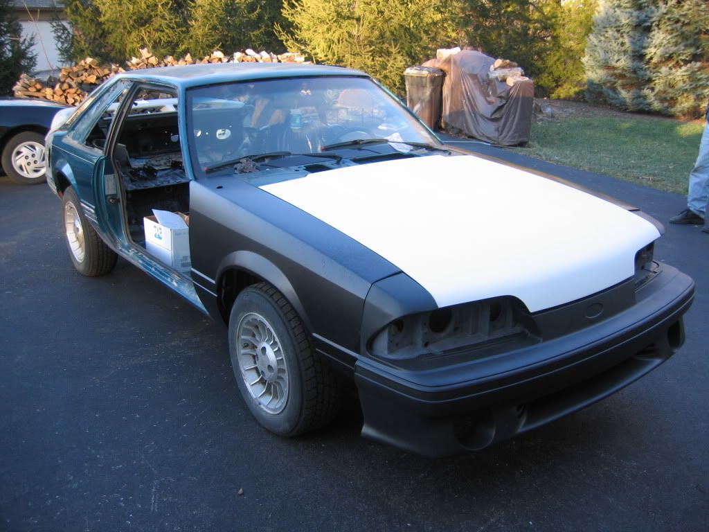

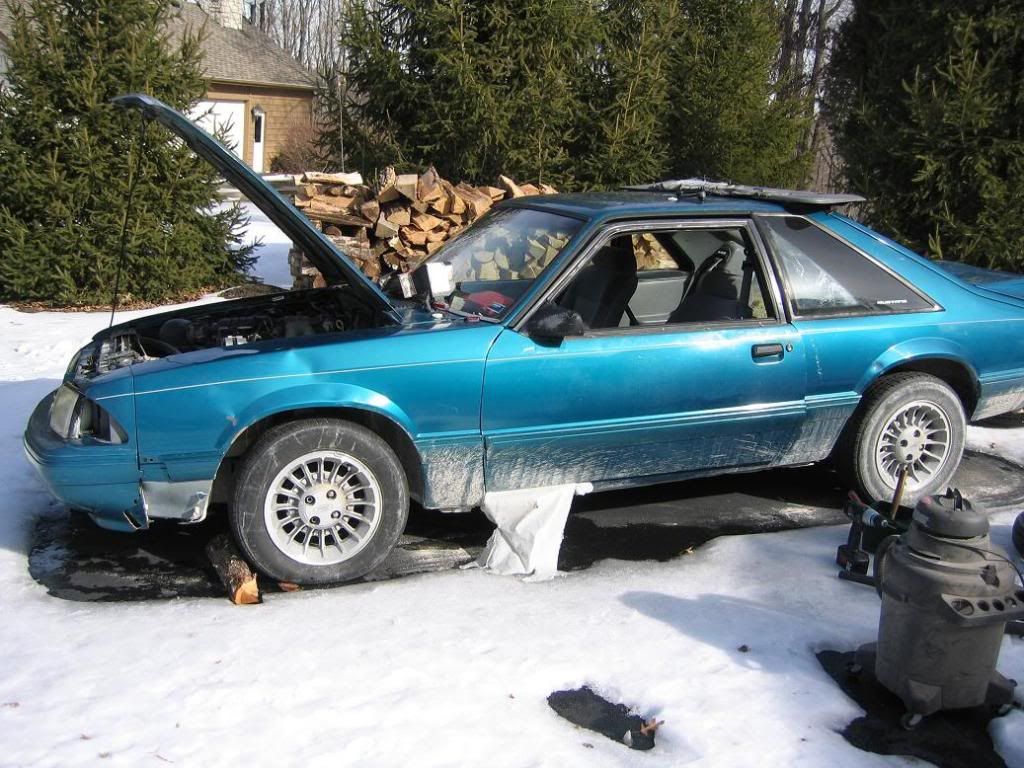

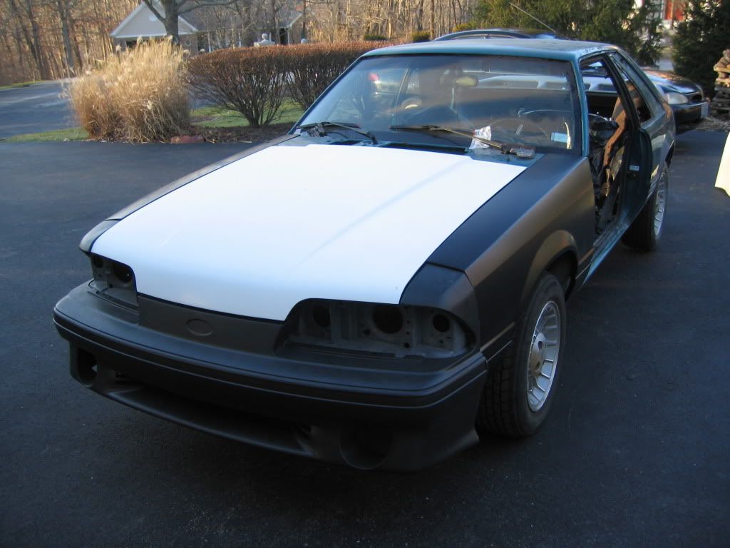

Early February. Giving the new ride a first look. Not too impressive. Needs a windshield, and the driver's window isn't opened, it is missing!

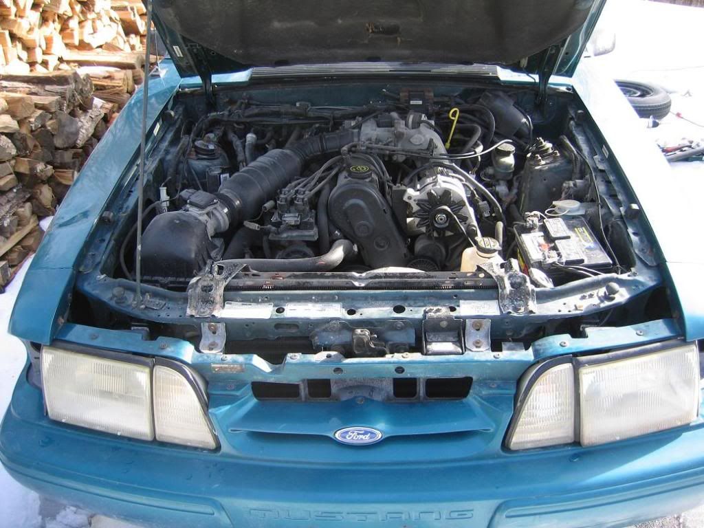

All 105 HP out of the 18 year old 2.3L Four Cylinder.

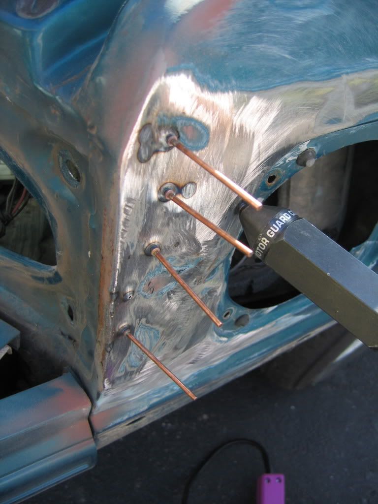

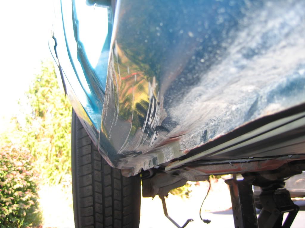

Left front fender apron damage. Looks like a minor frame pull is in this car's future. No biggie.
Left front fender area. Probably going to need both fenders. New lights are ready to installation in the future.

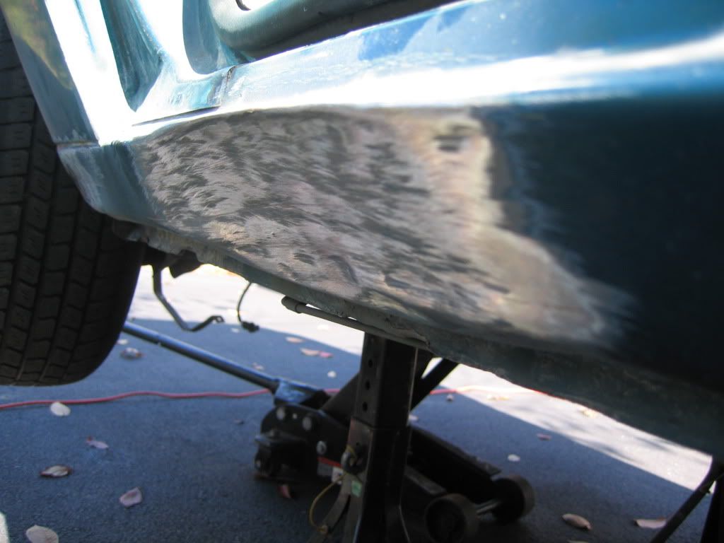

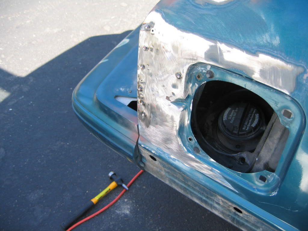

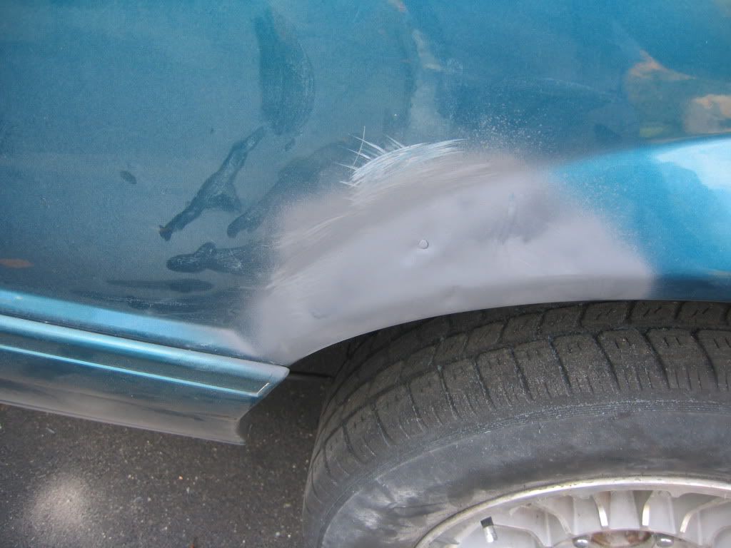

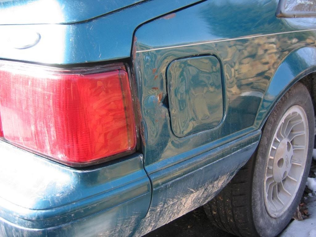

More damage! Going to need a little pull on this quarter panel. New gas door is going to be needed.

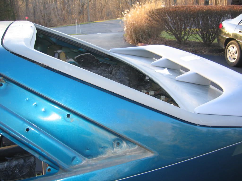

This hatch is wasted. Fiberglass will replace this rust prone hatch.

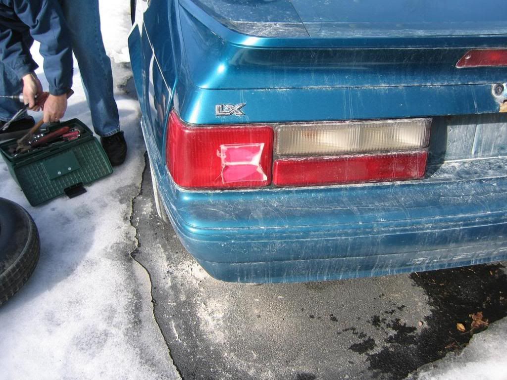

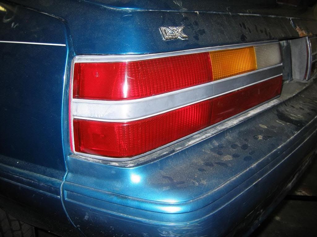

New tail lenses on the way.

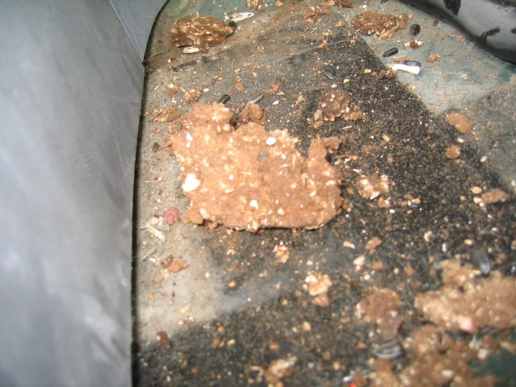

I usually make it to the toilet before I take a dump. I guess the people who owned this car weren't quite as good

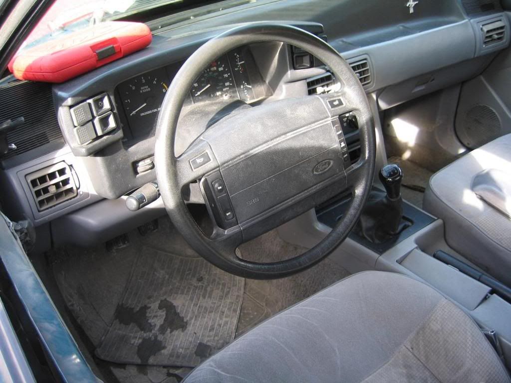

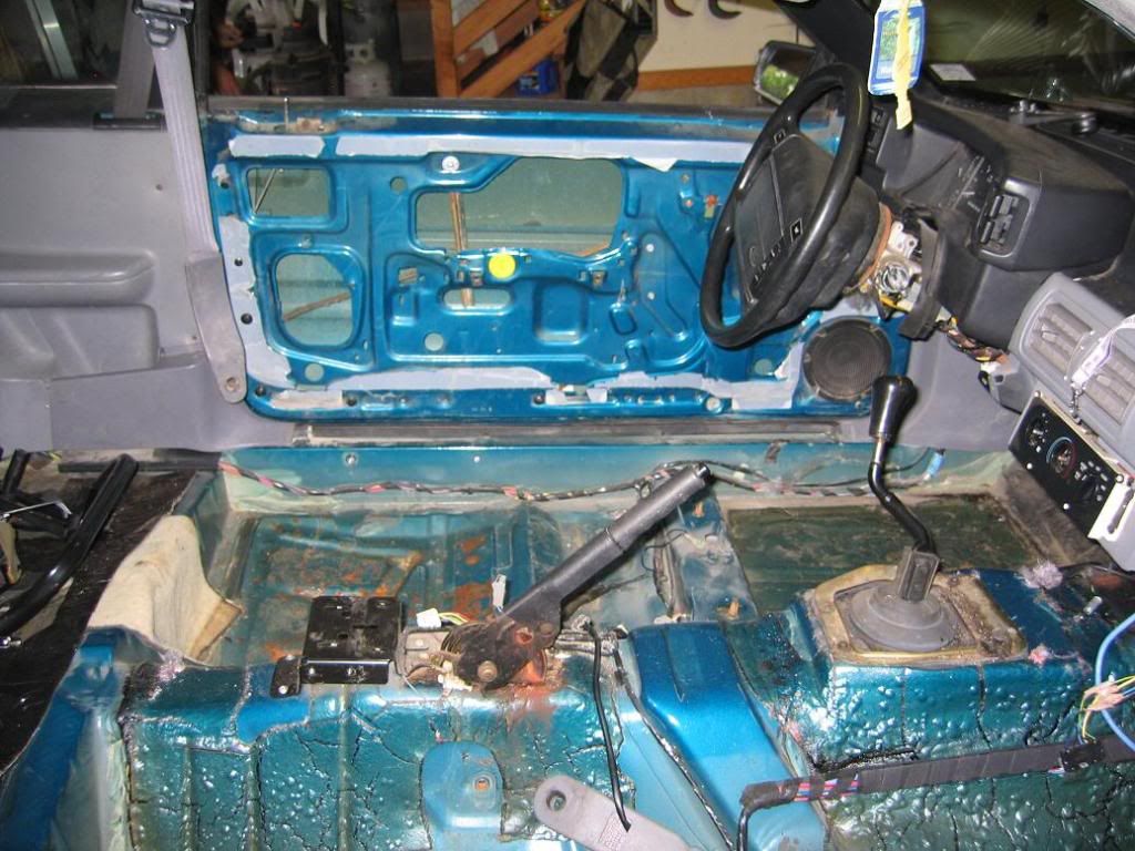

Interior... needs a "good cleanup" to say the least. New carpet, seat disassembly and cleaning, and a new headliner should bring it back nicely.

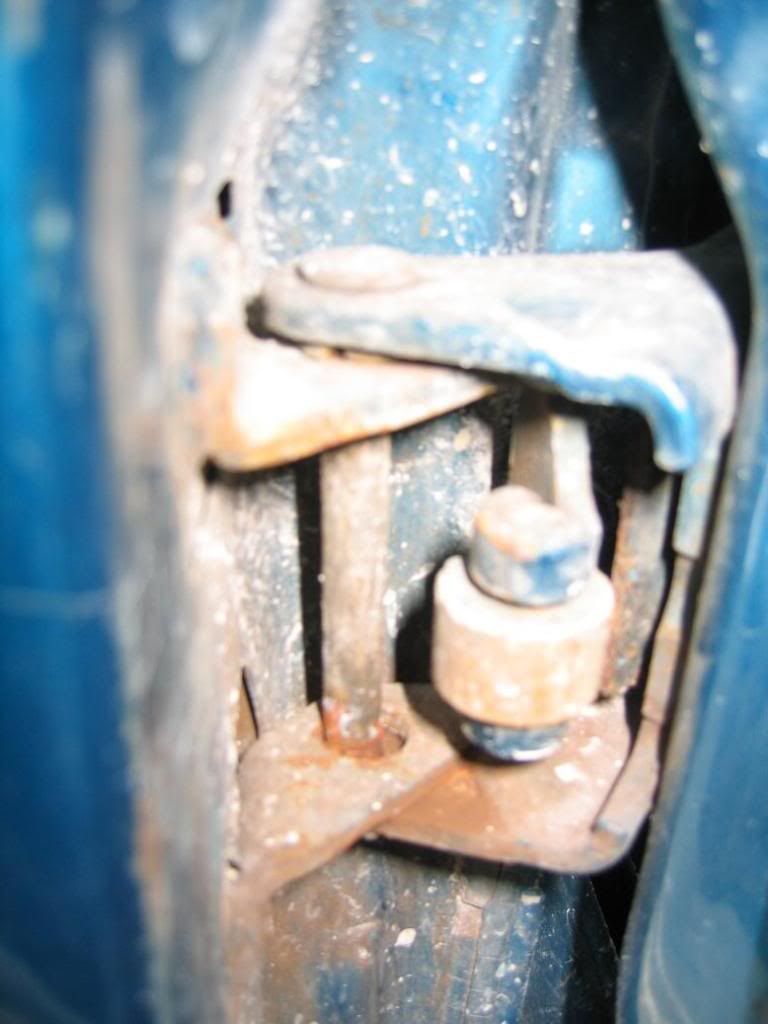

Door hinge kit on the way. Can't close the door without lifting it up, as it hangs down about a full inch when opened.

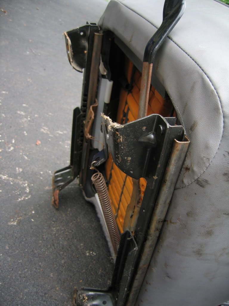

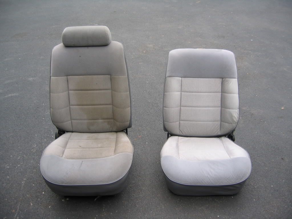

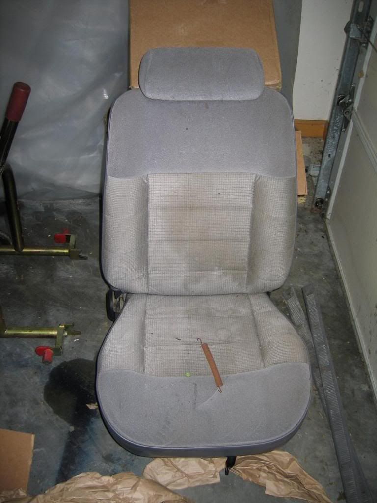

That's the driver's seat! Looks pretty different without the foam cushions and cloth seat covers! This one is getting a couple of new welds to fix the "gangsta lean" these cars are known for.

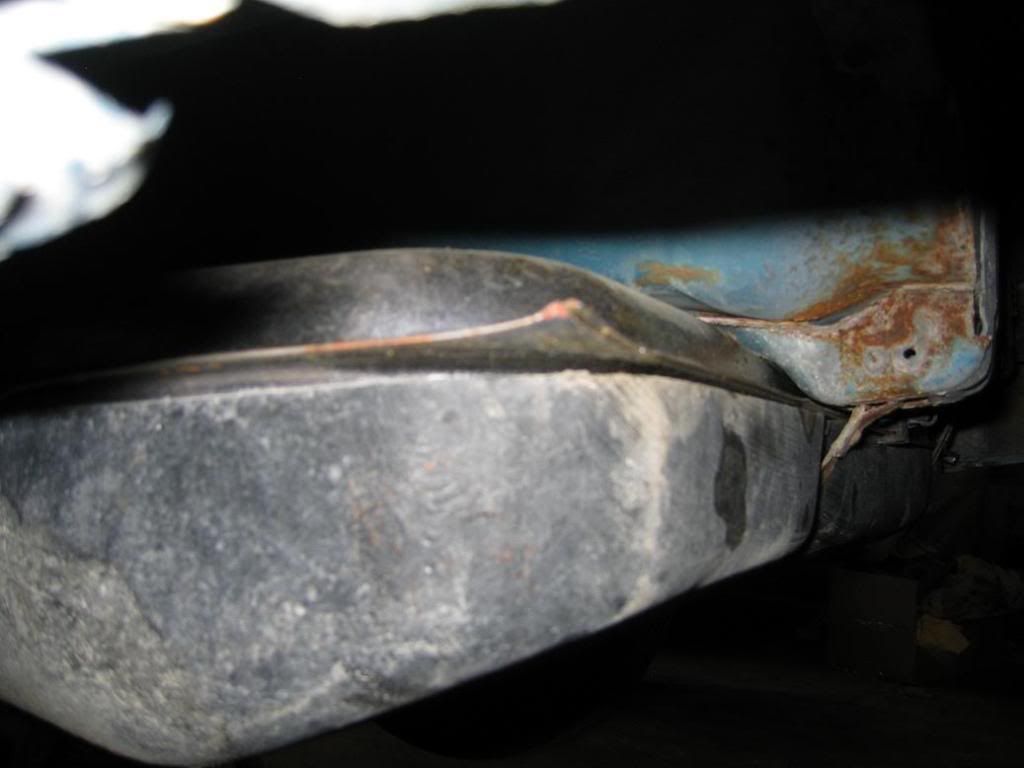

New fuel tank, housing a new fuel pump. Previous owner damaged the last tank so that it was leaking.

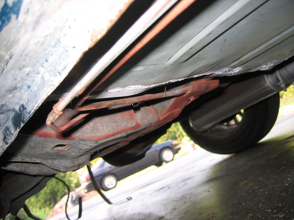

New parking brake cables. They were frozen, and had the rear brakes locked on. Car has brand new front rotors, calipers, pads, front wheel bearings, rear wheel bearings, rear shoes, rear drums, and brake hoses all the way around. She'll stop

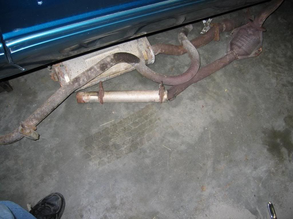

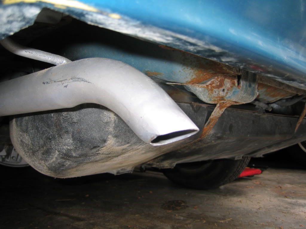

Brand new exhaust on the way. Could probably save some of this, but... nah.

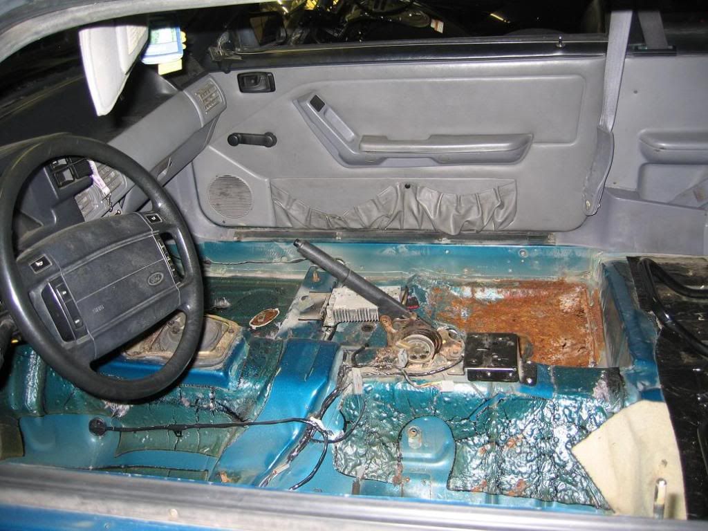

Interior is looking a little different these days!

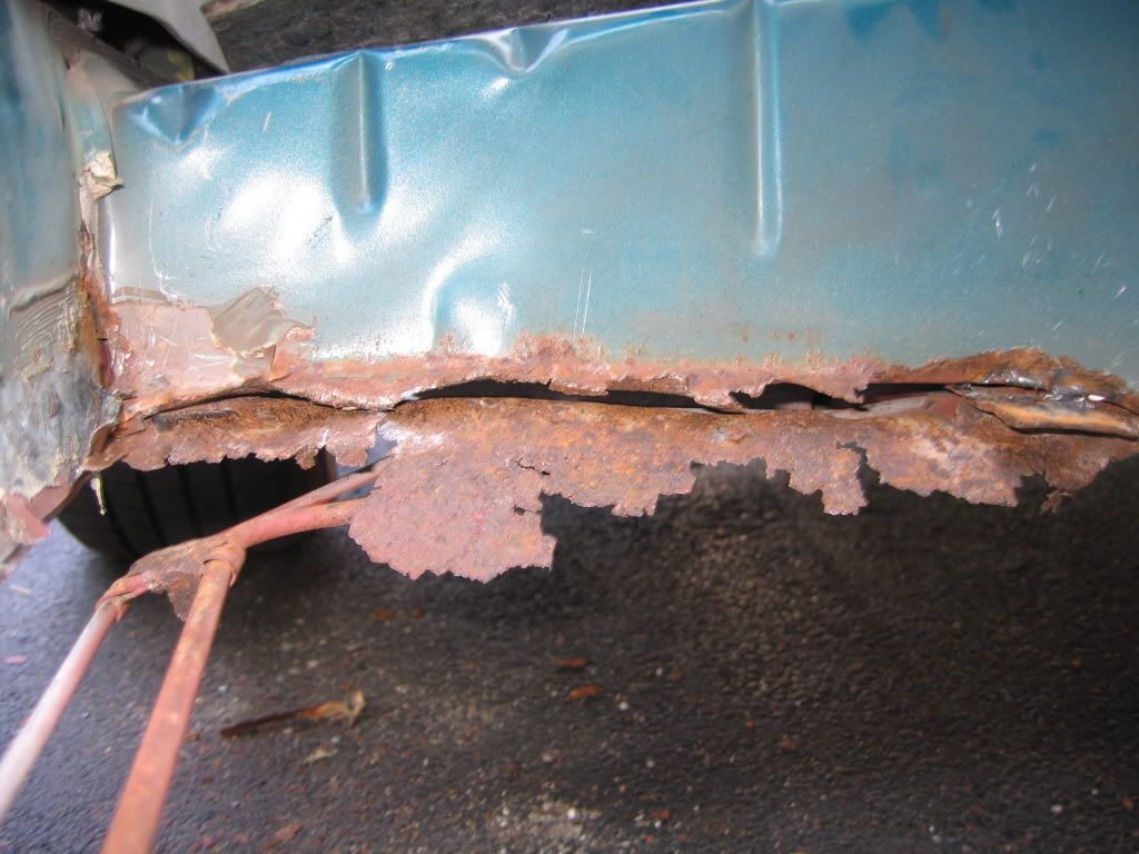

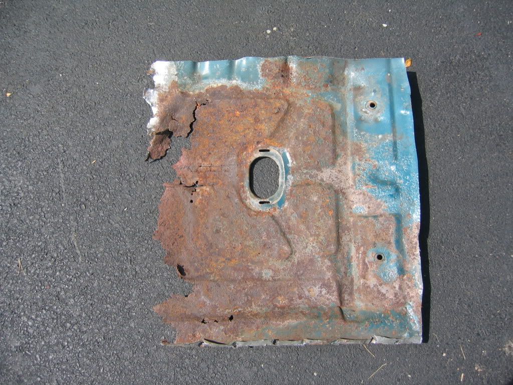

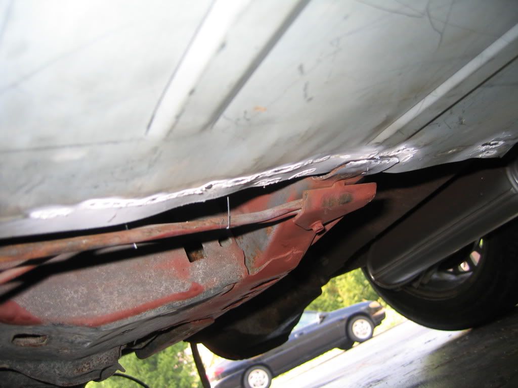

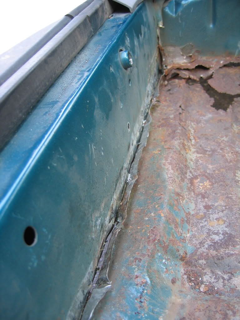

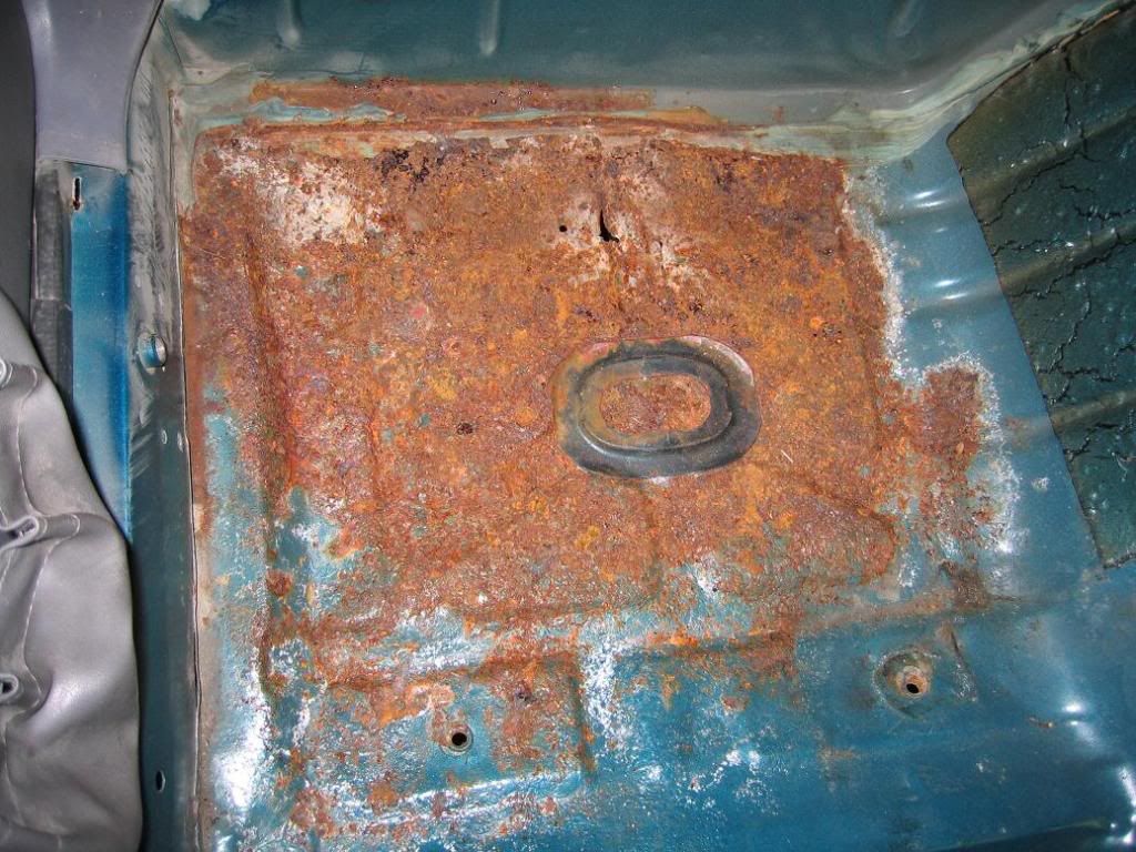

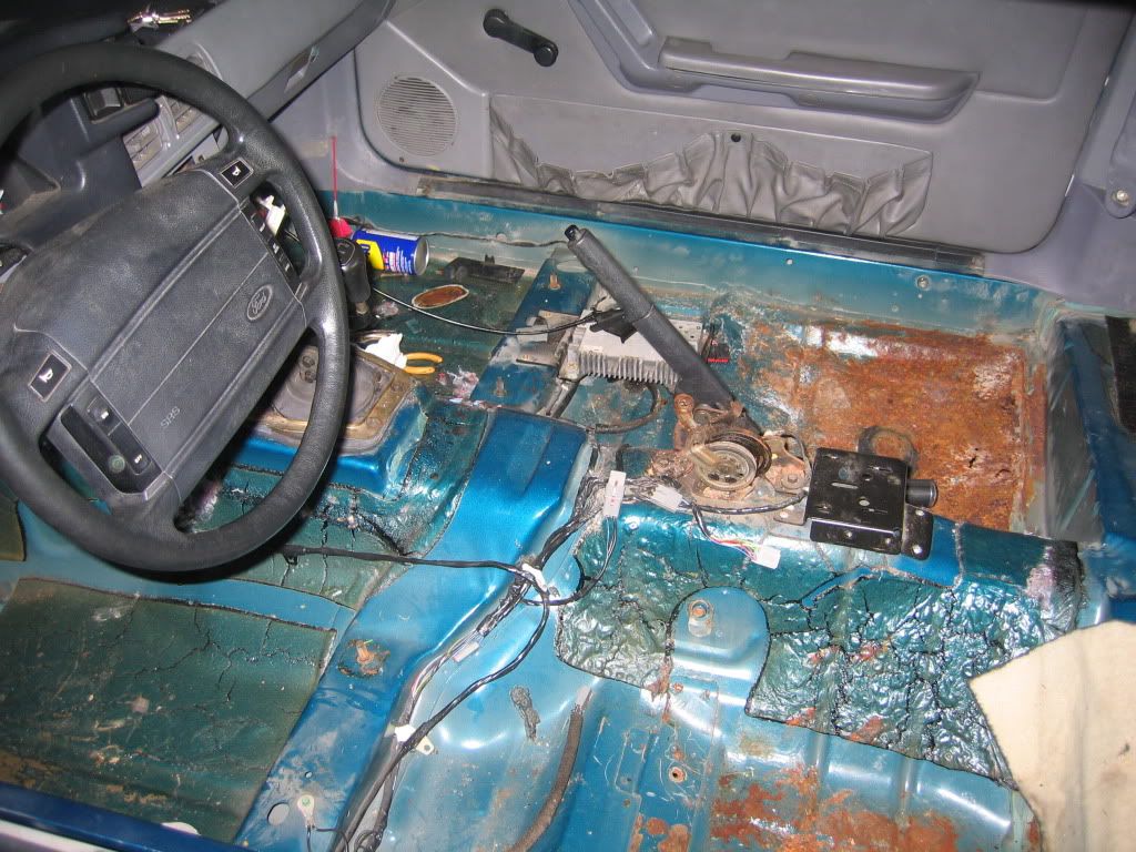

Passenger rear floor pan is... uh... rusty! Cutting and welding on the way!

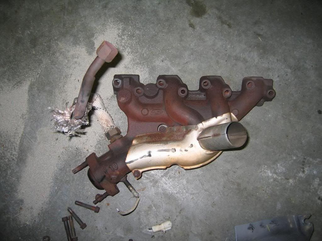

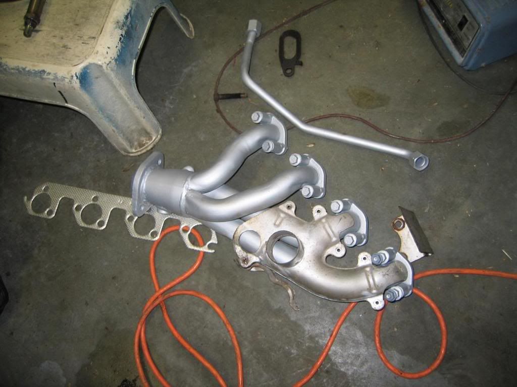

The old exhaust manifold. Ditching the heavy, no flow POS for a Ranger tubular piece.

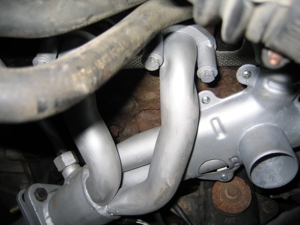

Ranger header looks nice with the new paint. Quite a bit lighter than the stock junk.

Another shot of the interior. Still a long way to go here!
Okay, what the hell did these people do in this car? You know what, I don't want to know. Seats are disgusting.

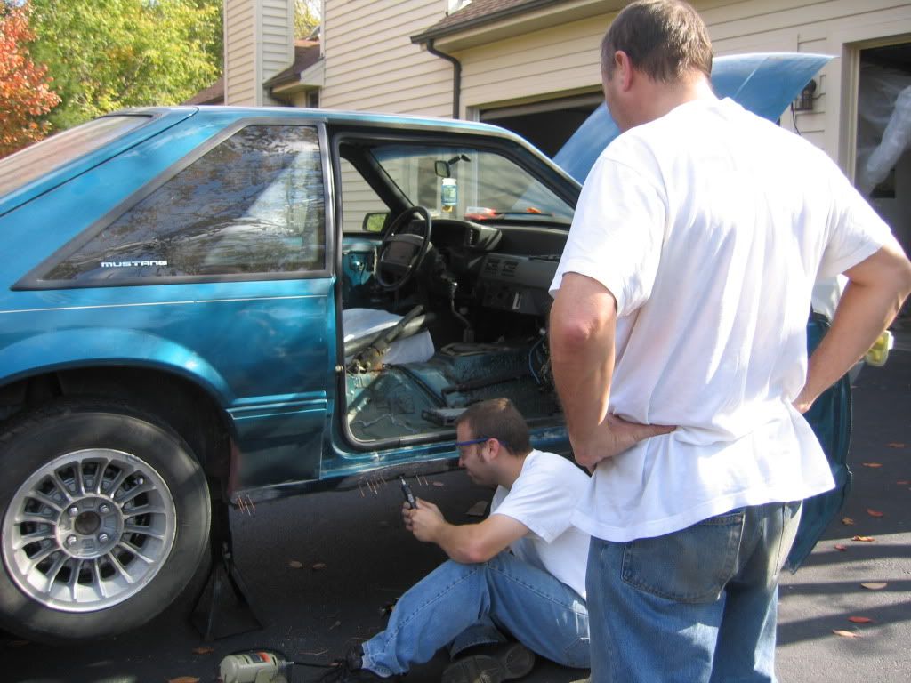

The fearless. Me on the left, my Dad on the right.

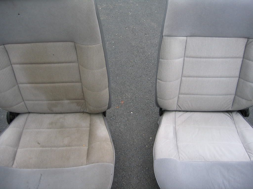

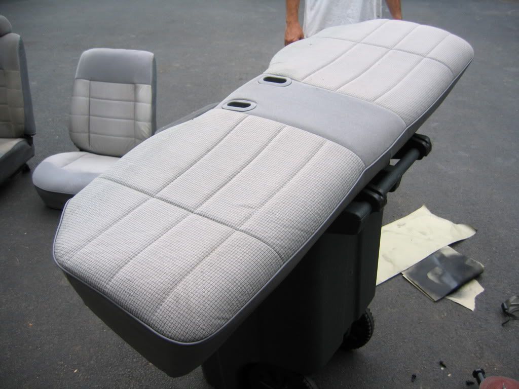

Washing out the seat covers after they are removed. Yum!

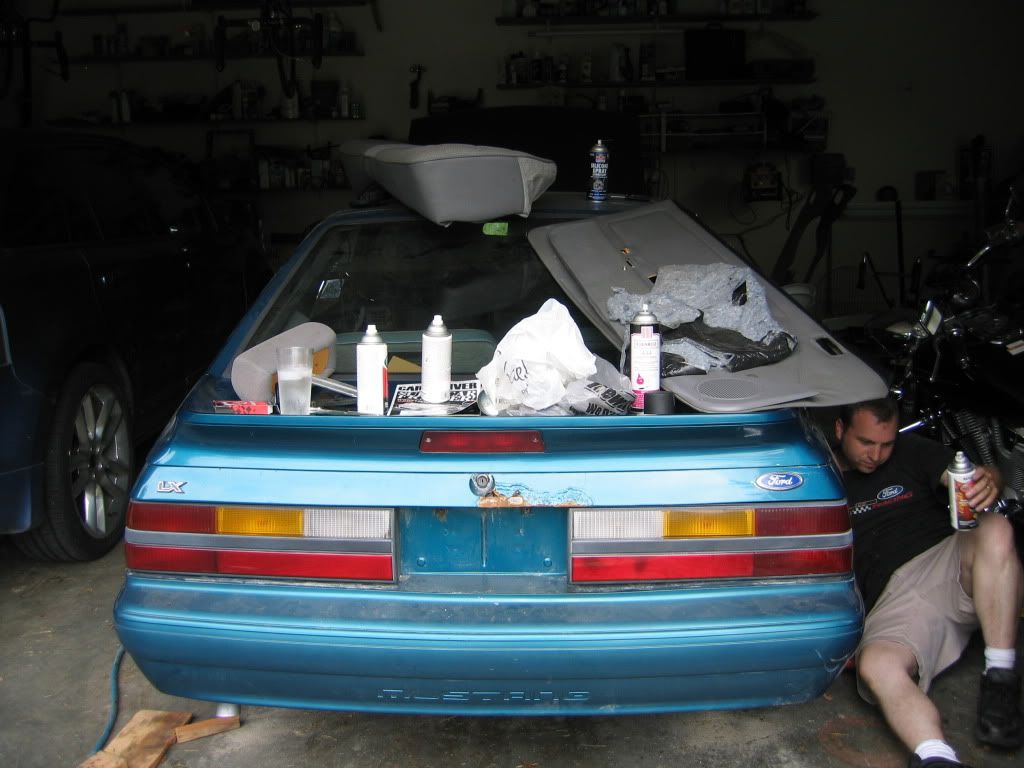

Sorry, no body work stuff yet But, here are a couple more pics from what we have been working on!

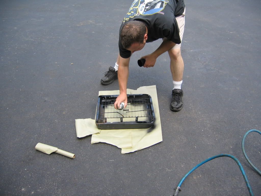

Painting the seat bottom

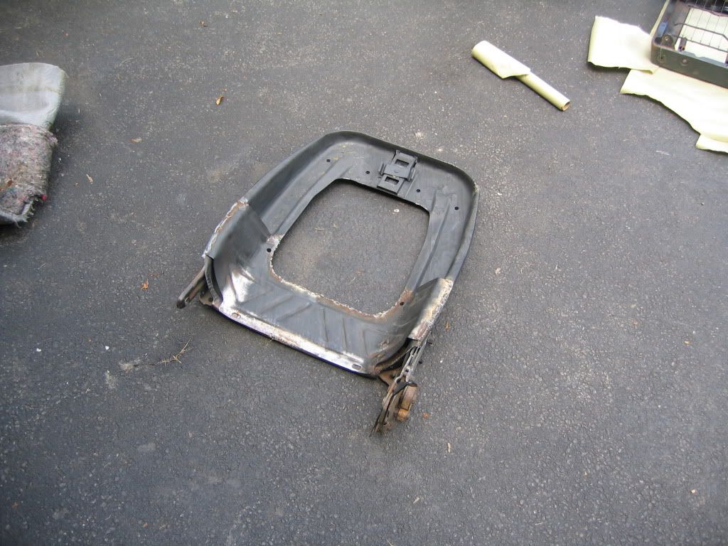

Driver's seat back welded and ready for paint
Seat foam ready to be cleaned
Driver's seat (cleaned) compared to passenger seat
Junk on the trunk
Interior still looking rough

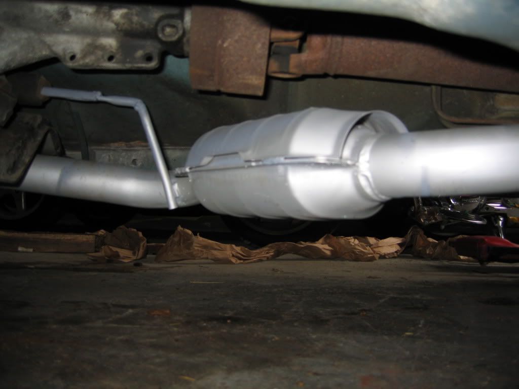

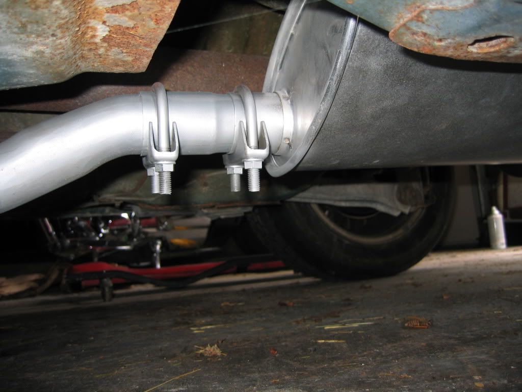

New exhaust finally installed...

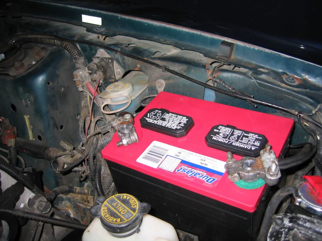

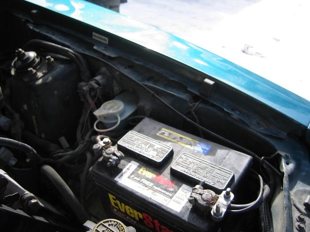

New Battery
Ranger header installed!
New striker bushings installed!
Back seat cleaned and reupholstered

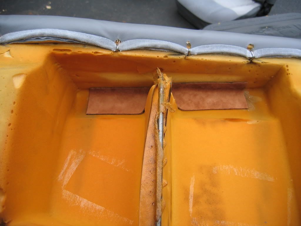

Torn seat foam reinforced with leather backing

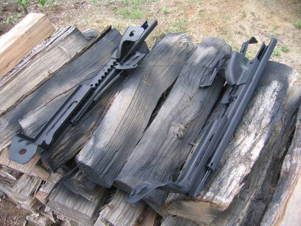

Driver's seat tracks repainted
Passenger seat tracks in original condition

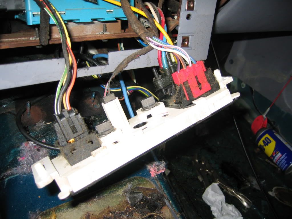

The blend door wouldn't operate properly because the cable was frozen. Working on lubricating and freeing up the cable. Might just have to replace it.

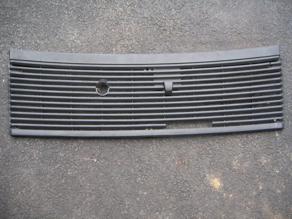

Cowl Vent panel is damaged. Going to have to get a new one it looks like.

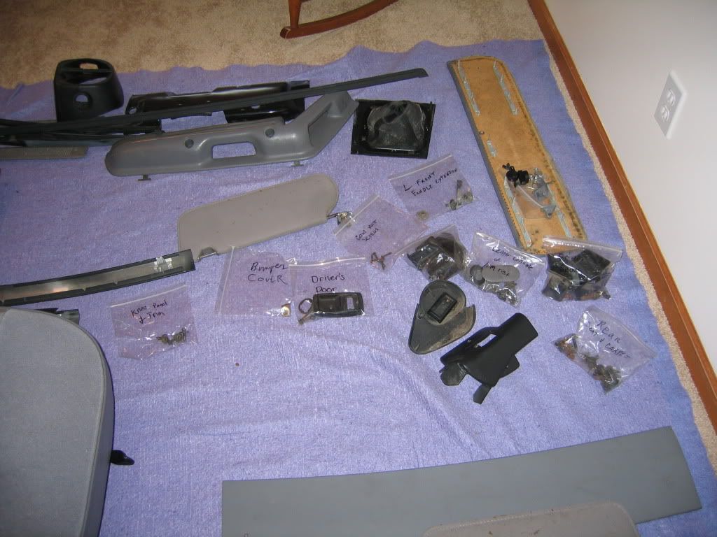

Bags of stuff from the interior and various assorted parts.
Passenger seat all cleaned up and ready to go...

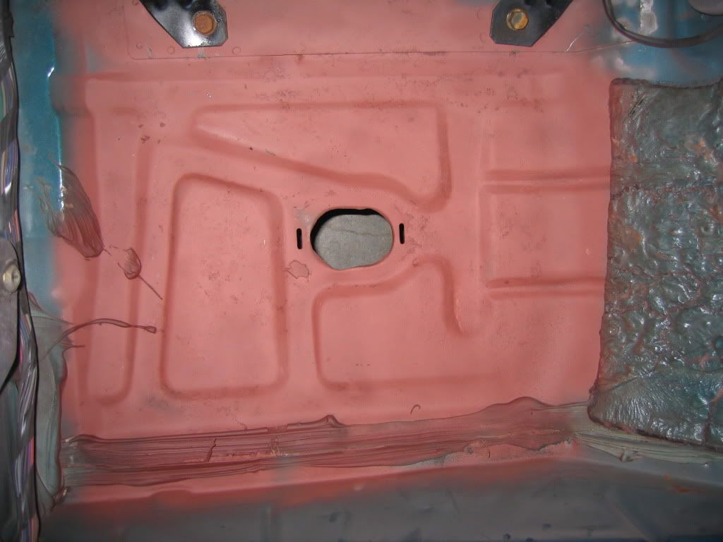

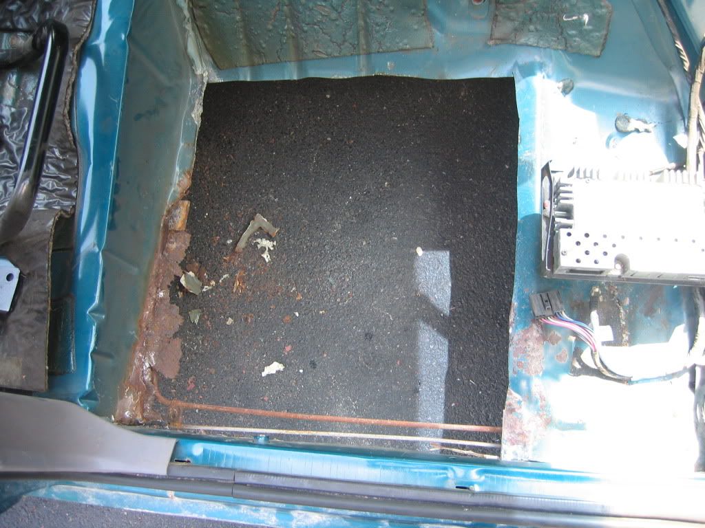

Driver's side rear floor plan sandblasted and primed.
Ready to cut out the rear floor and install a new one. It still looks awful right now.

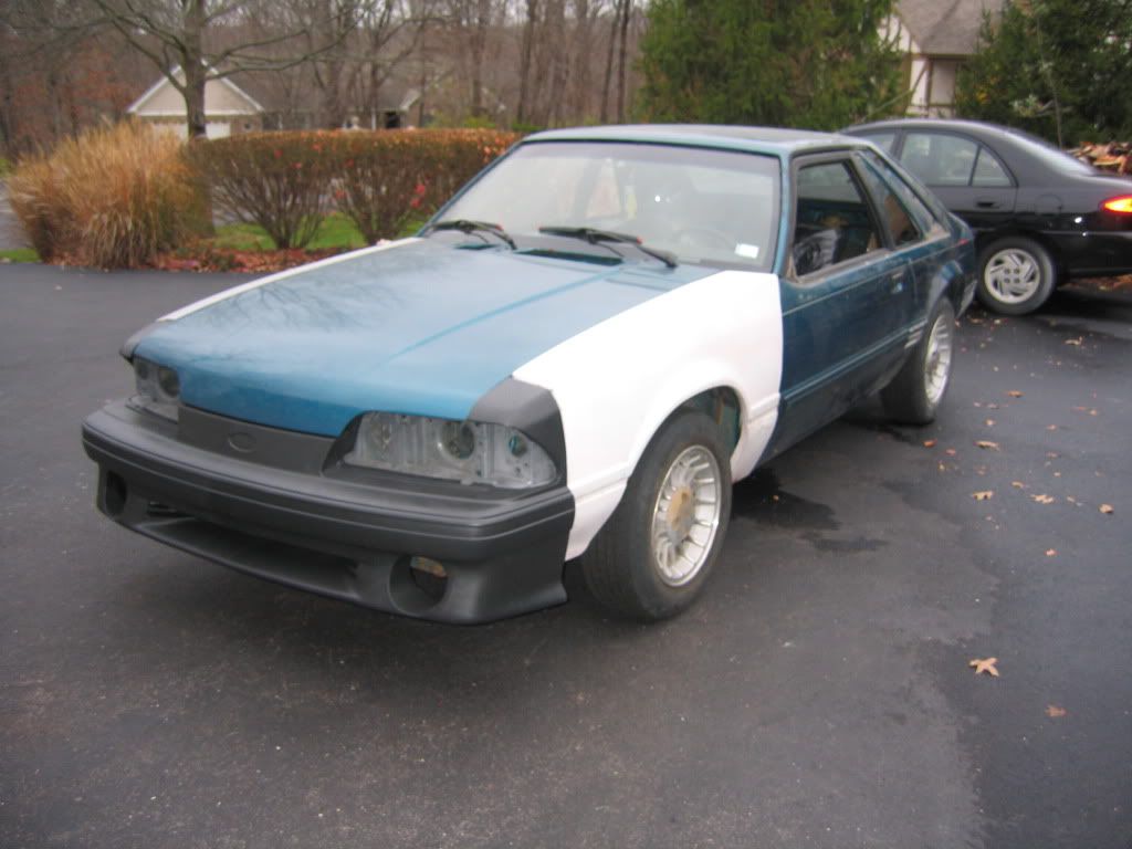

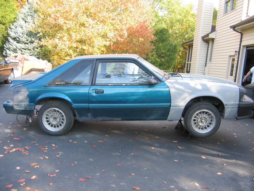

The car as it sits right now. The frame work is done. The new fender wouldn't even bolt up before, it is on (loosely) right now.

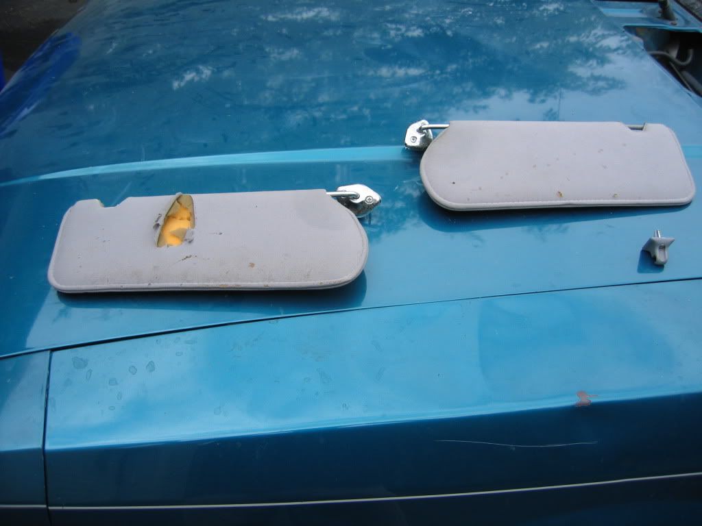

Sunvisors in need of "restoration." They retail for like $170 at LRS with the mirrors, so I am going to see if I can't fix these up.

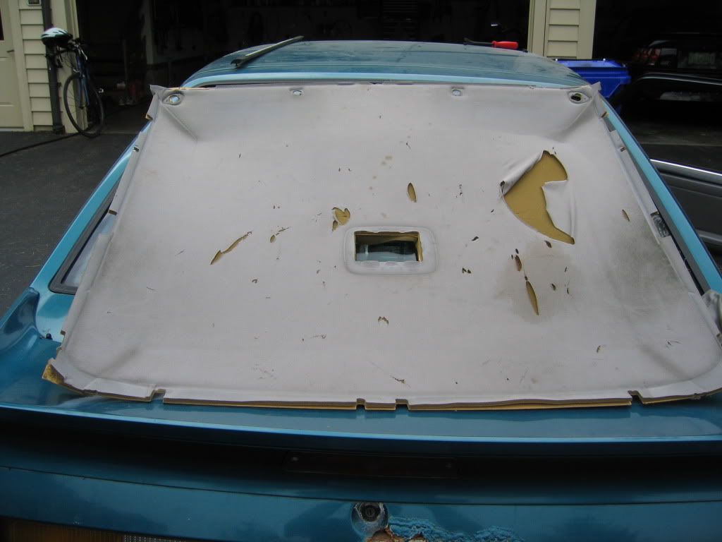

The headliner is wasted. I have actually stripped it all down to the cardboard, but I am waiting until I know if I can fix the sunvisors before I go get new fabric for the headliner.
The roof with no headliner...
Some of the horribly rotted, disgusting old headliner insulation that rained down on my head when I removed the headliner. I think mice actually got up there based on the amount of sunflower seeds.

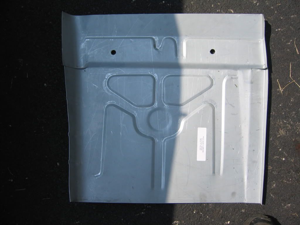

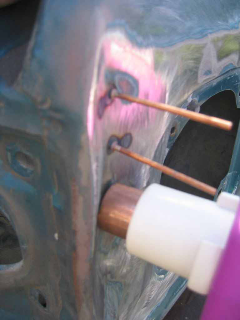

Replacement floor pan from Rock Auto...
Air Chisel beginning to knock out the spot welds on the old pan...
more removal in the works...
And the old POS is finally gone...
Some leftover...
Yabba dabba do! It doesn't stay this way for long...

what did you use and how did you clean those seats? they look great.

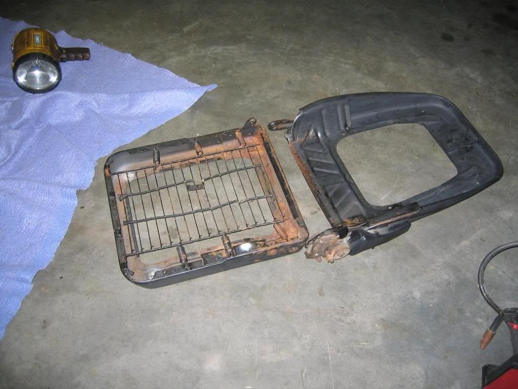

I completely disassembled them, removing all the hog rings and seat covers from the foam, then took the foam off of the seat frame. There is a good write up here...
1986 Mustang GT Build and How To's
Once the seat is disassembled, I wanted to deep clean the seat foam. I filled the bathtub with water, lemon juice, baking soda, and dawn dish soap, and squeezed the seat foam out under the water to try and kill any bacteria and smells that might have been in the foam.
After that, I put the foam out in the sun to dry, squeezing out as much water as I could every hour or two. It takes a couple of days in the hot sun to completely dry, so you want to do it during a couple of hot days in the summer.
The fabric was prewashed in the sink (see picture above) and any stained areas scrubbed with a stain remover for clothes. Once that was done, they were washed in the washing machine and allowed to hang dry.
After that, I just reassembled them. Hog rings suck, that is the worst part about the whole thing.

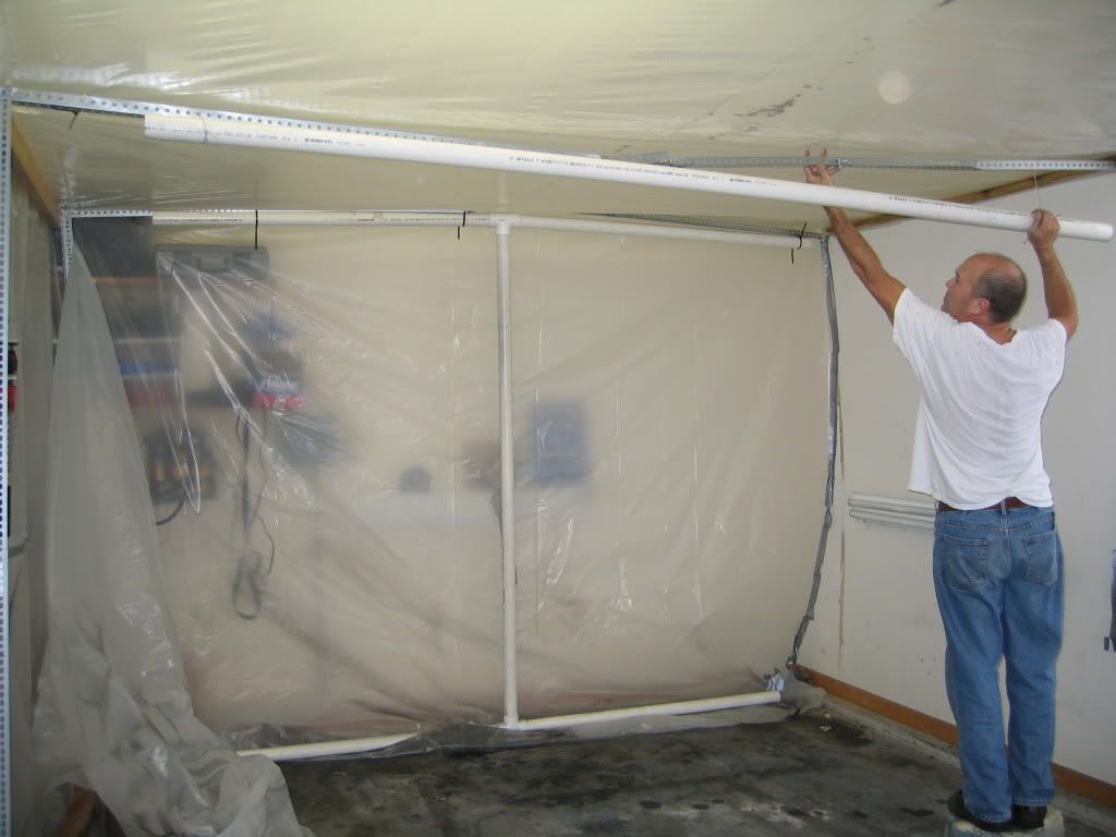

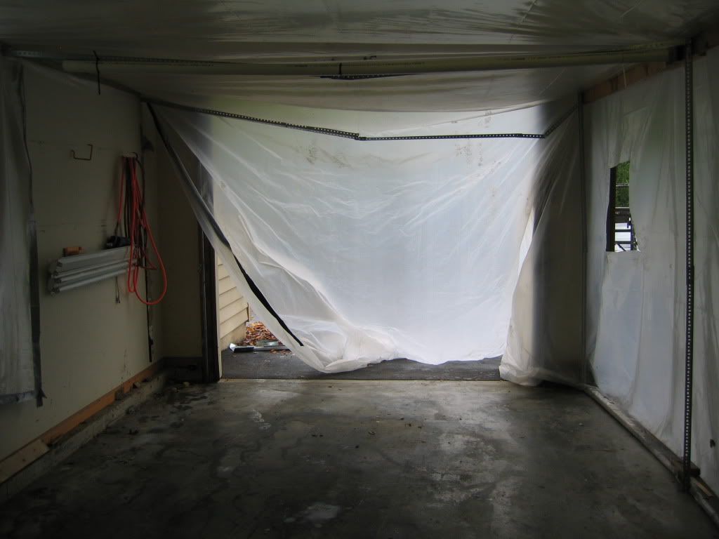

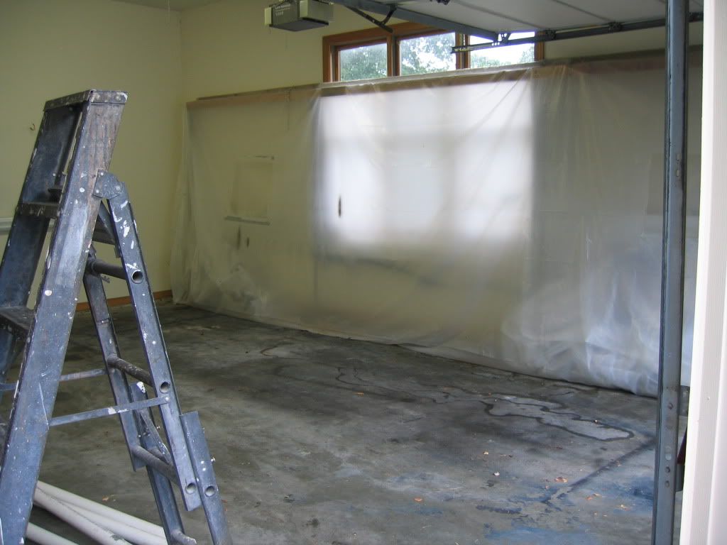

No work on the car itself, but here are some shots from last week when we put up the paint booth.
The booth is already constructed from our previous project of painting my 91 GT. For space saving, it folds to the wall when not in use.
A picture of where the hook holds the paint booth to the wall.
And another of the same.
Top picture of the booth before it is opened.
Once the booth is detached from the wall, we slid it open.
A picture of the booth from the inside. The supporting top beams need to be reinforced at this point.
Installing the support beams.
A picture from the inside.
Picture of the front of the booth.
Clean up work to do.
Picture of Dad's 99 Cobra convertible. It will be seeing the paint booth after my car is done.
Another of his car.
Last one for this week!

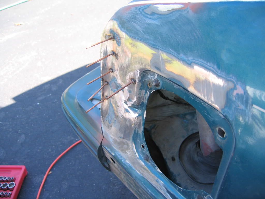

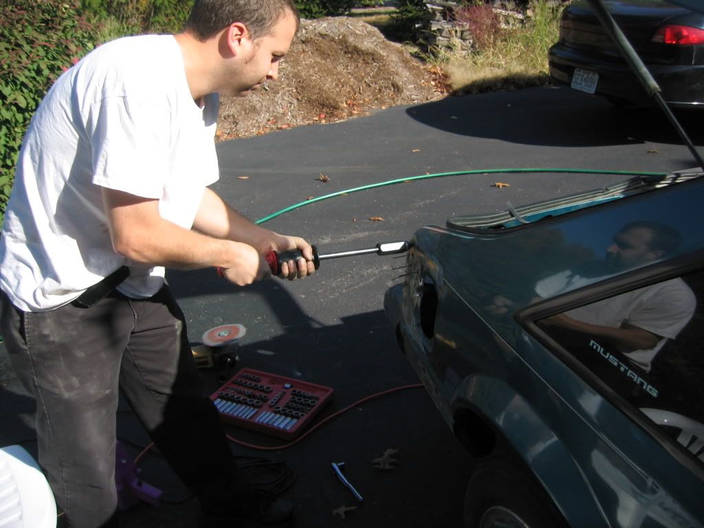

Finally doing some bodywork on my project! Not a LOT of stuff yet, but here is what we've got so far...

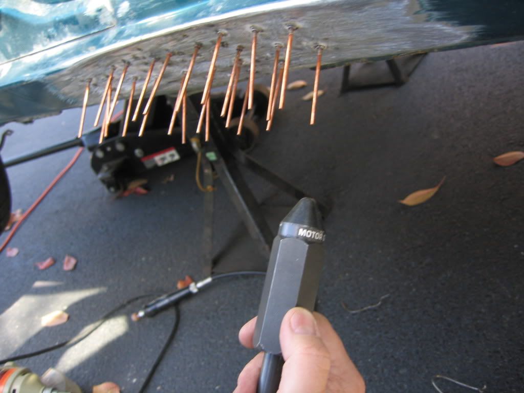

Sanded the paint off of the Right Rear Quarter panel to repair the damage...

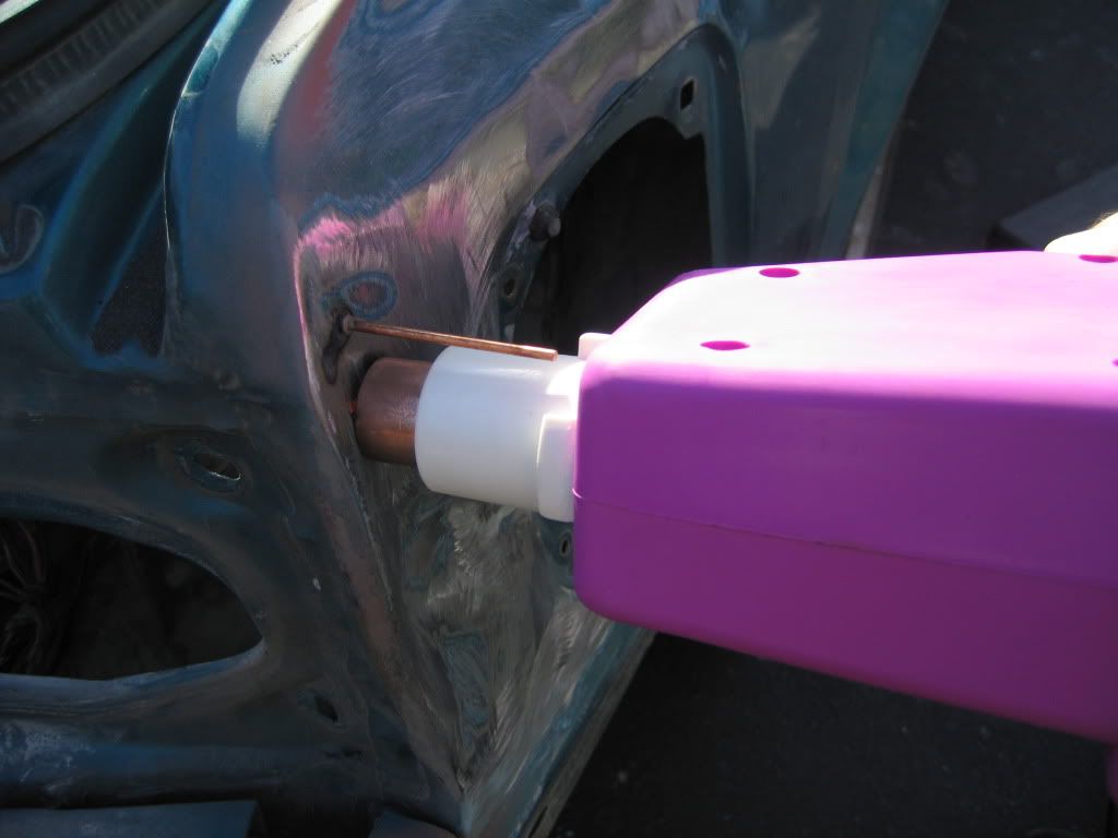

Then attached the pins with the stud welder.
Once the pins were in place, we began pulling the dent with the slide hammer.
Finished the pulling. Two tears need to be welded up.
Some primer to keep it from rusting until we are ready to do the final priming and filling.

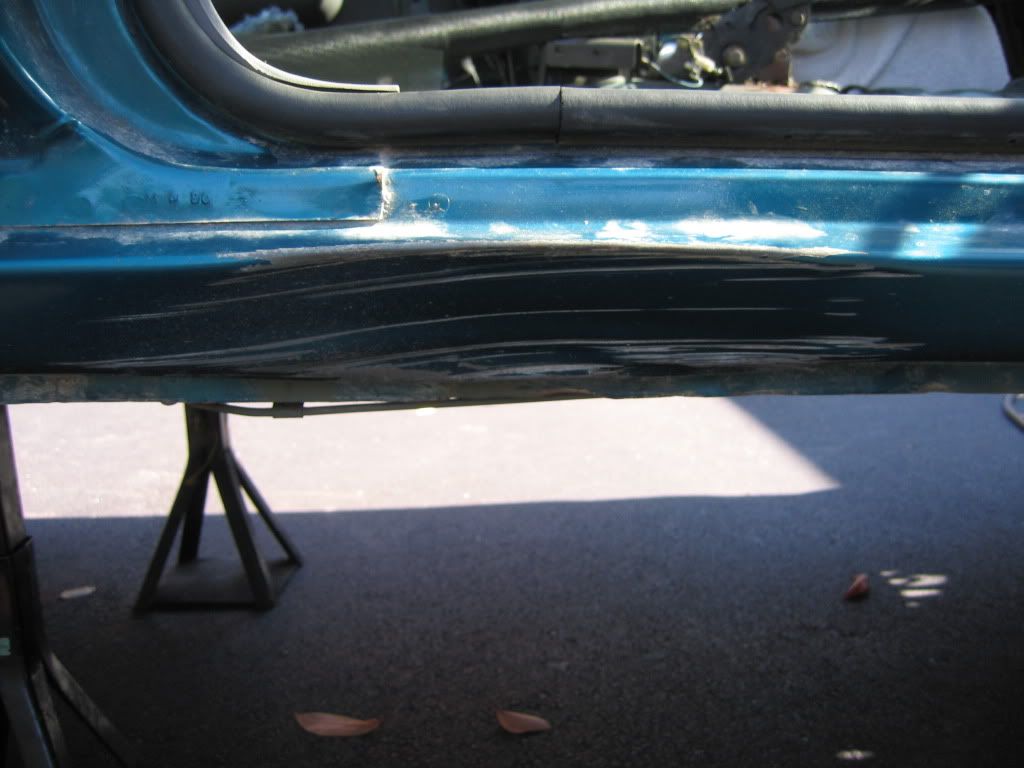

The next part we attempted to work on was the lower right side rocker. Because this will be covered by the side skirt, I decided to pull it out the best I could. If it was staying an LX, it would have to be cut out and replaced because it is badly creased in several areas.
Took off the paint
Ever seen the lawnmower man?
Pulling and hammering etc...
Best we could do with what we had, primered for now...

(From what year Ranger did that header came out off?)
five-0-92lx is offline
post #29 of 159 Old 10-23-2011, 08:26 PM Thread Starter
91TwighlightGT's Avatar
Location: St. Louis, MO
Posts: 2,059
Originally Posted by five-0-92lx View Post
Looking good man!!
I believe it was a 1994... I didn't pull it myself, I just called a Junkyard and told them I needed the one that had the O2 sensor bung in the header (I think 1996 and later O2's are on the downpipe).

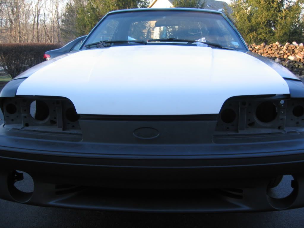

Finally, finally some updates! Although it's been slow to update, I have been pretty busy on the car. I managed to snag a pair of GT doors off of an 87 Mustang. I really only needed the passenger door, but...
1. They were sold as a pair.
2. I needed the GT molding for the driver's door anyway, and they both had good belt moldings, too.
The driver door was damaged more than the one that I have, so I decided to scrap that door.
We have been doing some more rust repair and cleanup in the hinge areas, but aren't quite done yet.
My Cervini's Cobra body kit arrived, which is good. I also managed to pickup a Fiberglass hatch on Craigslist. It was made by Design Concepts. While it seems fairly good, I am a little disappointed with the fitment along the quarter panel. The gap is a little bit wider than I would like, which is somewhat expected with Fiberglass, but my HO fibertrends hatch fit better.
However, I do like the fact that this hatch has a finished underside, which the HO one did not. Overall, though, I am satisfied with the hatch.

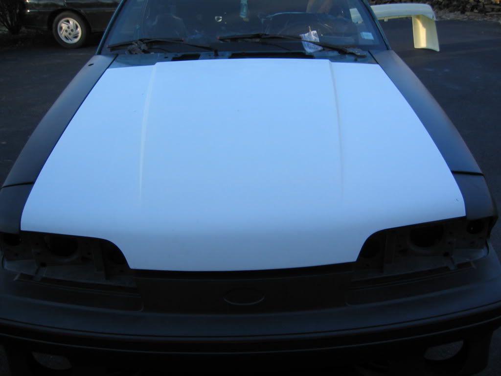

I also finally pulled the trigger and bought a new hood from HO fibertrends. This one is a stock style fiberglass hood, and so far the fitment is as much as I expected, which is pretty nice. I won't give it a perfect thumbs up yet because I haven't done any final fitment of the doors and fenders, so I will give it another comment once everything has been fitted and I am satisfied with the looks.
Unfortunately, I had to buy another set of fenders. Turns out that the ones I bought that were supposedly off of a 92 Mustang were actually 79-90 style fenders. I am kicking myself for not double checking them when I bought them, so let this be a lesson. Double check, don't just take it for granted that you are buying what you think you are. I tried for two months to find a decent set of 91-93 fenders, and struck out. So, these are Sort-fit fenders, but actually they seem decent right now, but again final fitment hasn't been done because the doors are still off of the car.

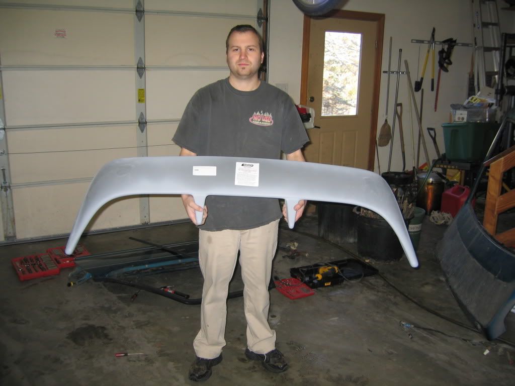

Last thing that you guys may find exciting... I weighted some of the stuff as I pulled it off. So, read on to find out what some stuff weighed!
Okay, okay, on to the pictures.
Here is the car with the old fenders and hood on it. Everything is loosely bolted on in this shot.
Here is the control weight of your author...
First up to be weighed, the stock steel hatch. All wiring has been removed at this point, as well as the glass, the latch, the lock cylinder, etc. It is just a bare steel hatch.
and the verdict is... a simple subtraction of my weight gives us a total weight of 43.4 lbs.
How does that compare to the Design Concepts Fiberglass hatch?
24.8 lbs! Or about 18.6 lbs lighter than stock.
Next up is the back glass.
A total of 19.6 lbs.!

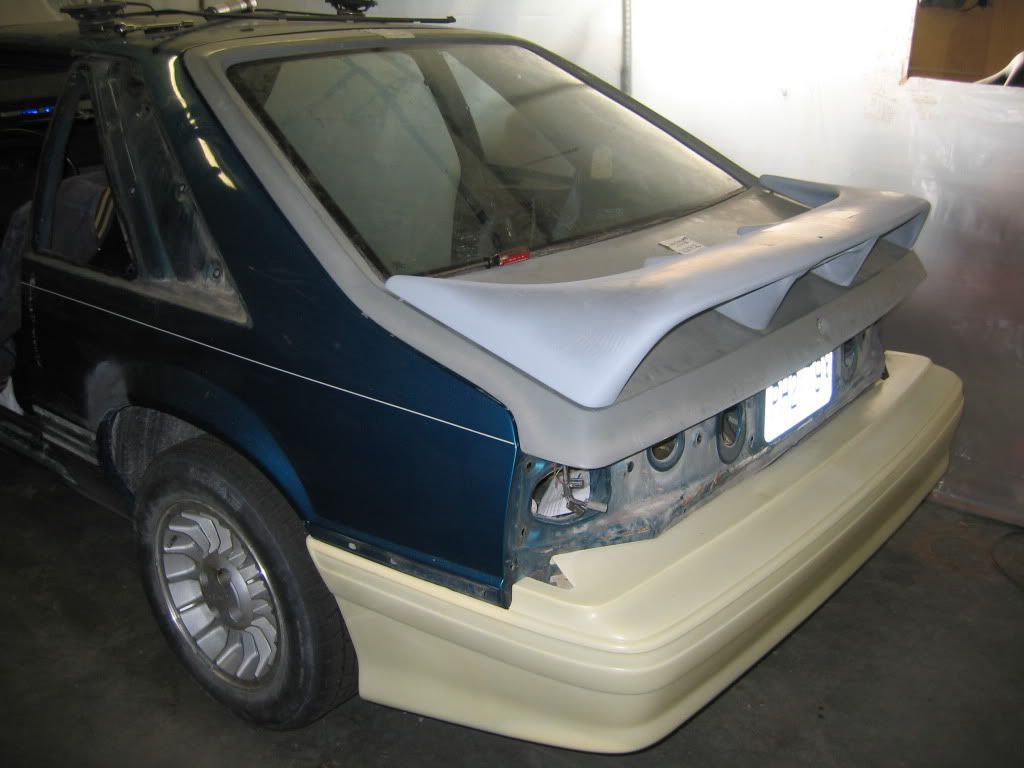

How about a Cervini's Cobra Wing?
10.4 lbs for the wing.

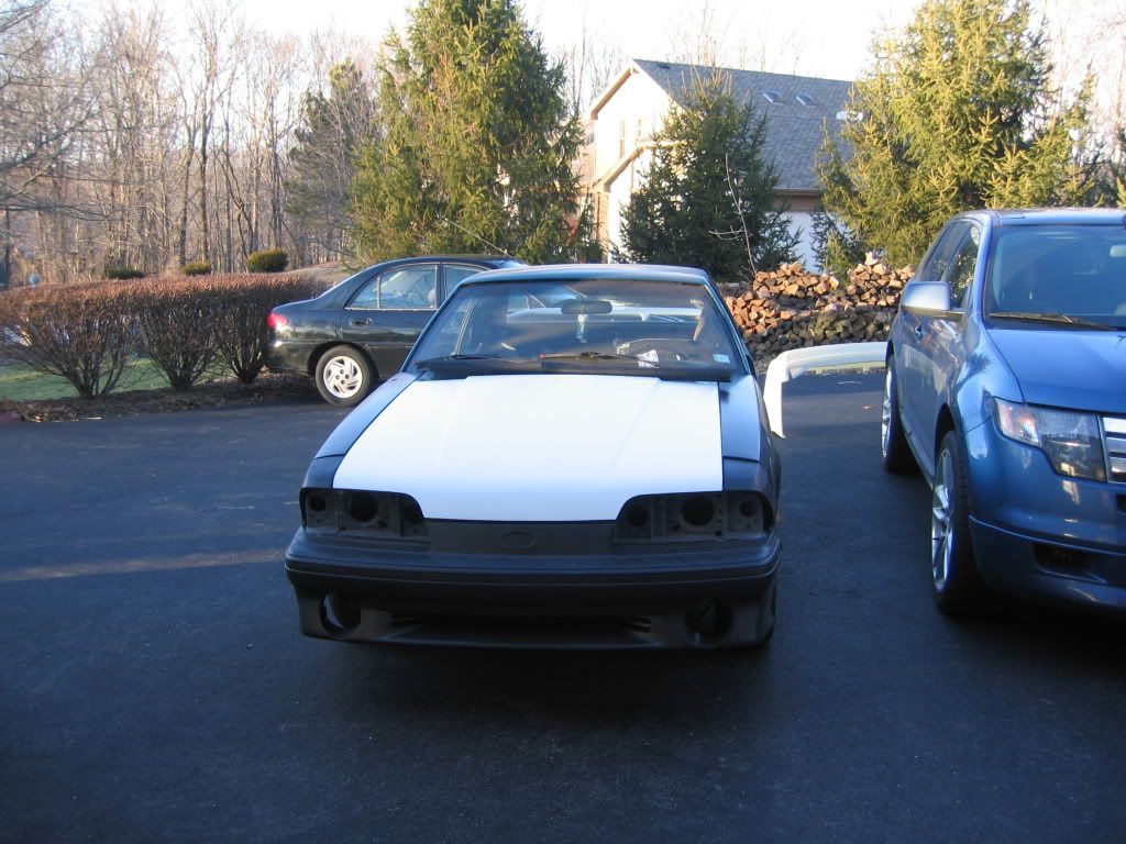

Okay, last thing I weighed was the Fiberglass stock hood. Since I just did this one today, here is the new control weight.
and the weight of the Hood is a total of 20 lbs.!
Some pictures of the hood installed. A reminder, final fitment has not been done, so don't judge fitment on these pics
The only downsides to the hood are the unfinished undersides, and the area where the latch hooks is not reinforced with metal like my Cervini's hood.
Here are some pictures of the hatch with installed Cobra Wing.
And with the Cobra rear bumper hanging loosely...
And finally, how the car is sitting right now...
Okay, that is it for now! Hope to keep the updates coming along a little quicker!
