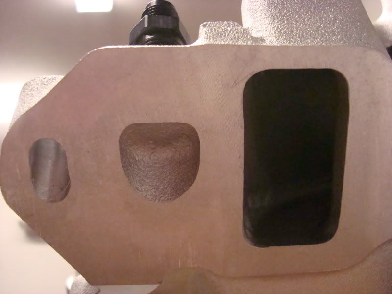

I went left and right just to even it out connecting the two water jackets. I am looking to see if I have a pic of just the fitting on the intake without the lines.

Having just the sensor up front screwing straight down into the manifold makes it a one time install and easy to service if you need to.

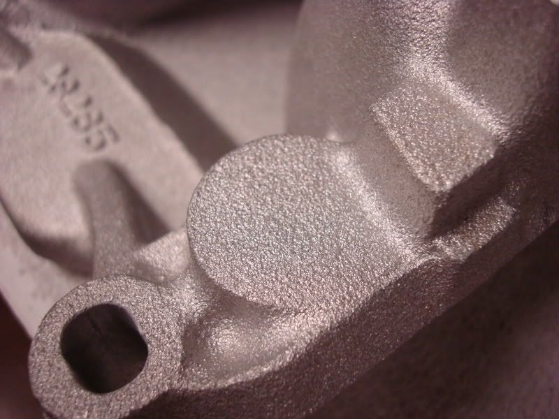

Here you can see the extra pad of material right over the jacket for just this purpose.
My first idea was to drill and tap for a fitting but I am much happier with the weld bungs
You can see the underneath of the manifold there is a guide for the water jacket casted into it.
Everything is the same on both sides.
