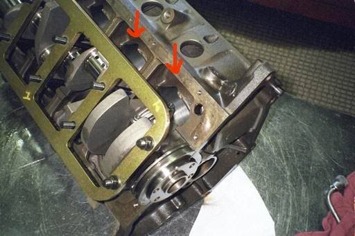

This picture might help. Its a 347, but you'll get the idea if you end up needing to grind a little.
