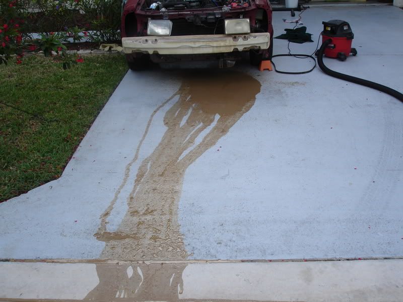

Here's a picture/video of what a bad radiator can cause:

Big Top, that's not a good sign. lol
