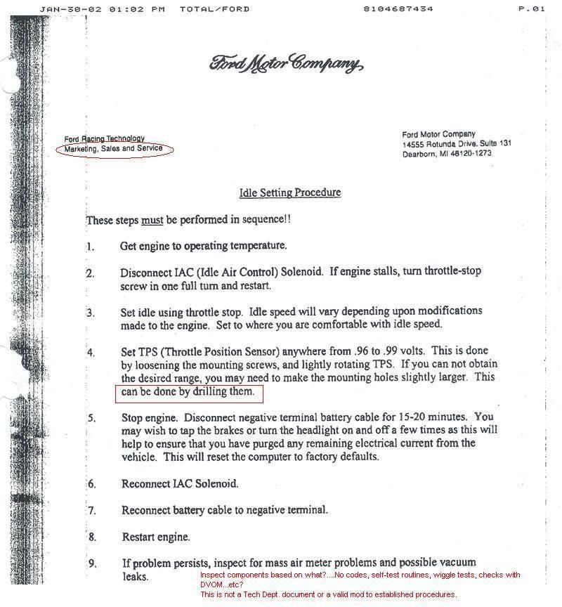

If your going to mess with the TPS, use the Ford procedure for dialing it in.

Jim.
Take a look at what you refer to as the "Ford TPS setting procedure", and most importantly its source.
1. No company (tech/engineering department) will specify a "company" procedure that requires their parts from being mutilated.
2. A change in the standard procedure will require a Technical Service Bulletin (TSB).....none exists with those instructions, so it's not official.
3. That set of instructions literally invalidate the ECM software engineering dept within Ford.
4. That page looks like the written "script" given to "Customer Service" noob employees......it's not an official document....why?
5. Check mass air meter based on ....no reference to ANY self-test or "Pinpoint Test DC" (Ford's test name for MAF related codes).....so it's not a valid one...even if it has FMC's banner on the header.
6. Now....the following is an extract of the 591 pages long OFFICIAL GUFB EEC-IV Strategy Book....
The variable RATCH is the output of a ratchet algorithm which continuously seeks the minimum throttle angle corresponding to a CLOSED THROTTLE position. This alleviates the necessity to set the throttle position sensor at an absolute position and compensates for system changes and differences between vehicles. The ratchet algorithm uses filtered throttle position for the determination of RATCH.
7. If you want to continue mutilating parts, and making unnecessary adjustments.....YCYDYP.....

Joel,
The "source" is Ford Racing Performance, because they sell parts they are under the "Marketing, Sales, and Service" group. You can call up the tech-line yourself and ask for them to fax you the document. (586) 468-1356

Originally Posted by JimBowy View Post
Joel,
when you read an official ford tech document, you will know it...this isn't one. read the GUFB doc if you want any real knowledge of the ford eec-iv. i can only assume the instructions on the document that you provided used the smaller range because it is well within the actual range that it should be in, to provide a safeguard. you've been around awhile i know, so why would you question anything that stangPlus2Birds or Joel5.0 have to say? they never offer advice that they are not positive is true. again, read the GUFB document and see the difference between the doc you provided and an internal ford tech doc that was meant for ford's own engineers
Joel,
I know....but it's wrong/bad information, mis-information. Again, no company (automotive or otherwise) will specify a procedure that requires their parts (or replacements) to be mutilated, and the reason is simple.....lawsuits for selling a faulty design....+ it goes against all the documented tech procedures, specifications and design characteristics of the system.
Think about it,..... Ford designed and installed a computer controlled system that requires such an absolute value for the TPS voltage?.....if this was true, their software and hardware engineers were less than mediocre and a carbureted system will definitely be more effective than EFI in dealing with normal system variance.....+ they would have been in non-compliance with the OBD-I requirements of the times.

JimBowy -
Joel, stangplus2birds, and i can explain why the TPS only needs to be between .49-1.2vdc. that is because the base (closed throttle) voltage is recorded upon each startup, and the ECM determines entrance into part throttle when the voltage rises a certain number of volts (rather than determining entrance based on a preset voltage) and also does the same for WOT (2.71vdc over the base tps voltage, again not a predetermined voltage, but 2.71vdc over the closed value recorded initially at startup). can you explain why it would need to be .96-.99vdc?
the point is we're not here to argue, we're here to find the truth. if you have some evidence, or at least a valid explanation for why you are right, please share it.

okay here is a scenerio for you... this is actually my situation with my custom setup and roots-style supercharger...
say you modify your car and to get the car to idle, you need to turn the idle set screw on your throttle body - by doing so you increase the initial TPS voltage until it is above the 1.1v
to get the car to idle, you need to get the voltage somewhere back between your 0.7-1.1v range. to do so you need to slot the TPS and bring it back within that range
now the Ford document states you want to hit .96-.99v, but I can appreciate being within 0.7-1.1v could work. isn't this a practical example of where the TPS must be slotted to get the car running?
- Jim
Yes it is, and a very valid one....but you might be masking a problem somewhere else. Provided the TB is the OEM, the idle issue may lie in the IAC, or a mechanical problem within the TB..... you may install a IAC Bypass Spacer...which is part of Ford TSB 91-25-7 to deal with the rolling idle condition due to TB/IAC sludge deposits, to compensate for your setup.
Quick Summary:
You never have to adjust a Ford TPS unit on a Ford TB (that has the idle set to spec)- NEVER!!
For people that adjust their idle higher than spec to keep their engine running with their setup, or people that use a NON-Ford TPS,
then they may have to adapt the TPS unit (by making slots) so that it reads from ~0.6v to ~1.1v at idle.
From http://www.veryuseful.com/mustang/te...g-TPS-FAQ.html which I definitely recommend you check.
Keep in mind, if an aftermarket TB is used, the TPS may then, have to be modified/changed....not to set it to the mythical .9999vdc setting, but to make sure it's within the .5 - 1.1 vdc system required range.
