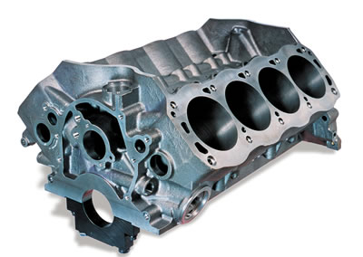

Block / crank / pistons / rods / rings / bearings / cleaning up = 2,500
Funny to do all of that when the block that should house a 800-900hp motor cost that much.
http://store.summitracing.com/defaul....asp&x=50&y=17
