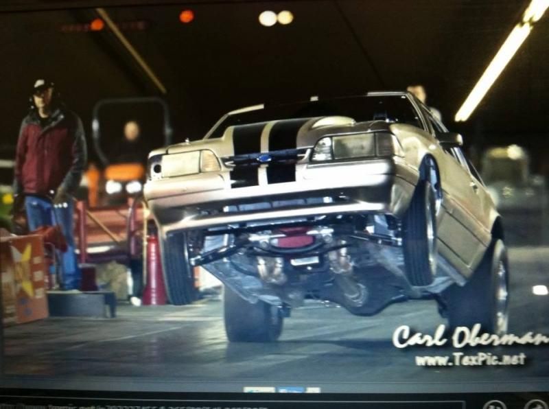

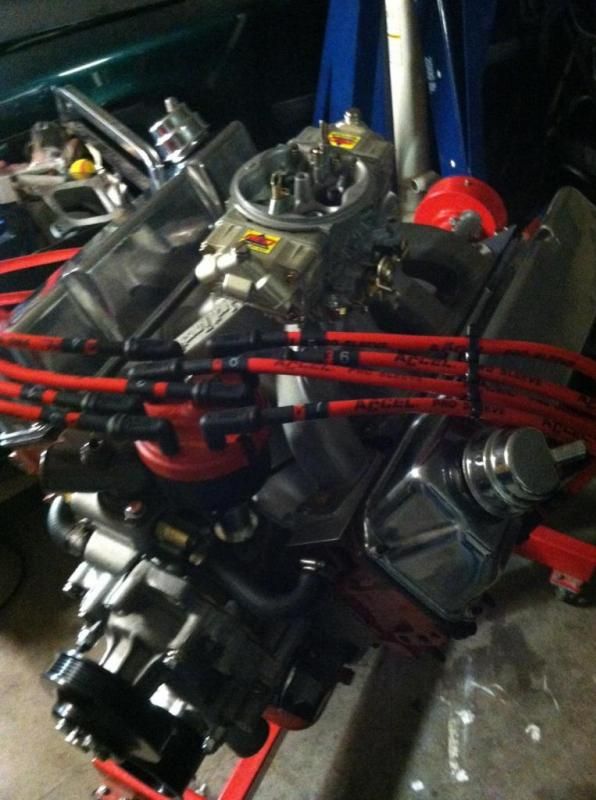

you will have to drill the deck of the block and block off a water passage in the head. ideally you drill the front and back of each head and run the TFS water neck kit. that helped to keep cool a lot on my buddies clevor. https://www.trickflow.com/parts/tfs-51600600
it ran 6.30s in the 1/8th on motor.

6.30 et is impressive for an all motor setup. Any idea on the specs of the build? I am looking into Windsor heads but am still very intrigued by the clevor. Cleveland heads of all kinds are readily available in the immediate area for reasonable prices.

it was an 81 block, an eagle 4340 crank 4.0 stroke i bought used for $300 off of ebay that i traded him for. it had 2.1" rod journals, he had some GRPs he picked up cheap, but they were 2.0 journals so the crank got cut. the pistons were used, the 4v cleveland closed chambers he had $400 bucks in, some howards solid roller lifters and a howards solid roller. i think it was 266/274 around .670 lift. 11:1 compression. it went 108mph like that. it had some comp ultra pro mags and some 730lb PSI springs that i had laying around. then we swapped a straub solid roller in it and it went 111 mph. the intake came off ebay for around $100. had to make the valley pan, the carb was an aed 1000. the headers were a 1.875 - 3.5" collector that was used for $100 or something. a used hamburgers pan. he had $4500 in it carb to pan, but other than machine work everything was done in the garage and had a lot of time in it. c4, 5800 rpm ati converter, transbrake, mt 3055s slicks, 3000lbs, it had some gear in it. he was shifting at 7500 with the howards cam and 8k with the straub cam. the straub cam had quite a bit more exhaust duration. with 7/16" pushrods no guideplates were needed.
this is the place i would talk to about headers for one unless you can find some used junk you can make work. it wasnt a cookie cutter deal but it ran 1.30 60's on motor. he sold the car about a year ago.

Clevors
lowfiveo,
I have several Clevors for sale. Pick your cubic inch; 302, 356 or 377. I plan on posting videos of the 302 and 356 running on my engine stand tomorrow. If anyone is interested, I can give details of what is in each one.
