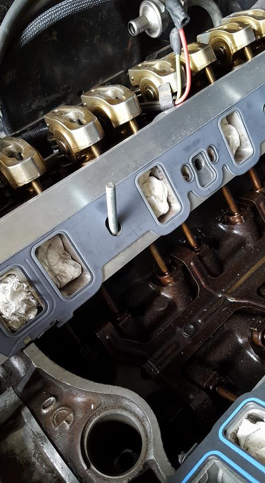

Well, it is finally time. I don't know I'm so nervous to do this. It's been years since I've done intake gaskets./
Felpro 1250S3 or Felpro 90361 with Trickflow 170 and ported Cobra lower. They both fit well. I like the steel core on the 90361 and it has the EGR passage exposed but the 1250S does not.

If the 90631 gasket is even with the bottom of your head ports, I'd use it over the 1250S3, just a personal preference for what I believe to be a superior gasket.
I'm struggling with the decision to use RTV around the water jackets. Would you use with this gasket?

If you use RTV at all, make it a THIN coat and only on the water ports....
Here again we can see what some do in this process differs from what others do. I smear a THIN coating of orange high temperature silicone on BOTH sides of the gaskets. I learned this from an engine builder/racer. I said no way but he insisted I try it next time. I had my intakes off a month ago adding roller rockers and gave it a shot. I can at least say it didn't leak after letting it sit a day. It also didn't leak after my dyno tune last Friday. The only "drawback" I can foresee is cleaning it off when you remove the intakes down the road. To the OP, either method will work but having all surfaces fully prepped and cleaned are the true key.
Again--to each their own.

Yeah I was thinking a really think smear on the head side only around the water port. I've read that the RTV will harden and cause issues so I was also tempted to use NO RTV
1994 Cobra #2586 with 76K

No rtv. It will cause the gasket around the port to distort and you will end up with a problem. Been there done that.
paper gaskets - definitely, but not that FelPro MS 93334 kit gasket 90631

Just horror stories on 1250. The 93334 is indestructible.

I've always put a very thin coat on just the non-printoseal side of the 1250 gasket around the water ports. They distort a little, but not enough to cause a problem.

I went ahead and did it finally. I put 6 studs in the heads, cleaned the crap out of all of it. Put a very think layer of Ultra Black around the water ports, put a fat bead along the walls and small blob in the corners, put the gaskets on, another blob in the corners and let it sit for a few min. My helper and I lowered the intake down slowly onto the studs. The Ultra Black squished out and I loosely installed the bolts so the head was barely touching the intake. Let it sit for an hour (per the Ultra Black instructions) then went around and did a quarter turn in sequence 5 times. I grabbed the Torque wrench and did 10# in sequence then 16 then 20.5 pounds.
Hopefully this was the correct way to do it.

Putting a thick layer of ultra black around the water ports is going to squish out and block the water ports and cause cooling issues.
