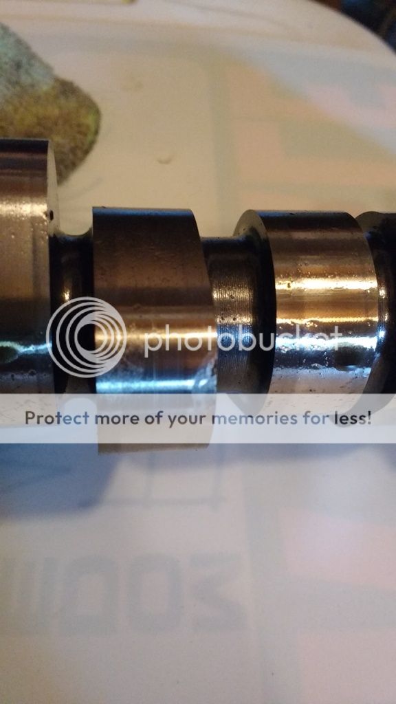

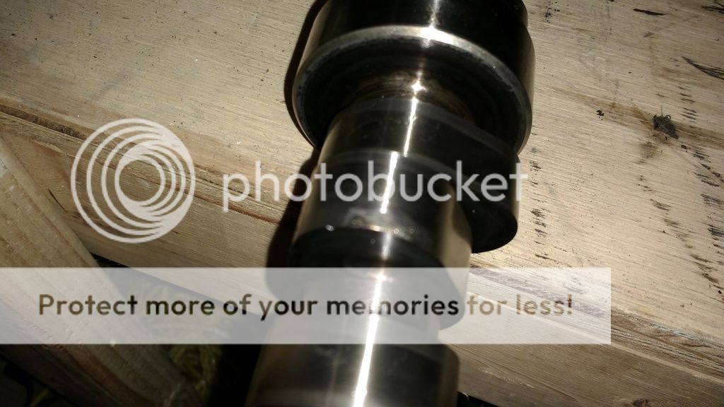

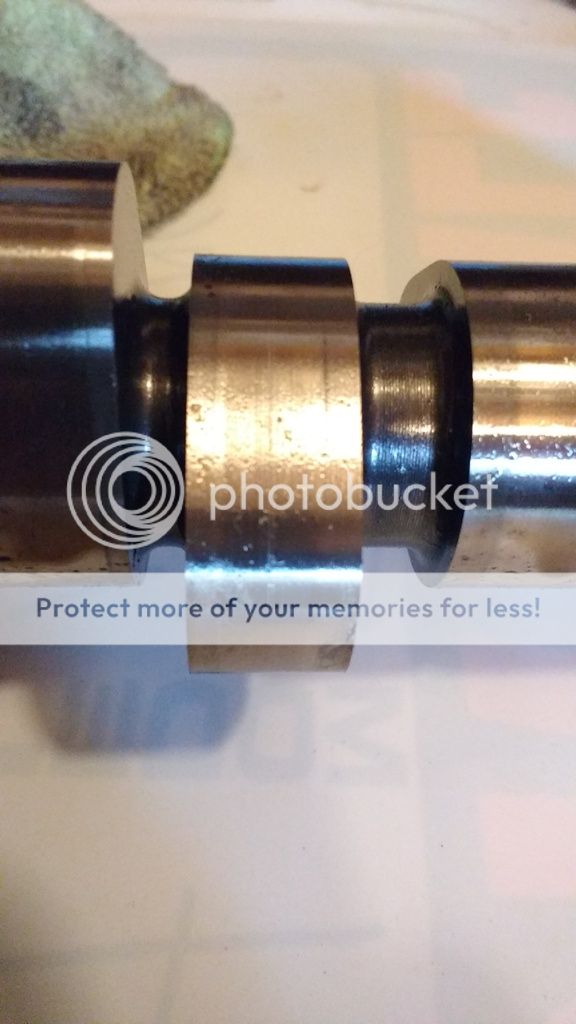

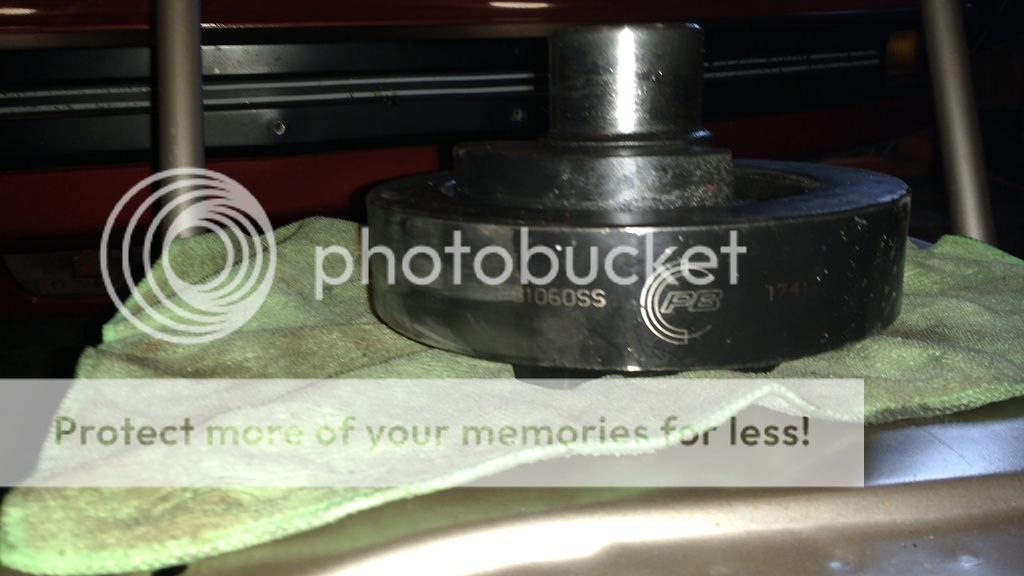

This is my cam from my 347. It took a little nick on the side of a lobe, and has some discoloration around the spot. It doesn't look like it's in the lobe where the lifter was rolling. I'm wondering if it's still usable.

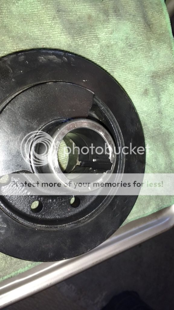

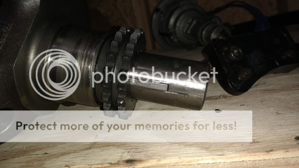

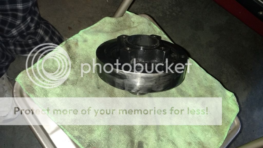

Also the balancer from the same motor, it looks like there was a chip that came off the crank? I don't know but it pulled off hard and you can see the scarring down the snout and you can feel some roughness in the balancer.. Plus it hit something on the outside but it still feels the same texture as the rest, so I'm pretty sure that's just cosmetic.

It looks like you've been running it that way for a long time. The cam is probably fine. The keyway on the Damper however looks worn and elongated.
What was the reason for the teardown?

Nope, it was a kinda happen all at once damage. LOL... Had about 3500 miles on the build a Fordstrokers Liberator with 11r 190 heads. Just to much power for the stock block.
The keyway is weird it's kinda stepped like that. But if you look at it you can see on the one side it has a rough spot that coincides with the scratch on the nose of the crank.

HOLY CRAP LOOK AT THAT BLOCK CAN YOU SAY R302!!!!!!!!!!!!! I would reuse the cam no problem but the balancer would have to go.To be honest with you i would not buy a cheap junk balancer from the start.
Are you saying that this one was?

JB weld? Seriously though, I think I'd ask the cam company or maybe Ed Curtis. On another forum I hang out on, one of the guys I'm friendly with has a 66 Mustang that he road races. His last 289 broke the same way. On his new motor he went internally balanced. He believes the unbalance weight on the balancer causes the problem with the constant acceleration and deacceleration but too much stress on the nose of the crank. His new 289 with 289 cast iron heads with a wonky distributor made 435 HP. He did go to an aftermarket block, I think a World Products.

I only believe in ATI balancer's.I think all others are inferior.
