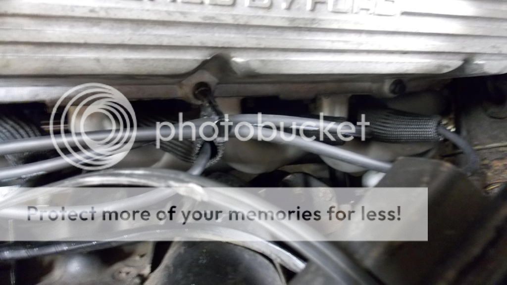

post #9 of 32 Old 03-14-2017, 10:27 AM
Join Date: Jun 2016
Posts: 122
What I did on my 66. I was trying to keep kind of a factory look. Not a restoration but something that looked like it came from Ford. You see I have 85 Mustang covers. I had to use 3/8" gaskets to clear the roller rockers. I bought longer ARP style bolts, integral washer bolts, welded 1/8" rod to the head and used factory loom holders that slip on the 1/8" rod from the junk yard. I didn't take too many pictures of them though. That's a GT40P

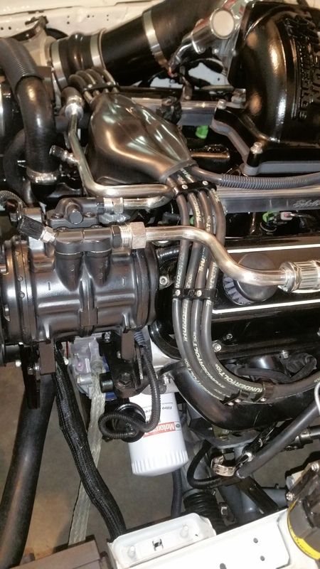

Posts: 11
made for you, 5075611
MecGen and Huskinhano1 like this.
Mighty fine looking motor! Funny I just got a 7 blade thermstatic fan for mine too. I like those wire separator. What's it going in?
Huskinhano1 is offline

This is how mine is setup. The locations on the cap aren't set in 100%, they are just plugged in to remember location. Never had an issue with cross fire induction this way with the routing.

TomR's Avatar
Join Date: Aug 2009
Location: Macon, GA
Posts: 4,641
Originally Posted by Daves8950LX View Post
The metal separators have the wires bolted to a plastic separator. Nothing different than your wires touching the valve covers or any other piece of metal in the engnine bay. I'll take a pic of mine once I get them back together on Saturday.
Great. I was under the impression it was a metal holder from wire to wire, which is a terrible idea and has nothing to do with the "wrong type of wire". LOL
89 LX. 363, single turbo S482 FMW, Super Vic EFI, Fox Lake Stage III heads, solid roller, glide. Holley HP EFI. (combo varies)

I'm using the Taylor wire separators:
MecGen likes this.
