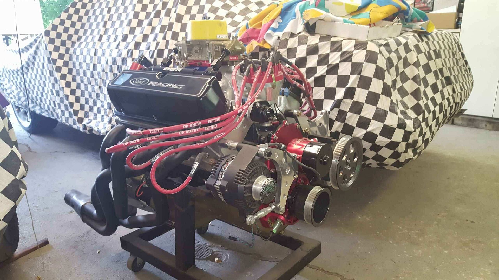

Almost done.

Originally Posted by autopart101 View Post
Almost done.
Looking good! Now get on those rollers and get some numbers!!!

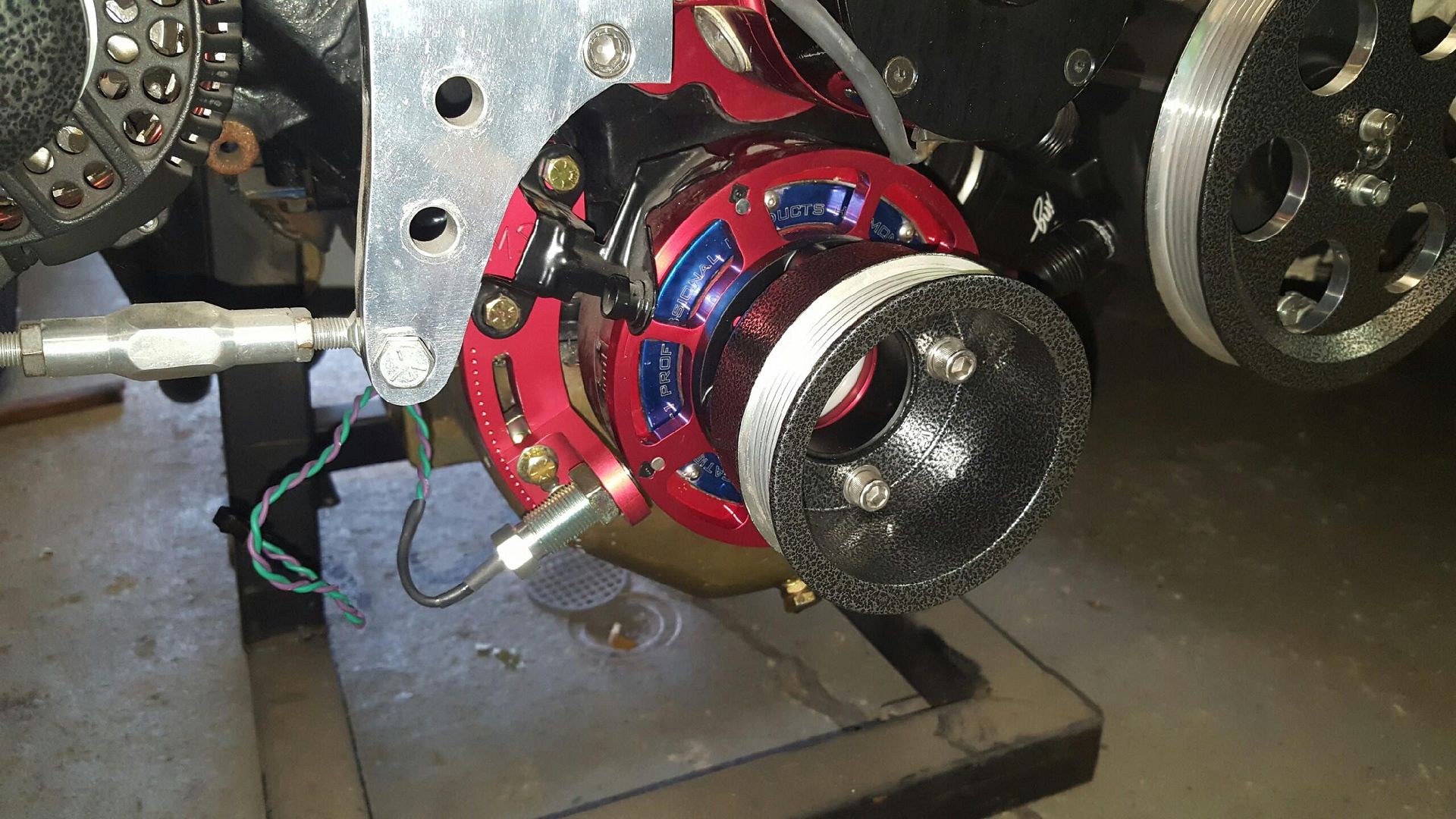

93 LX.

My super Vic is well ported and it's made a big difference!! Car not tuned yet and running with a 80 mass air. At WOT car turns the tires and skates in 1st 2nd 3rd. 1st is almost useless. From a 2ND gear take off at 3500 slams you in seat and keeps pulling hard. Makes power up high. Also new intake liked more timing than the TFS LR.
autopart101 is offline
post #35 of 67 Old 03-11-2017, 12:03 PM
Join Date: Jun 2016
Posts: 5
I noticed you're running a spacer under your elbow. Was that to clear the rails, or the throttle linkage?
