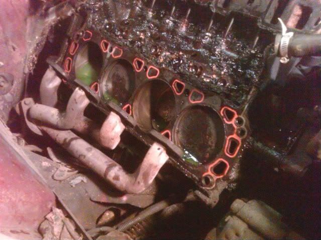

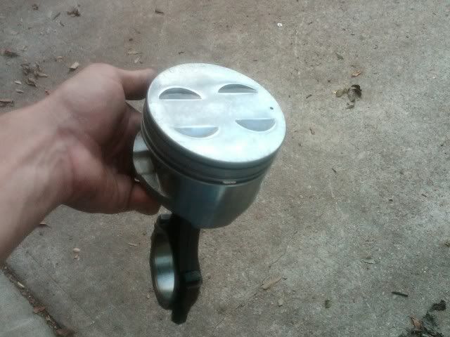

My buddy just tore down an 86 GT, it had flat-top pistons with valve reliefs. I've seen flat-tops with and without the reliefs, just wondering myself. Is it a "true" flat-top without reliefs for the 86? Here is a pic of his 86 motor...
I promise those are not the stock pistons for an 86gt in that motor. Those look like stock rebuild replacement pistons.
That's what I told him, but they are flat-tops...just have reliefs. I actually had a motor from an 84 lincoln, it had those same pistons...but it wasn't a roller motor. I did a search on the web looking for pics of the 86 flat-tops...turned up nothing.

Originally Posted by 90 Crustang LX View Post
86 ho pistons are flat, just flat, no valve reliefs, no dome, just flat. those are probably replacement cast pistons.
Uhmmmmm, does that mean they're flat? LOL. I was just saying those (in the pic) came out of an 86 GT two weeks ago, I couldn't find any pics of an actual 86 piston, can you? I've heard they are flat, just can't find solid evidence.
Haha well just use your imagination and imagine those pistons without the valve reliefs, that would be what the factory 86 gt pistons would look like. The pictured pistons are not original to the car. I have some pics of an open 86 motor somewhere, I'll dig for em.
edit: eh i cant find pics of the top of the pistons, just the undersides and the cylinders without pistons

i know this is an old post but i am going to put up pics of pistons from an 86 gt that i personally tore down and then pics of the pistons that i believe are in that 86 that dy85merc's buddy had.
Factory FlatTops
96 Explorer Pistons
