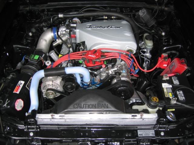

347 stroker. Idle goes up and down and then stalls.( vids on pg2)
i run 42 pound injectors and a pmas maf caibrated for them. On cold starts the car will start up just fine and briefly come down to idle at around 900rpm and runs great. The problem is, soon as the car is heated up to operating temp and if you shut the car off and then start it again, the car will start up as normal and then the rpms will go up and down between 1500 rpm down to below 800 rpm and will stall out shortly after. Sounds like the IAC is trying to compensate so the car wont stall out but eventually it does. If i feather the throttle for about 30 secs to counter the stalling out, it will finally find its sweet spot and hold a steady 900rpm. The tuner was having this problem on wednesday. we were trying to nail this problem for an hour and a half. He finally just bumped the idle speed with the chip up to 850 and we got the car to start up like normal and stay running like normal. But, unfortunatley, after the car warms up and then you shut it down and restart it starts this BS again. Every sensor and everything under the hood is brand new and the base idle reset procedure has been done. New vac hoses and no vac leaks. Tps is good too. Any suggesttions? the computer is a a3m. The chip the tuner uses is a sniper chip. Next step is to sell this thing becuase i spent 4 hours this morning trying to get this thing to start normal. Im sick from sniffing exhaust fumes
