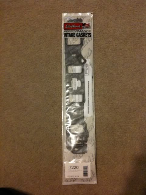

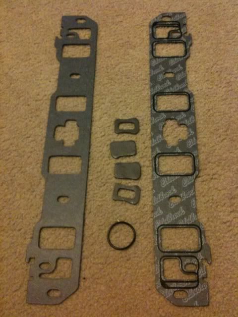

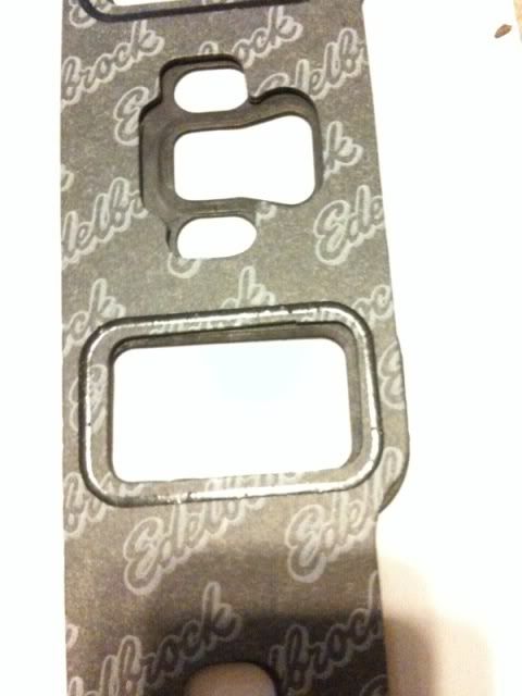

This is a really good post with some good pics so I figured I would add some info to it. In another post someone said that the Edelbrock intake gaskets are steel core because the Summit page said they were. I was ordering some stuff so I figured I would a set just to see. They are junk, no steel core.
Compared to the 90361 gasket:
