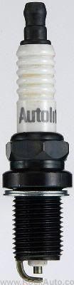

Originally Posted by 95StangRC View Post
Explain.
i'll start with the gap .52 vs. 0.52, thats a big difference.
ford gt40 iron, p, y and x use a non washered/tapered (or whatever it is) and the 3924 is washered.
does that explain it better for you?

3924
[IMG][/IMG]
104
[IMG][/IMG]

Originally Posted by rob View Post
autolite 104 or 764
3924 is incorrect.
.052
The GT40 X head accepts a tappered or gasketed plug. The 3924 plug is a warmer plug(heat range), equal to a 42 series(agsf-42c, stock 5.0 plug) motorcraft plug I believe. Autolite produces Motorcrafts plugs. 3924=42series, 3923=32, 3922=22. Autolite also produces a racing plug(AR series) in the AR 3924, AR 3923, AR 3911, and AR 3910. NA application I would run a AR 3923, in a boosted application go with the AR 3911 or AR 3910(the 3911 is 3 heat ranges colder then the 3924). I run the AR 3911 in my car(Vortech 351).
After talking to a Autolite rep for awhile I was told to run as cold a plug as possible(esspecially in a blown application). If you go to cold, the motor can load up while idling, thats why I went with the 3911 over the 3910(not a hint of loading up).
The AR plugs have a thicker electrode and body(heat transfer), and the colder plug helps pull heat out of the chamber as well. You can also bring down the gap, most AR plugs are factory gapped at .025 to .035. The tighter gap helps prevent a blower or turbo from blowing out the spark. Summit sells most of the AR plugs, there under $4 a plug.
