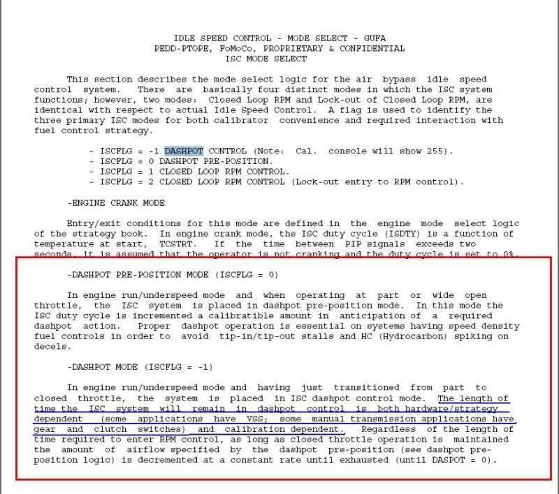

With the spout in and the IAC wire plugged in like factory stock, the idle speed hangs up when I blip the throttle in neutral in the driveway. It hangs at about 1300 then drops to 1000, hangs for a couple more seconds then finally slowly drops to about 850rpm. I got under the hood with the timing light and I could see the timing was up to about 17° at 1300rpm and then 15° at 1000rpm and then finally back down to about 12°-13° at an 850rpm idle.
I then unplugged the spout and kept the IAC wire plugged in like factory stock. When I blipped the throttle, the idle no longer hung up at 1300 or 1000rpm. It came down immediately when my foot came off the gas pedal. As expected, timing stayed right at 10° BTDC during all rpms.
What have I learned from all of this? It looks like its the TIMING that is causing the idle rpm problem!!!!!!!!!
Perhaps its time to think about defeating the dashpot function as described by Joel5.0 in post #72 ??????
do you really want to bypass the dashpot function?..... simple..... install a jumper to the white clutch pedal switch (force a permanent in-neutral condition to the ECM) + disconnect the VSS sensor (cause a code 29 failure)....

....With your situation, what you are describing with the hanging really doesn't seem all that unusual, actually. I believe there needs to be some, or as the poster above wrote you may encounter stalling.
Scott
Thanks for the replies, guys. Just to reiterate since this thread is long running. I've owned the car since it was brand new and it never had this hanging idle speed issue until early last fall. It went away and then some time later, I got a huge vacuum leak. I fixed the vacuum leak but then the hanging idle speed issue came back.

wihtout dashpot you will stall everytime you de-clutch on decel.

Yes,,,,,,the dashpot is there to allow for slow engine rpm decrease upon closed throttle.
I am starting to think that you have a crack.....block, head or intake.....
there is no way for it to idle at 850 rpm without the IAC let alone with the IAC.

Dashpot function = IAC control function
IAC disconnected = dashpot function disabled
IAC disconnected = IAC "A/C idle up" function disabled
Bottom line.........
Originally Posted by dannyUAL91GT View Post
When I'm coming up to a stop sign, when I step on the clutch, the RPM will actually go up by about 200 RPM! After about 2 secs, it will drop to about 1100 and stay there until I come to a complete stop. Once I'm stopped, the idle will slow down to 900 and then finally to 750-800 RPM.
Is normal EEC controlled dashpot control "behavior".

The reason that I first started this thread was because of this:
Its really chapping me off when I pull my foot off the gas and depress the clutch pedal to see the tach jump up 200 RPM .
With the IAC wire plugged in, this is what the engine does. It didn't do this before last fall.
The engine idle speed is about 850rpm with the IAC wire plugged in. If I unplug the IAC wire, idle rpm will be in the 650-700rpm range when fully warmed up.

Joel, you're saying that the jump in rpm is normal behavior? Perhaps it is but I've owned this car since new and I don't recall seeing that rise in rpm until last fall. I'll admit that I don't have a good memory but I'm certain it didn't do that before.
I did quite a bit of testing yesterday and I posted what I saw in post #78. Specifically this:

1. You have a system with failure codes that will cause it to go into FMEM (Failure Mode Effects Management) status.
2. Is code 34 caused by a faulty EVP sensor, or an EGR valve that is not sealing 100% in its closed position?...... if the latter is the cause, fuel mileage will go down the drain.
3. Lean codes present will cause the EEC to increase fuel trim correction constantly, another cause for fuel mileage to go snafu. Those are the failure codes or conditions that really need attention and solution in your case.
4. The input from the VSS is one of the key triggers for the dashpot function, any value above 6 MPH from the sensor = dashpot turned on, causing the EEC to use a fixed higher ISC duty cycle or preposition...... so are the inputs from the transmission gear switch and the clutch pedal switch. I have confirmed this to be correct many times on the field.
5. I know about the limitations of the internet, but when you encounter two cases (the dashpot function is also standard in OBD-II systems BTW) years ago, one in which a customer decided to spend >$400 trying to "solve" what is pre-programmed in the system, even after learning about it and demonstrated by causing a P1039 failure code + having access at the specific details of that part of the GUFx EEC logic..... ... I allowed him to exercise his right to pay and confirm it was true....... BTSTDTRT many times.
Bottom line.... you are trying to establish a relation between the dashpot function and fuel consumption however, the other failure codes (34, 41 & 91) are the ones that need attention. Why does MPG don't go that low when the ISC is disconnected?..... fuel trim under FMEM mode will not increase if RPM control is fixed.... IOW, you are providing the EEC a crutch to affect its fuel trim correction by causing another failure = lack of RPM control..... while allowing the real culprits of the problem to exist unattended.
Just a thought

Partially or completely clogged crossover tube section will cause either side to read lean in a KOER.
Thermactor codes 44 and 94 are KOER exclusive codes. IOW, they are not memorized or logged into memory. They are only used for the real-time test the EEC does of the thermactor plumbing using the O2's as the indicators.
Idle control when shifting....... anytime the EEC sees it's over 6 MPH via the VSS, no failure code 67 is logged (IOW... it sees the system changing from "in-gear to in-neutral" condition and from part-throttle to closed-throttle), the EEC will open the IAC to a pre-programmed value called "dashpot pre-position". Reason why while shifting above 6 MPH, you will notice the idle higher than the target idle value when the vehicle is stationary.
Summarizing...... the condition described as "hanging idle speed" or "surge" while shifting, is a dashpot subroutine that is part of the EEC logic and is normal. In layman terms...... there is nothing to correct or fix -OR- there would be something to correct/fix if it didn't happen.

Originally Posted by copracr View Post
I've read some reputable articles that agree with you. I'm not saying this is exactly the issue, but something is and it would be nice to find it.
So have I, but the one that stands above any article, is the actual GUFB strategy book from Ford. For example......
And I was able to verify the above via field tests and repairs since 1994. BTW.... did you know that same dashpot function is also part of the OBD-II strategies. IOW.... if failure codes 67 and/or 29 are not present in the system the "hanging idle" while shifting..... is normal EEC operation, there is no problem to fix.
