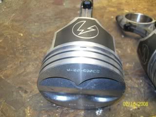

I just rebuilt mine with the Summit speed pro kit. It is very high quality. First off when you compare the pistons you will be amazed. The casting is thicker, the valve reliefs are way bigger and it used wider ringers for added sealing power. You can run 2.02 valves no prob and I would run a bigger cam then the tf1. I running a comp 276 with 544 lift not even close on my ptv clearnace

heres a pic of one thought I had a side by side comparison but cant find it
