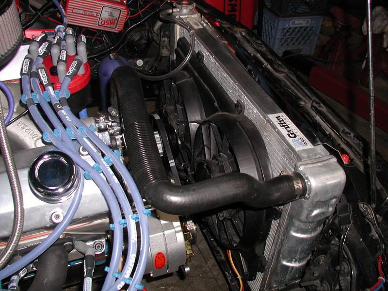

Last fall I started a 351C swap into a 4cyl 93 Fox body coupe. Recently I just got laid-off but want to finish the project. So I need to be budget conscious and smart about what I buy. I have no immediate plans to take it to the strip. Just a car to cruise around town for now.
I need recommendations for the following:
1. Cooling (radiator [purchased] & electric fan) <--Tater1 answered

For a cooling combo set-up this has worked for a few years for me with no issues in a Fox stang. I've used this set-up with a couple Cleveland's and a stroker Windsor driving on the street or running high 9's at the track. I used a Griffin "universal" style radiator 31" x 19" with Ford outlets. The fans are off a 2001 Ford Focus car and will move a Ton of air. I wired the fans up individually and in the summer cruising time I usually only have to run one of them. I used the stock lower mounting tabs and used an upper plate from UPR. Pretty low dollar set-up.

I got #1 checked off the list.

I'm resurrecting my thread. It's been a long couple of months. Got laid off, found a new job, move across the state and now finally getting settled.
I've been gathering parts still since my last update. I bought a FMS Alum driveshaft and misc acc like waterpump, gaskets etc.
Next purchase is intake and carb. I currently have the factory Edelbrock F351 intake and 650cfm carb that came with the motor.
Any suggestions or opinions on intake & carb setup? I might as well address ignition setup too. Think budget minded

Glad you found work again mate.
If you stick with factory heads, the manifold has to match it. It might be obvious to some, but 4V heads can't be used with 2V manifolds, and vice-versa.
Also, most CHI "3V" heads need their own special CHI manifolds (higher ports). A few can use the standard manifold though, so you must specify what setup you want.
650 Holley sounds about right. Any bigger and it would be a pig to drive. mechanical or vacuum secondaries?
One concern: Not sure of US laws, but in Australia you can't retrofit an older engine into a newer body, in regards to emissions compliance. As all Fox Mustangs from '86 onwards were EFI, is it still possible to fit an old carby-fed engine into a later model.... Assuming it's to be driven on the road?
